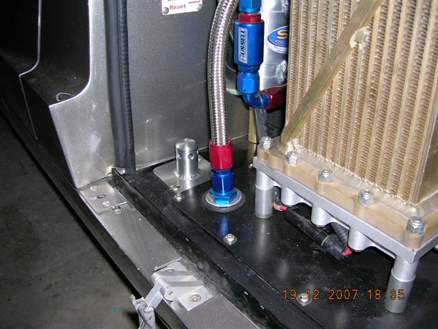

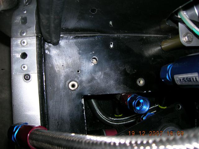

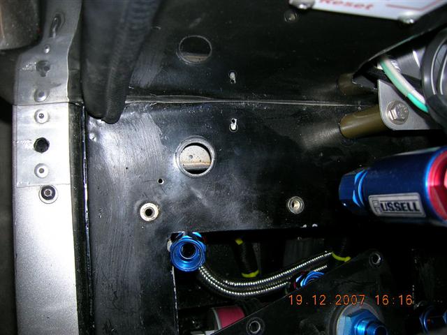

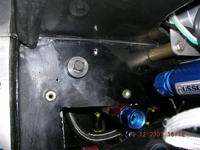

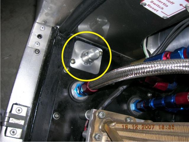

At the rear bulkhead area study where to locate the vents detailed below. There are reinforcement panels and such to look out for. The point is that you don't want to interfere or drill into anything especially the fuel tank that is in the way.
This may a good time to note that all you really have to do is drill a vent hole back here and be done but these aluminum vents look cool.
Drill a hole of sufficient size to use a chassis punch to make a big hole. I used a 7/8 inch punch.

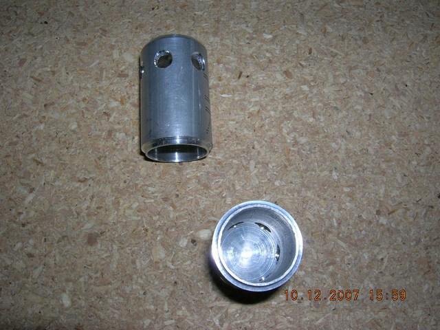

Next, I made the vent stack from a piece of 1 inch dia aluminum rod by drilling a ¾ inch hole up the center on a lathe and then turned a 7/8ths collar on the open end. Then using a V-Block, I drilled six holes around the top as shown below.

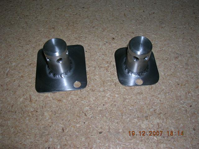

Now, fab up mounting plates as required to weld to the vent stack.

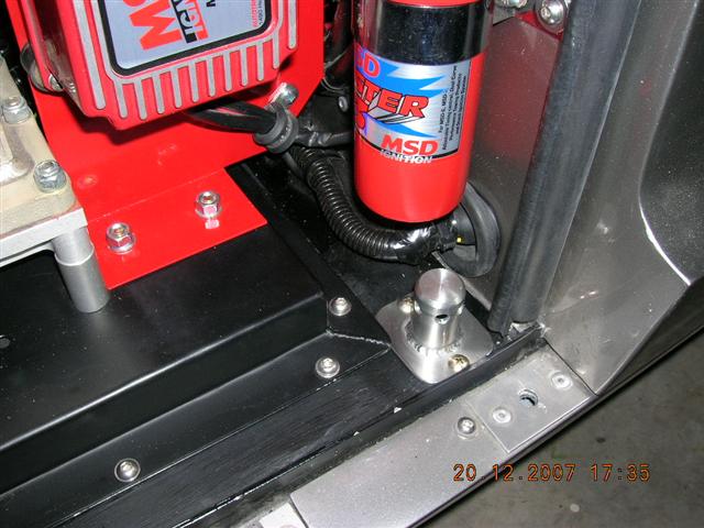

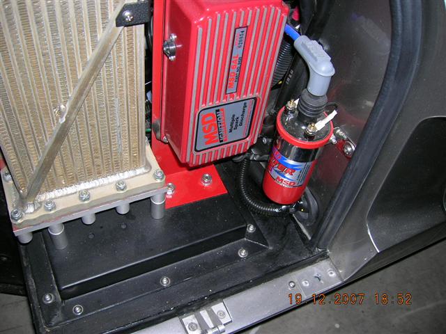

Weld them up, use a Scotch Brite pad to clean them up and powder coat them clear.
Install them using sheet metal screws and you are done. This is not a 100% cure all but it helps a great deal.
