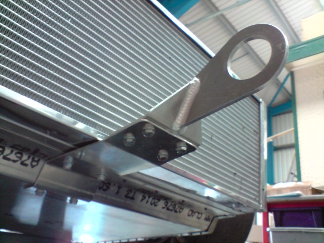

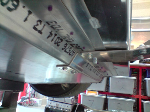

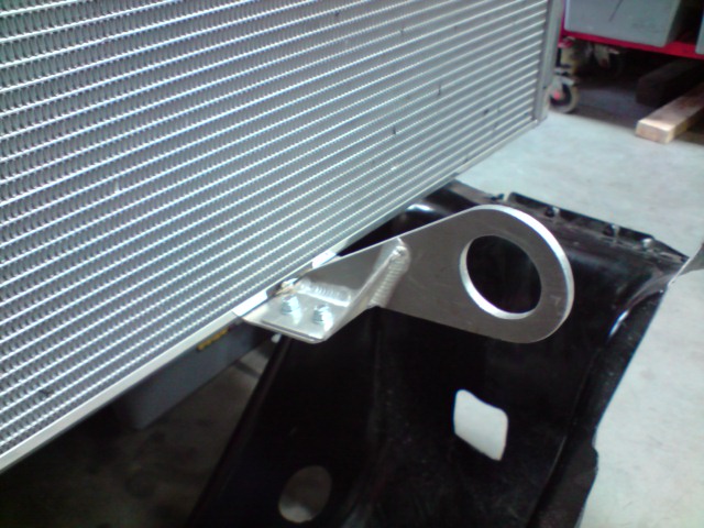

Here are a couple of pics of the eye we use. It bolts up through the bottom of the nose box just behind the rad. Sits just inside the nose opening and is almost unseen, and strong enough to winch the car into the trailer by.
Darren

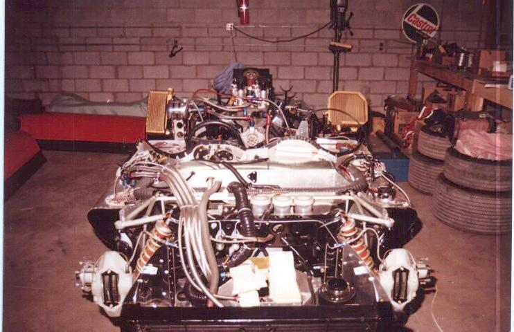

Nice work Darren. Did you notice the old fans from a fridge that we had to work around ? I like your system better...
Thanks Johan. The early cars certainly throw up a few probs. The 3b's are a piece of cake by comparison, just build a centre splitter into the nose box. Yes, I noticed the fans. Are they original or a throw over to when it had the coupe body on the road?

they are rheostatically controlled with a "frigidaire" knob thingy and they are from the late 1970s when AC was installed. They are not visible in this picture, as they are on the other side of the radiator. I plan to move them back to that location or remove them for racing. they are not needed on a track, but are handy in traffic or the pits...
