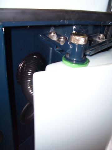

My doors like Grady's fit fine but, the upper and lower hinge points are adjustable.
You need the front clip removed to gain access.
See pic:

Mike,
The vertical knurled knob is NOT for adjustment but, is in fact a long hinge pin that runs from the upper hinge through the door to the lower hinge (door swings on this pin). It is knurled to allow removal/install.
Look at the pic above...Adjustment is by means of moving the upper and lower brackets as needed; adjustment acomplised by means of loosening and then repositioning the brackets (definately a 2 man job AND protect the paint edges with tape during the process!
