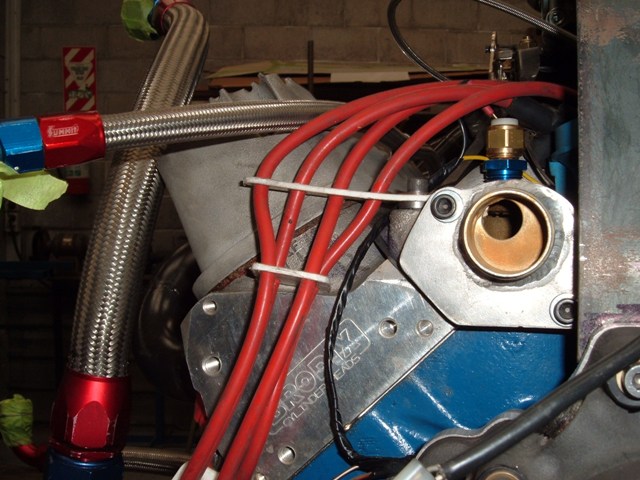

Tom,
The purpose of the bleeds at the back of the heads is, when the motor is sitting horizontal or tail high, as in most GT40s, to expel trapped bubbles of air, or steam caused by localised hot spots . You only want the bare minimum size, -3 is more than enough. Feed it into your header tank and have that with a 5/8" or 3/4" drain into the bottom hose, or the heater return port in the pump. I also have a -3 bleed from my swirl tank to my header and use a 3/4" restrictor hole in place of a thermostat. My biggest cooling problem is to get it to run hot enough!
If you have large bleeds, they act as bypasses and not only reduce flow forward through the heads but the flow through the bleeds also bypasses the radiator.
