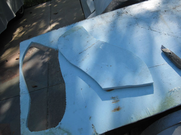

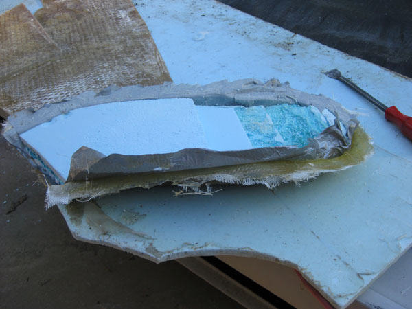

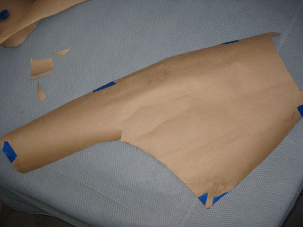

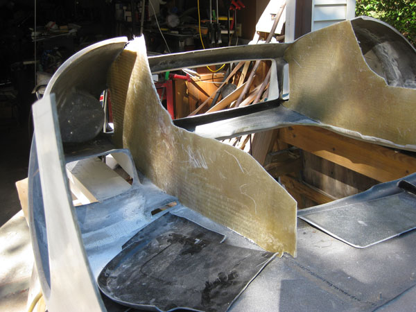

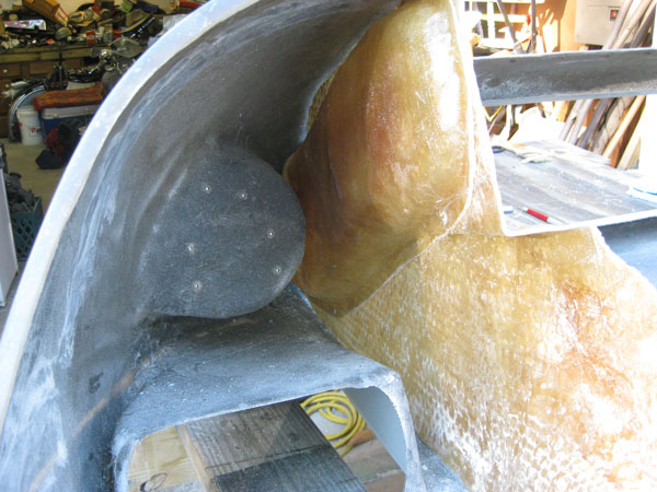

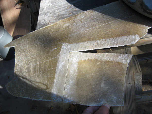

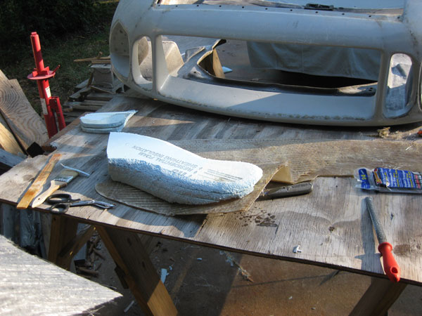

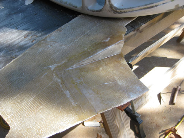

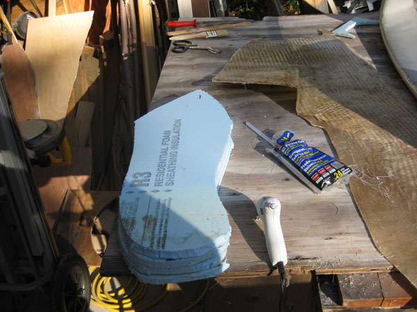

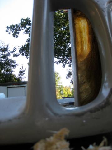

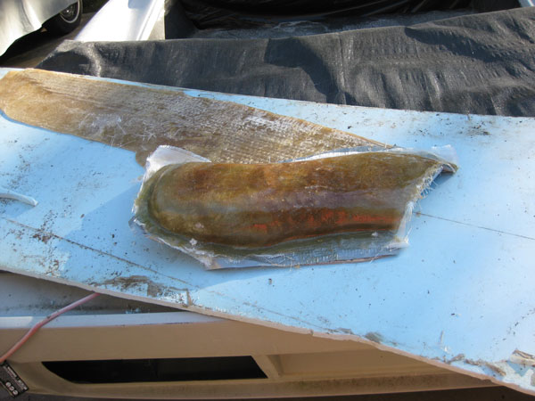

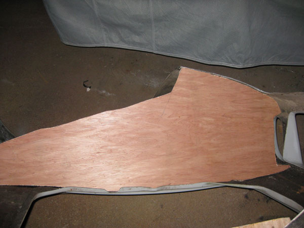

If you can make it to your local hardware box , you can make the ducts yourself !
A sheet of foam insulation board , 1 gallon of resin , some mat , some cloth , a rasp file , adhesive (to hold sections of foam together ) , and duct tape (real men use duct tape for everything ) fiberglass doesn't stick to it .
Using a knife , cut foam to ruff shape , glue sections together , get shape close with rasp , when your happy with the shape , cover with duct tape , cut mat into manageable strips ( about 3x6 ) enough to do 2 layers . Cover and leave about 1/2" edge around for a flange . Cut a sheet of cloth to cover entire part , and apply before resin cures .
In a few hours it'll come apart .
Duct tape does leave it's mark , but it won't show , or can be sanded smooth .
I made inner panels , and ducts in a weekend .
