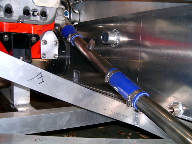

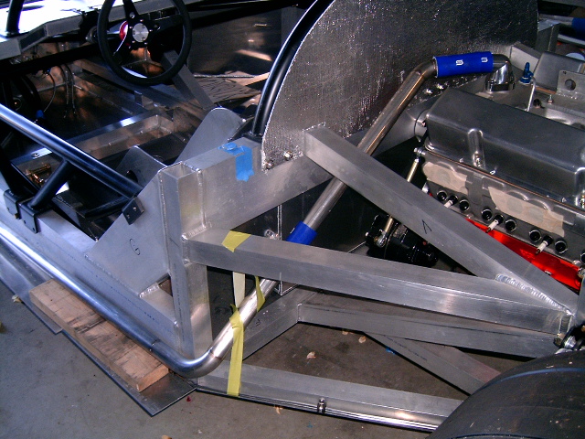

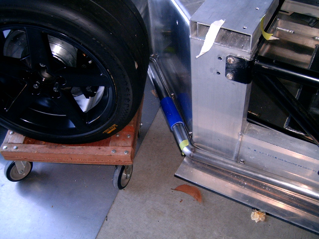

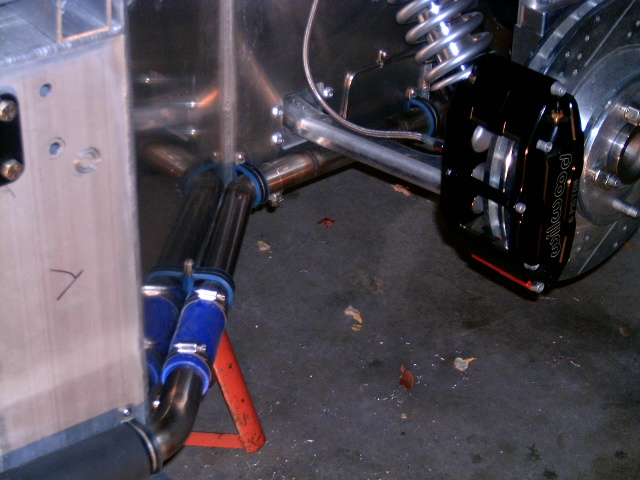

You will have plenty to do, why not just get this piece done up front. If I had to do it again I would. Have a look at my system for a basic idea. By the way I don't like the idea of burying hose inside the sidepods where it can't be repaired or in the front wheel wells where it can be cut by road swarf.

I used Howard's as a guide for fabricating mine. It took me several days to make and pressure test the welds, etc. Get it from Fran and save the aggravation.
