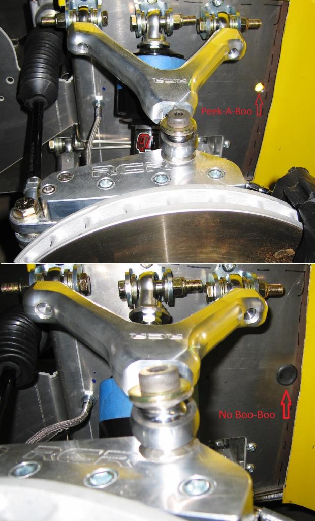

Yup, it was my Rumbles SLC Build thread. It was a plug to cover the brakeline hole, if you relocate the brakeline away from the driver's/passenger's feet.

  • I moved my front brake lines forward to give me some additional room in the foot box. That left a gaping hole to deal with. Fortunately, Steel Rubber products HQ is just 30 minutes from me. I went there today and rummaged thru their parts and found a plug to cover the original brake line hole. Steel Rubber Products PN 35-0197-31 works great. You will need to enlarge the hole from .6” to .75” to use the plug. See Pic below.
