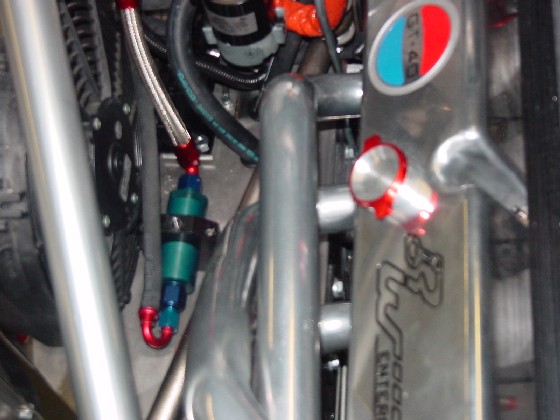

Here are some pics of the fuel system that was designed for my car. Since I didn't do this myself I'm a little on the thin side with the knowledge, but here goes.
The tank selector switch on the dash picks one of the two small black relays on the left which in turn controls the feed and return valving for that particular tank.

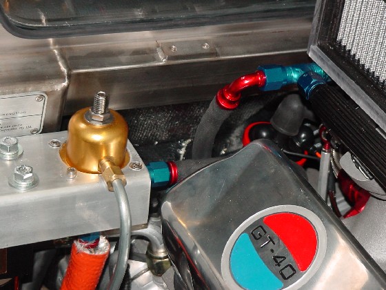

The fuel flows from the tank through the valve mechanism, into the filter and up to the pump and regulator.

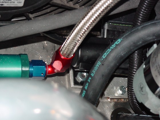

It exits the regulator going into the fuel rail. (The black hose in the picture goes down and loops back up making the connection)

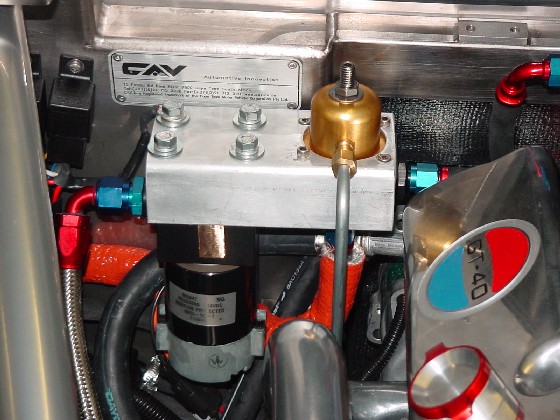

I gather this six-way valve to the right of the filter is part of the solution. A relay can select the left or right tank. The valve then works with the feed and return for that tank while having a main feed through the filter, and a main return from the fuel rail.
I know I'm missing a bit, and I know there are a few other ways to do this, but this is what I have for now and the packaging seems acceptable.

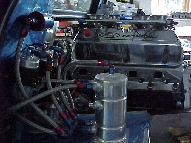

Here is a shot of my setup.
Low pressure pumps to swirl pots via fuel filters.
Swirl pot to 2 x high pressure pumps via fuel filters.
Fuel rail - Pressure regulator>return to swirl pot.
Overflow in swirl pot>returns to fuel tank.
I believe this is almost standard practice for serious fuel injection systems. Especially those that will be exposed to hard braking and cornering.
The swirl pot is 1.5 litres.
