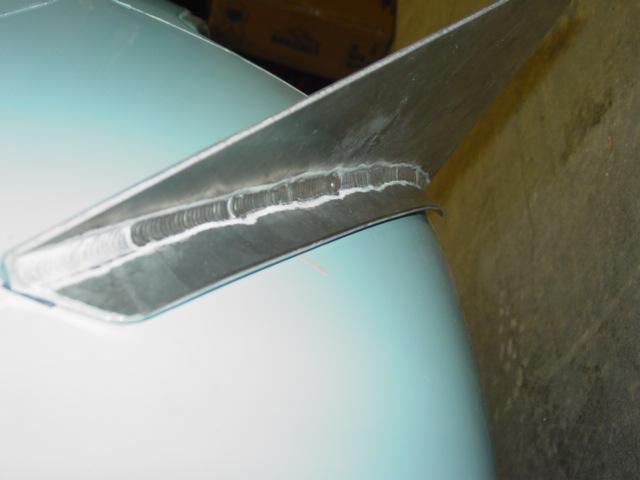

There is a flange that I recommend you bolt on .
There is a thin doubler on the inside of the body to spread the load that the Canard can generate.

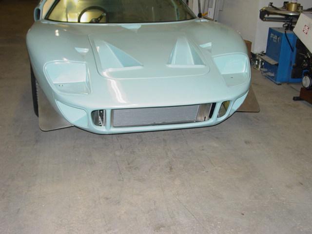

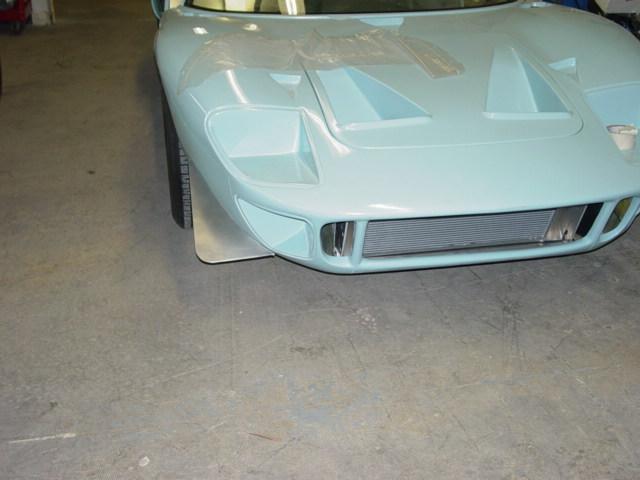

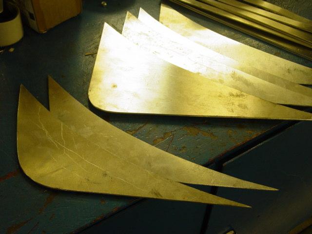

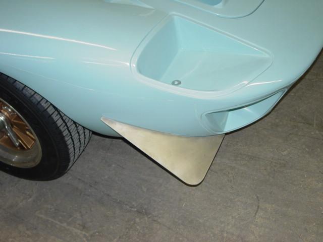

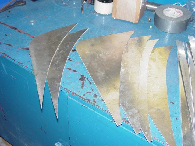

Here are pics as promised yesterday...
These are unpolished and held on with two sided tape to show the fit....didn't want to drill holes in this customers body.....not yet anyway.
As you can see we have different profiles depending upon car model..
