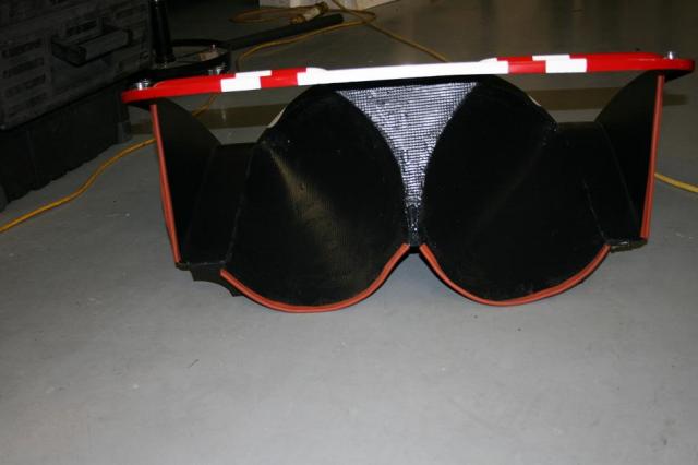

Jim, the biggest help will fix the front nostrils so the radiator heat doesn't heat soak the foot well. I did temp readings before and after and the foot-well area of your car is about 105 degrees if you haven't changed the nostrils. After the fix, it dropped down to low 80s. The change over isn't easy but I have pictures if you need them. The heat here in Arkansas with humidity is well in excess of 100 everyday now and my car keeps up. I did find that in the winter I didn't need the heater before the change over, all the heat from the radiator heated the foot-well and the engine heated my back. Glad your on the road!

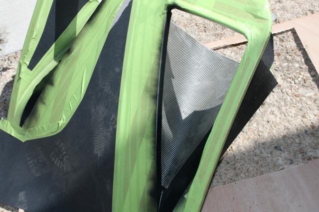

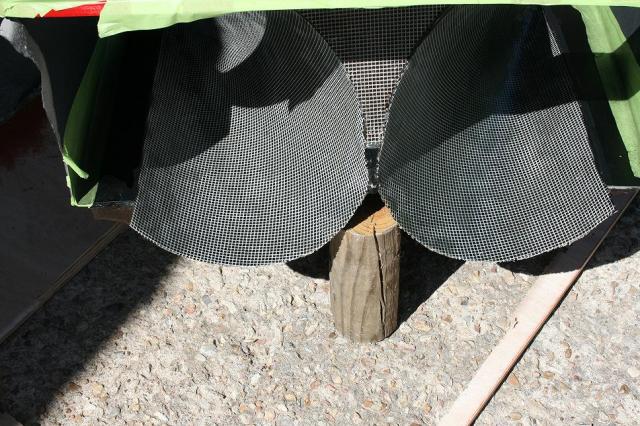

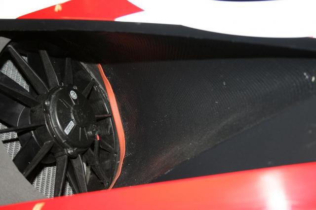

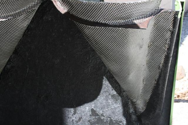

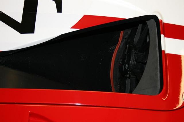

You have the best air outlet of the SPF GT40s, the Mark II has the single outlet which directs all the air outside, or lets say much better than the MK I. The MK I has about 33% of the air from the radiator heat soaking the front of the tub and creates pressure coming out of the wheel well area with the duel nostril outlets. I took a IR gun and took readings of every part of the inside of the cab looking for heat, the foot well area and the rear bulkhead was the hottest part of the car, both heat soaked from either radiator or engine, 105 F on the front of the tub and 117 F on the access cover of the front of the engine. As you all know an AC unit can only do so much but by reducing all the heat soak I have made it much better than when first purchase. Adding insulation and sound deadening all helps but redirecting the air from the radiator really did the trick. The MK II outlet is great, if you seal up the area where the single nostril exits around the radiator I think this would be all you can do beside insulate the foot well area. I know these are race cars but I am in my mid 50s and need as much comfort as I can get while I can still get around. The first of these pictures are from my templeting the area where I wanted the air to exit, notice the foam around the fans that seal against the new outlets I fabbed. I used poster board to form the pattern then fiberglass mesh and fiberglassed everything. I am not a body man so anyone know better way please chime in.

I have done what Rick suggests above (cutting out the brake tube openings) and have no noticable heat soak in the footwell.
