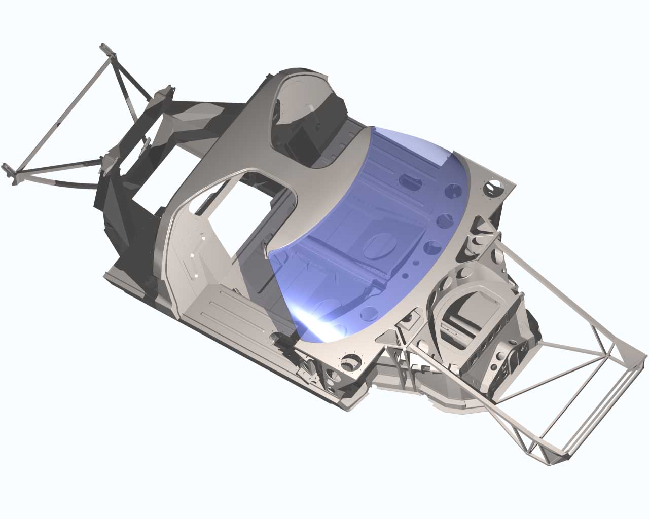

My windshield is not 100% correct yet. You can see here how it doesn't match the roof in the upper corners.

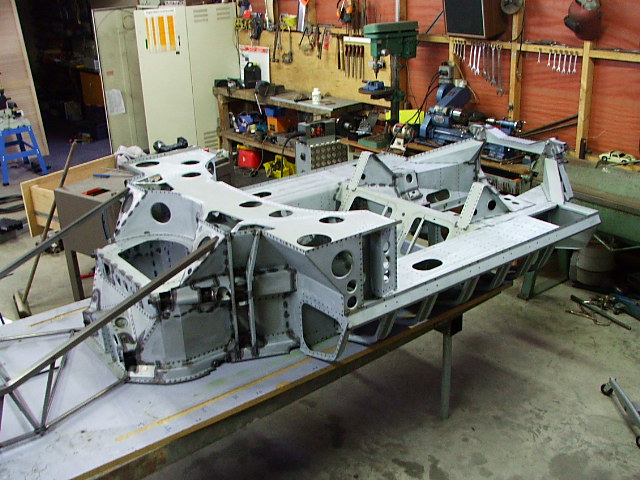

are you making the sheet metal as well or just the cad,
some one asked what tooling is required? I have two on the go to about the stage of your cad model and only used basic tools in a workshop at home will post a pix if I can work out how!
this is now out of date, I made a cnc profile cutter and used dxf files to cut most of the metal, but you can use tin snips as well
