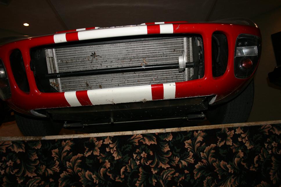

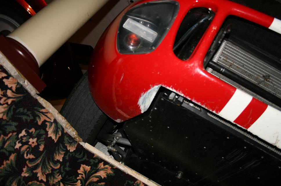

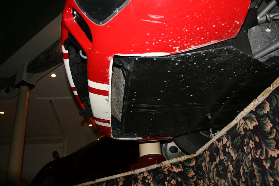

I need to wash my car but here are a few pictures of real road rash, almost 11k miles worth. Do you think the metal tubing to be strong enough for skid bars?

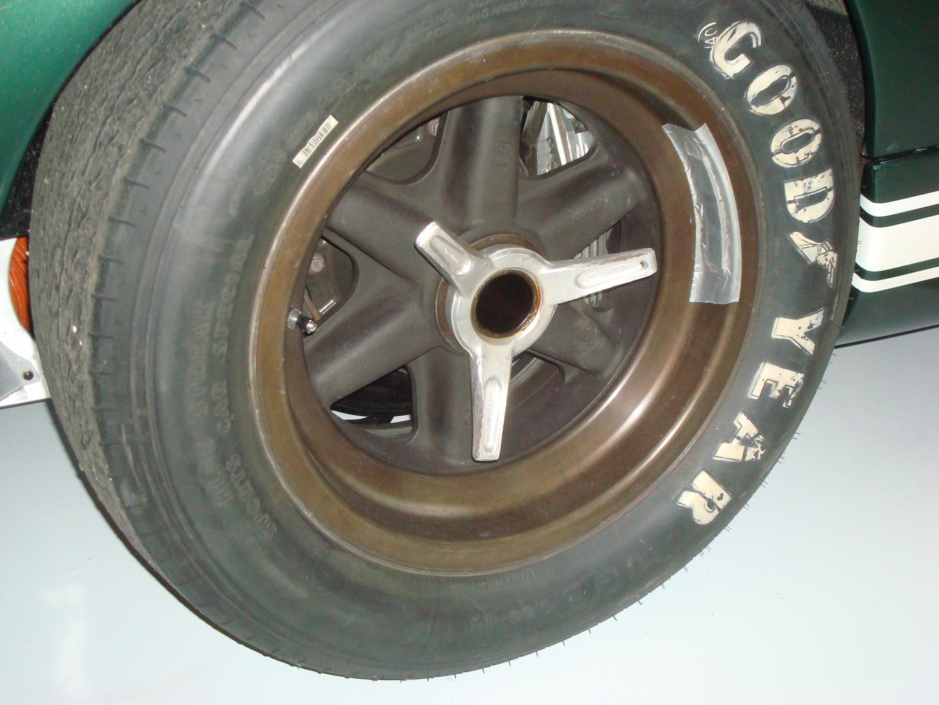

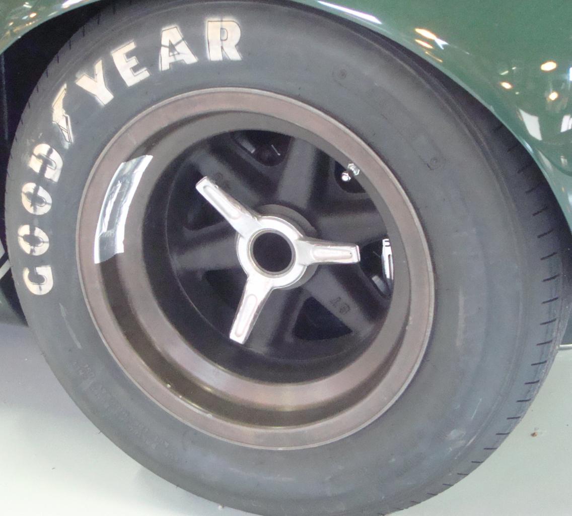

Have you looked at the 'Brown-Black' powder coat samples yet? I'm also trying to find the right powder coat tint for my wheels, something close to a very dark bronze and similar to the one at the Shelby-American Museum in Boulder.
So you went White? Looks great, really like the FORD lettering and the contrast. Staying with Bronze colored wheels?
