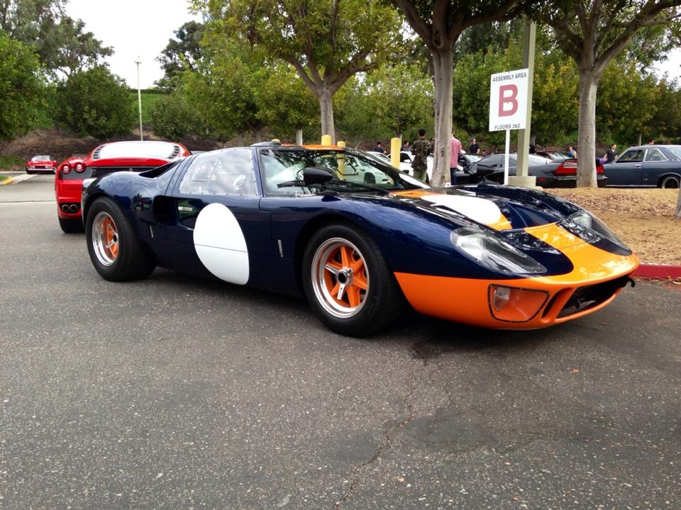

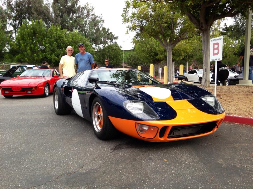

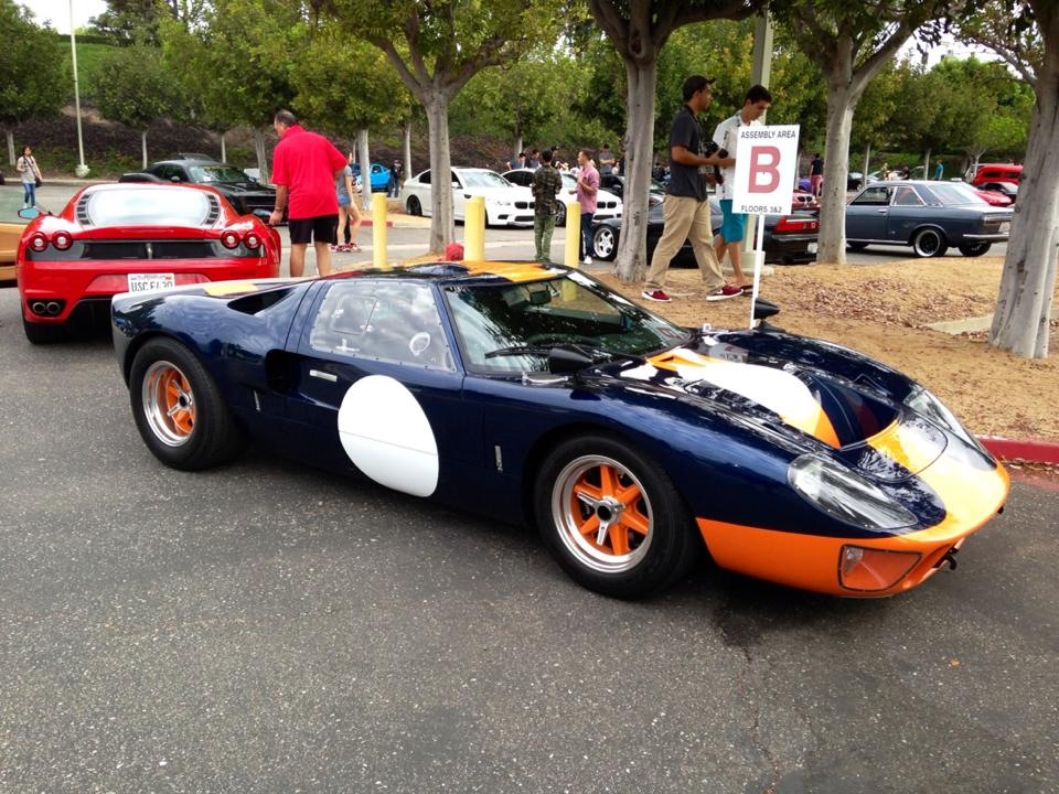

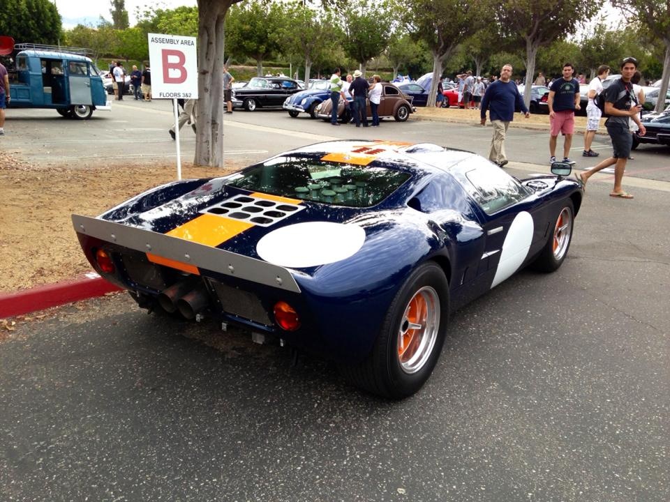

I saw your car at Olthoff's in April and was impressed!
Here are some pictures Lance sent me....

Wow, that is just an awesome car. The color scheme is really striking--really inspired! Well-done!
I know I said that before. But that was just getting a glimpse of the car. Now that I've seen the whole thing, I feel compelled to say it again!

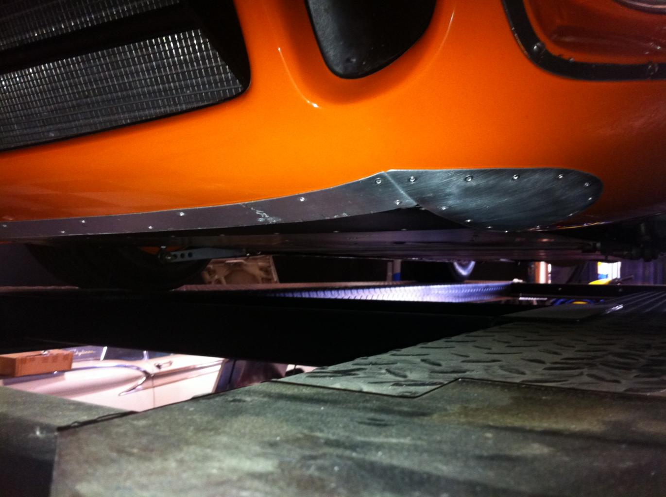

Mike,
I measured the car at the points you asked and I sit at 4 3/4" at the rear and 4 1/4" at the front. I really like the look of the lower cars, just don't think I want to go there yet. I would have to install one of those front end lifts that Rick did, super clean with a very small hydraulic resevoir that lifts the car about 1" - 1 1/2". I also attached a couple pictures of the skid guard Dennis/Paul did on the nose for those little scrapes that I am finding are pretty hard to avoid, even at an angle.

Thanks for the measurements. Mine is at 5" in the rear and 4 3/4" in the front. I barely scraped the front corner one time last year when going through a moderate dip getting onto the street. It went through the clear bar and put a little knick in the paint. Other than that I have not ever scraped anything else. When I repainted the car white I considered doing the front plates but decided against just to keep it clean and not drill all the rivet holes. I am going to take mine down to 4 1/2" front and rear and just continue to be careful.
