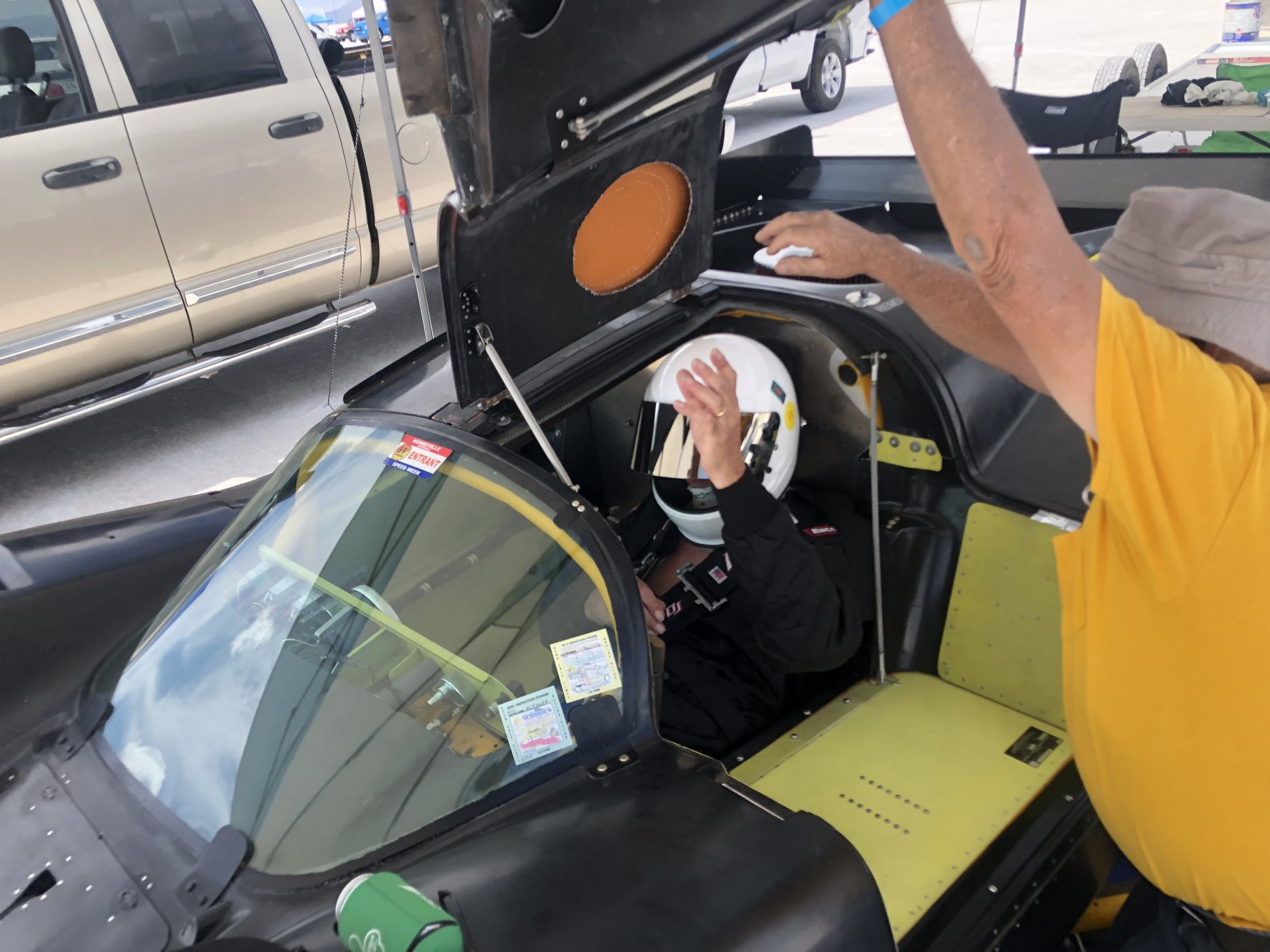

Yes, I always wear a helmet in my black Mirage. My red one is a street car with no roll cage but it does have a roll bar.
OOOHH. yea, without the helmet, even a slight impact would scalp you without if I'm seeing what I think I see in that door.
I am not sure I would want to be wearing a 7-point harness driving the streets. Beyond confining. I think you have to think about the practicality of a 6 or 7 point harness for normal driving versus a track car situation. I look at all the very high performance cars Ferrari, Lamborghini, Aston, etc. produce and none have such harnesses. A high quality 3-point is more than sufficient if installed properly. That is also why designs like the ERA GtT have a Roll Hoop but it is BEHIND the passenger firewall. The problem with kit GTs (for the most part) is the center section is just fiberglass and not a stressed steel structure like the SPF tub. I would be far more concerned about hitting something like a road barrier and having it come through the A pillars which are weak and hit me. Someone was recently killed in a cobra that way. There is little strength with that structure made of glass.
