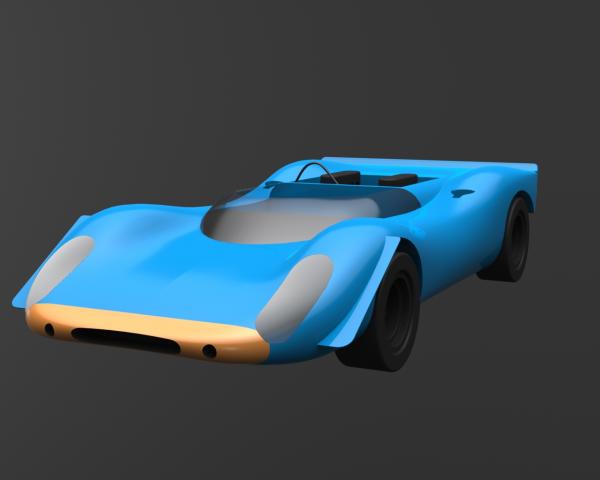

It's driven me half insane trying to do this, but I finally have managed to create a body in Solidworks. It's supposed to be a 908, but I'm not claiming any accuracy because the 'blueprints' I used were a 3 view drawing from an old slot car magazine, found on the web.

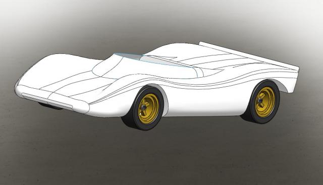

Now approaching completion after no end of further work and banging my head against what seemed like a brick wall. I'll probably release the Cad model into the public domain for scratchbuilders to use.
This must be the least popular thread on the whole forum, isn't anyone even slightly interested ? :)

I'd say that she's coming along quite nicely Sid!
What are your plans for this?

Not all of us care to admit that we have similar symptoms to what you consider insanity Sid, we prefer to call it an addiction for which we require no cure.:):)
Look great Sid, and I know how much work it takes - Well done
If don't know if the shape is set in stone now, or if you are still tweaking it? If you want to give someone who might take up the challenge the best possible chance of building a replica that "looks right" can I suggest that you spend some time comparing your shape to as many photos of originals , particlullary period shots, that you can find. Rotate the model to the same angle the car is in the photo and look really closely at the lines and other features. I did not do enough of this before I stared building my T70 spyder inspired plug and made lots of extra work for myself

Good advice Fred, now I stopped cursing at Solidworks so much I'm starting to notice areas where the model disagrees with photos. The design isn't final, but it's a lot of work to remodel the body. You can't build it and then tweak it much because there are usually unintended consequences that break other parts of the model. really you have to go right back to the start. But every time I have to do that it gets a little bit easier and takes a little less work.
Right now I have maybe 30 or more hours invested in it and I expect a lot more.

i discussed this once with a friend who works a lot on CAD. He told me that solidworks has his limitations in "free form surfaces". He said that actualy a surface model of Solidworks usualy has a lot of problems where the different lines meet each other ( overlapping) and thus creating issues for transferring it into the cnc milling programm for the buck. He recommanded to do it in CADIA.
Don´t know if this is true and relevant, but suggest you check this and transfer into CADIA before spending even more work.

Using Catia or Pro E in a true parametric model you can push, pull, stretch the surface into any shape you desire.
I doubt that the solidworks surface would migrate into Catia or Pro E correctly.
You could slice the model both longitudinally and transversely and form a series of sections, then migrate those section models into Catia or Pro E. Then blend a
surface over the sections.

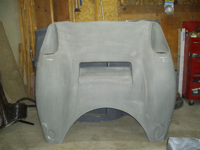

The ducting is easy for the rad in the front. Just add it. Here's a picture of my front clip.
After taking your advice Fred I'm really glad I took it ( does that make sense ? :D )
I was missing a lot of the 'coke bottle' aspect of the shape. Plus there are any amount of more subtle differences. I wan't really intending to do more than create a generic spyder shape, but what the hell, now I have come this far I may as well get it as correct as I possibly can.
Dave - Thanks for the front clip idea, you have made a great job of that.
