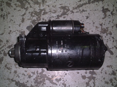

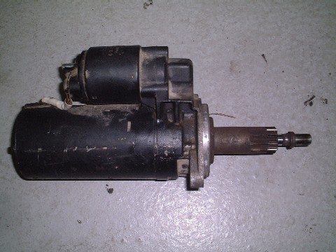

This is all I could get.
Long nose starter is for the duel mass flywheel.
Bosch # 001 110 059
Porsche # 964 604 104 00
Flange to end of shaft 113mm
Flange to end of gear 87mm
10 teeth.
short nose
0 001 312 110
flange to end of gear 36mm
9 teeth.
