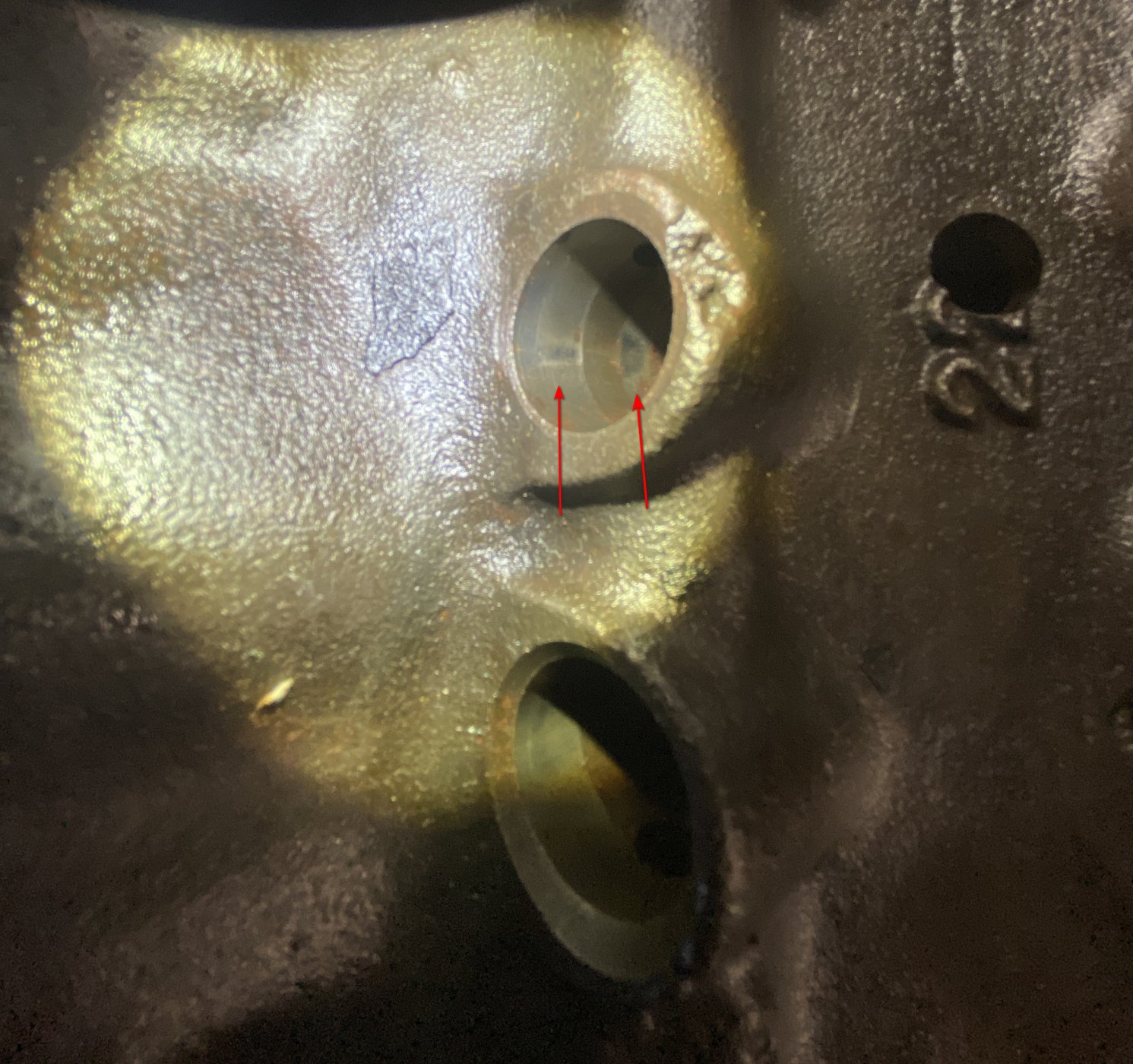

I am in the process of getting my 1971 block ready for boring out and some other work and noticed some wear marks in the lifter bores. The block is on a standard cylinder bore size and the crank that came out was on standard mains and 0.010 big ends which were done recently and not run since (then i bought it).
Do these look like acceptable wear marks?? I have measured the bores with a bowers bore mic on all 16 and they are coming in at around 0.87598 (compared to 0.875 new) but its the vertical marks i am worried about, this is not on all of them either.

As long as the new lifters slide freely in the bores should be fine, that looks like a 'historic' wear mark perhaps from a previous cam issue.
If your intending to replace with another flat tappet cam you should really, really, really look into grooving the lifter bores so that oil is squirted on the cam lobe just prior to contact with the lifter, also helps with roller cams.
