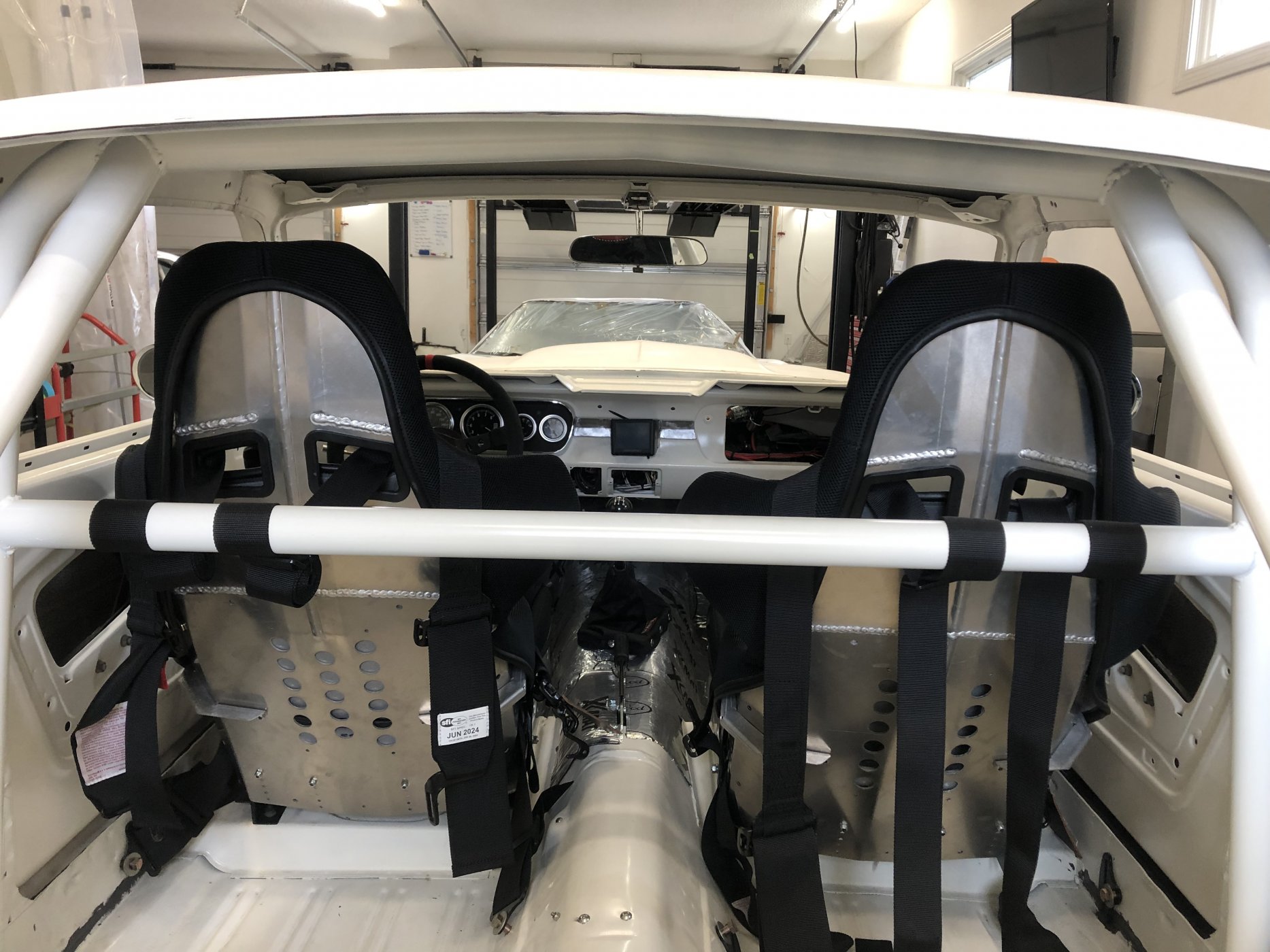

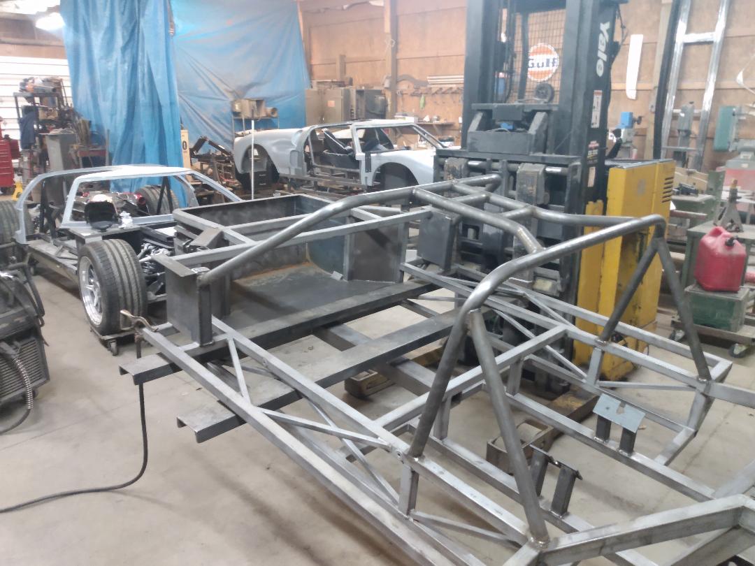

The car will be tracked as well as street driven. After much consideration, I decided to go with an A-pillar bar and roll bar. I know what the arguments are out there against it, but I feel it is the best compromise. I'm 5'7" tall and will be sitting low in the seat, and always strap in. My 69 Firebird has a similar set up with an a-pillar bar and hoop. Even with a helmet on, my head is a long ways from any bars.

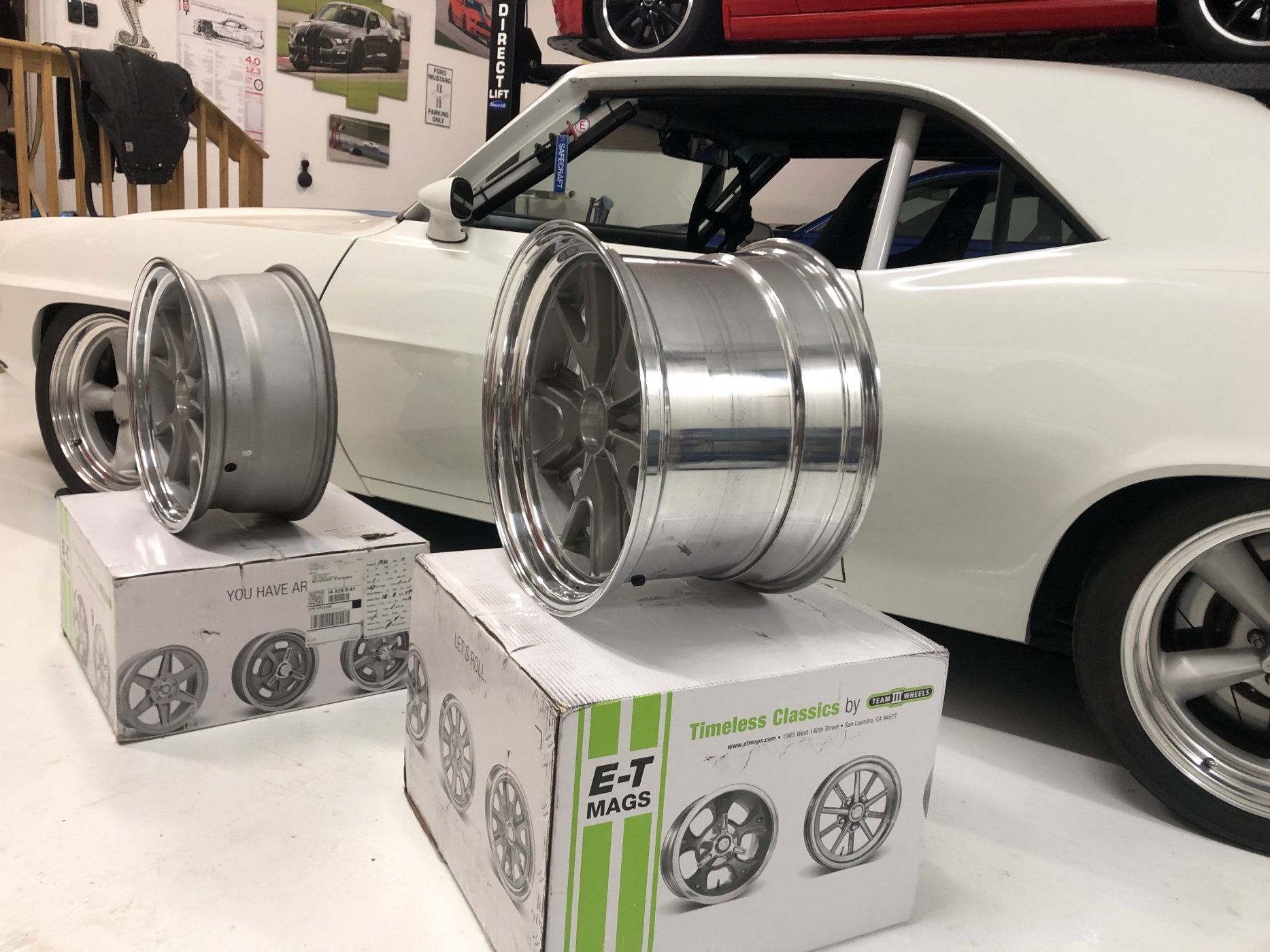

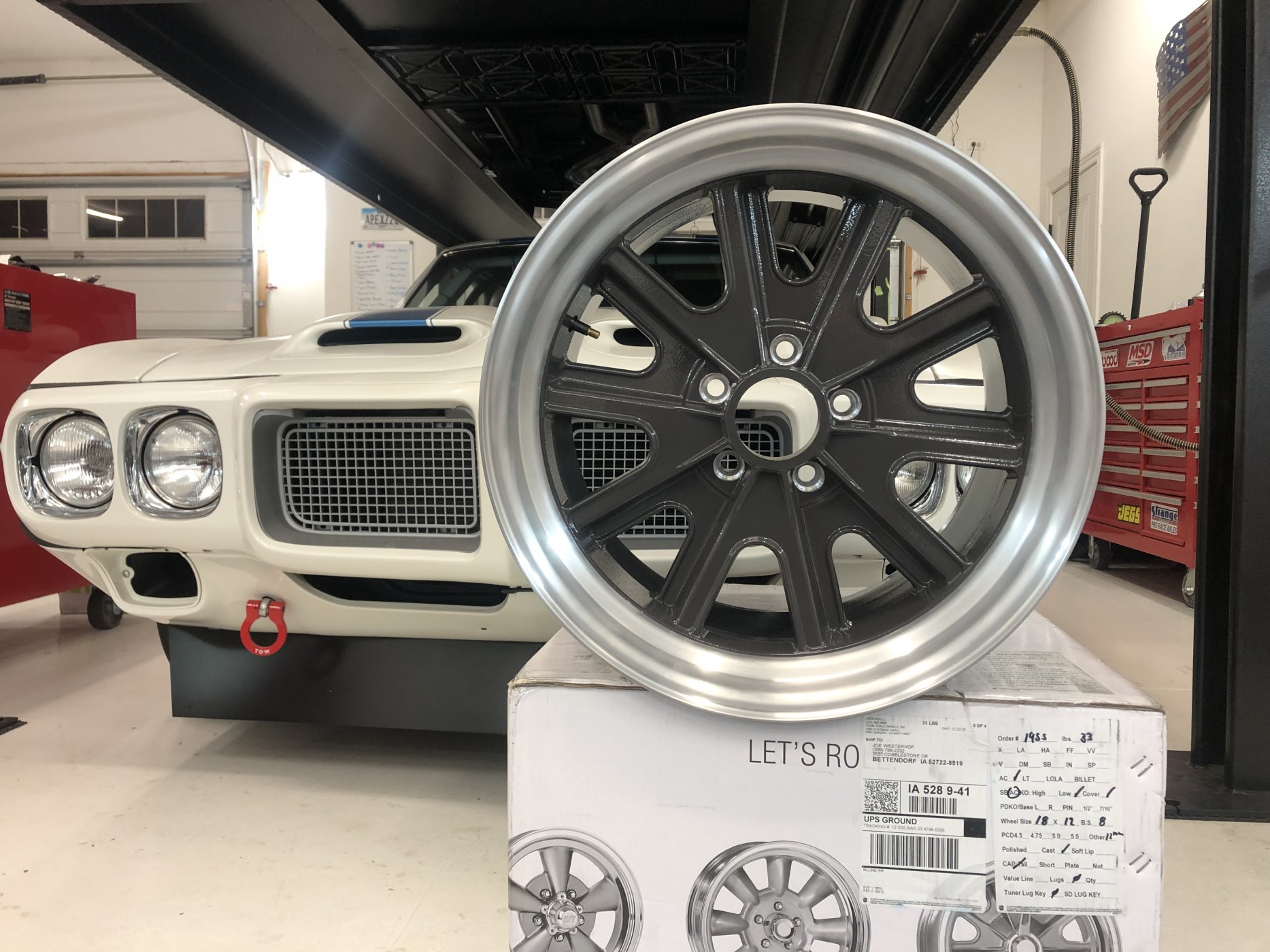

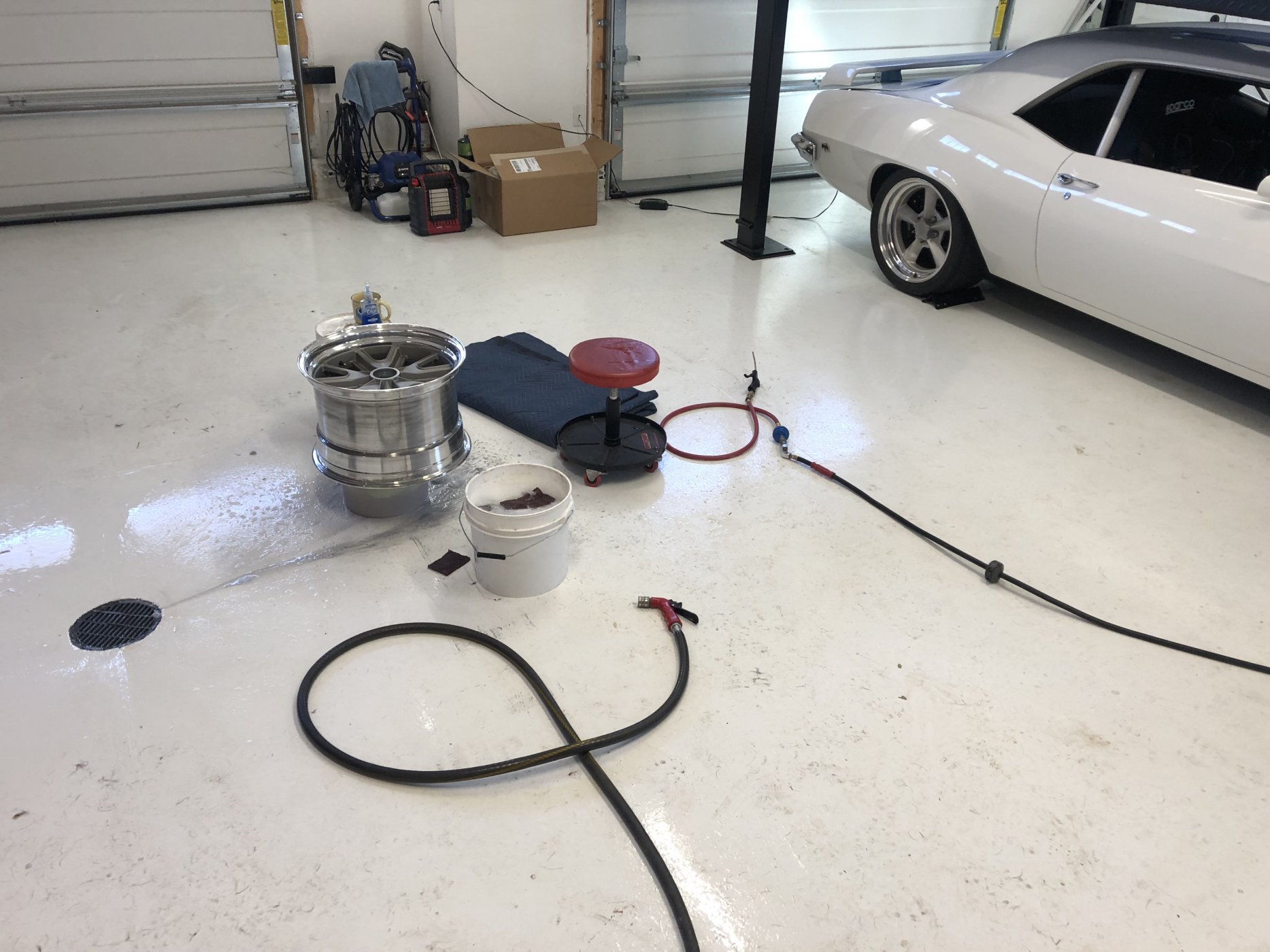

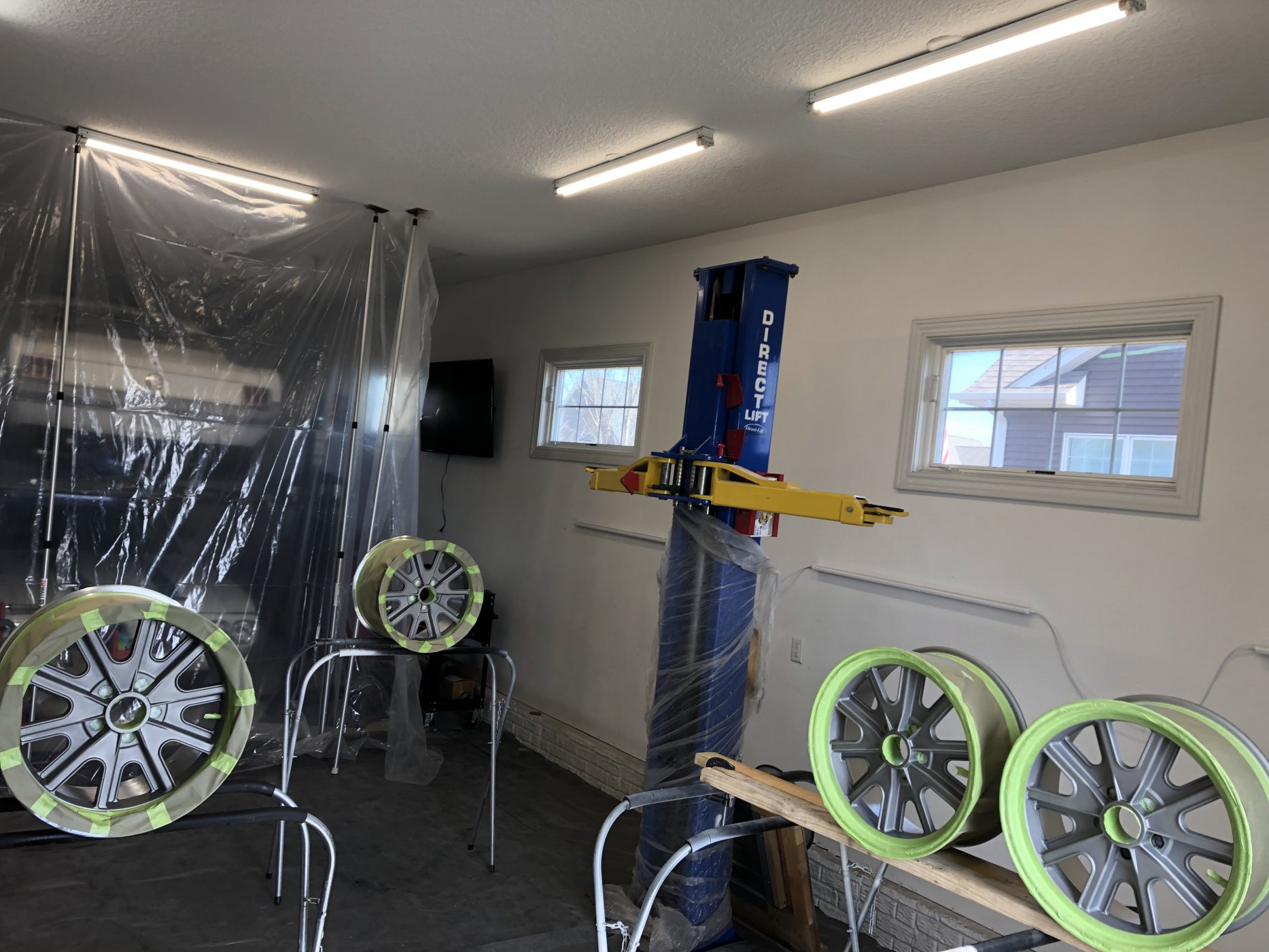

Mean while, back at my place, the first parts arrived...wheels. I'm not sure how much time I spent on the phone with ET (and some help from Buttinz), but is was substantial! I had the wheels shipped to me for paint. They will be shipped to Chris at the end of the week.

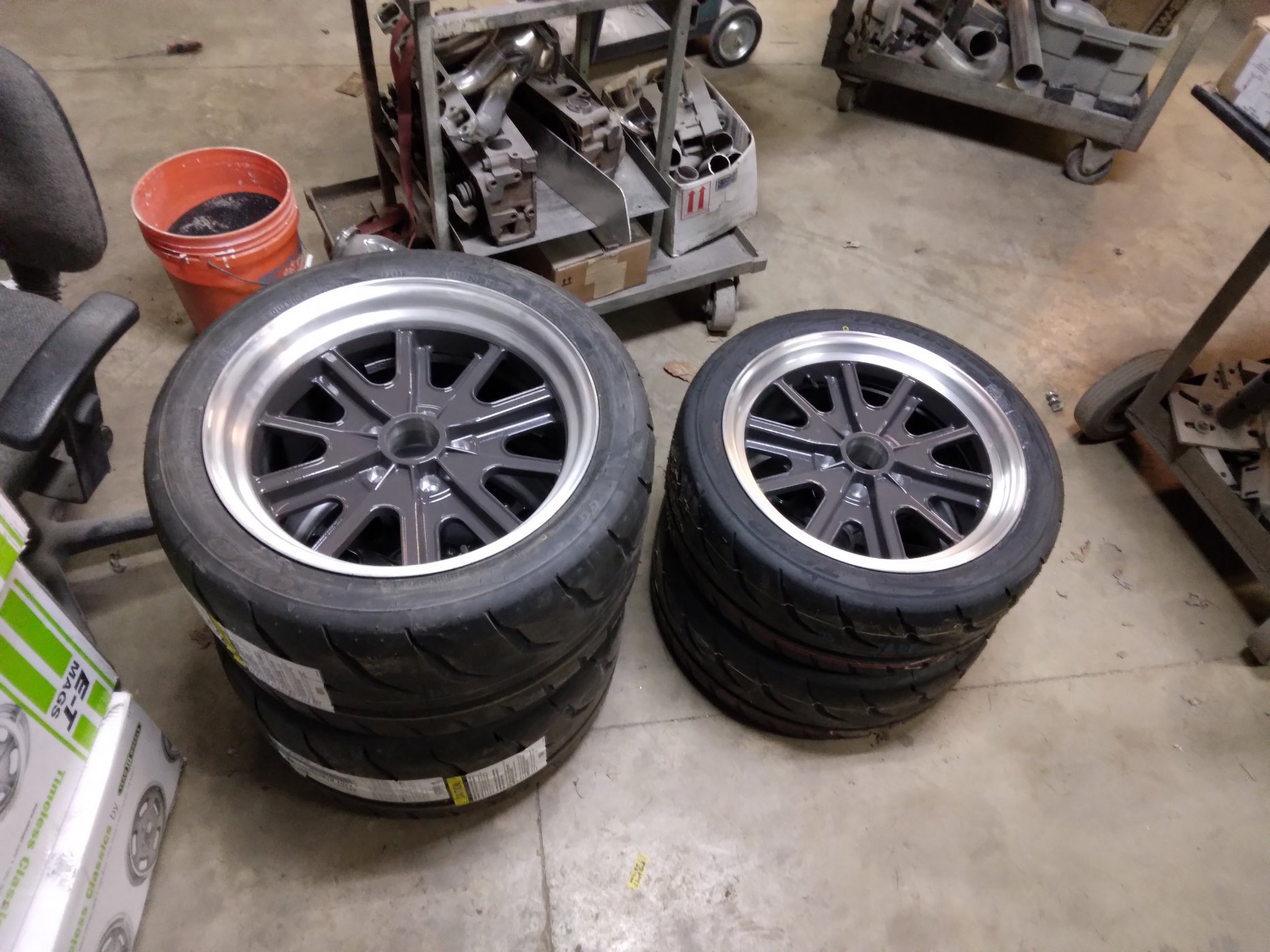

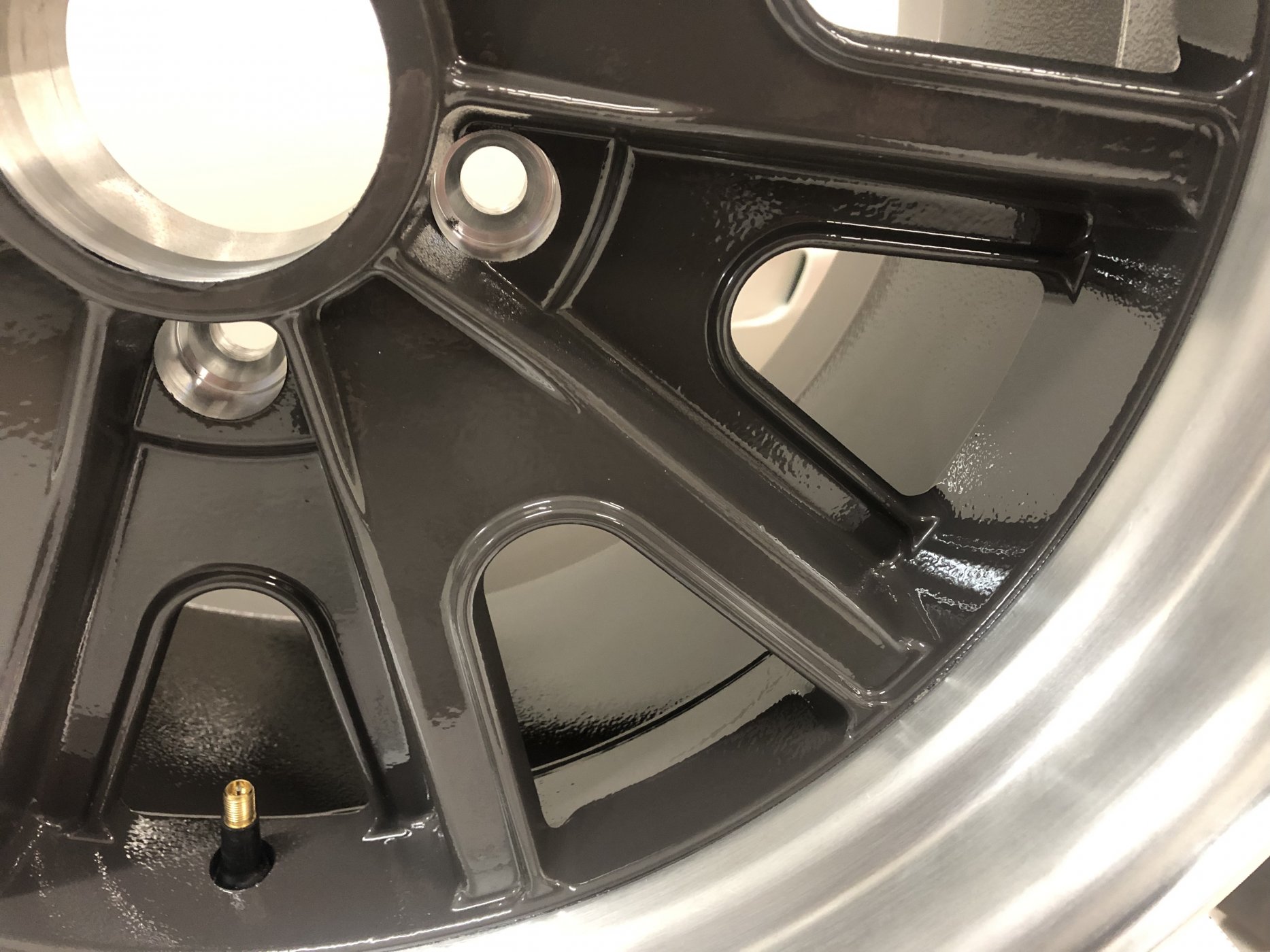

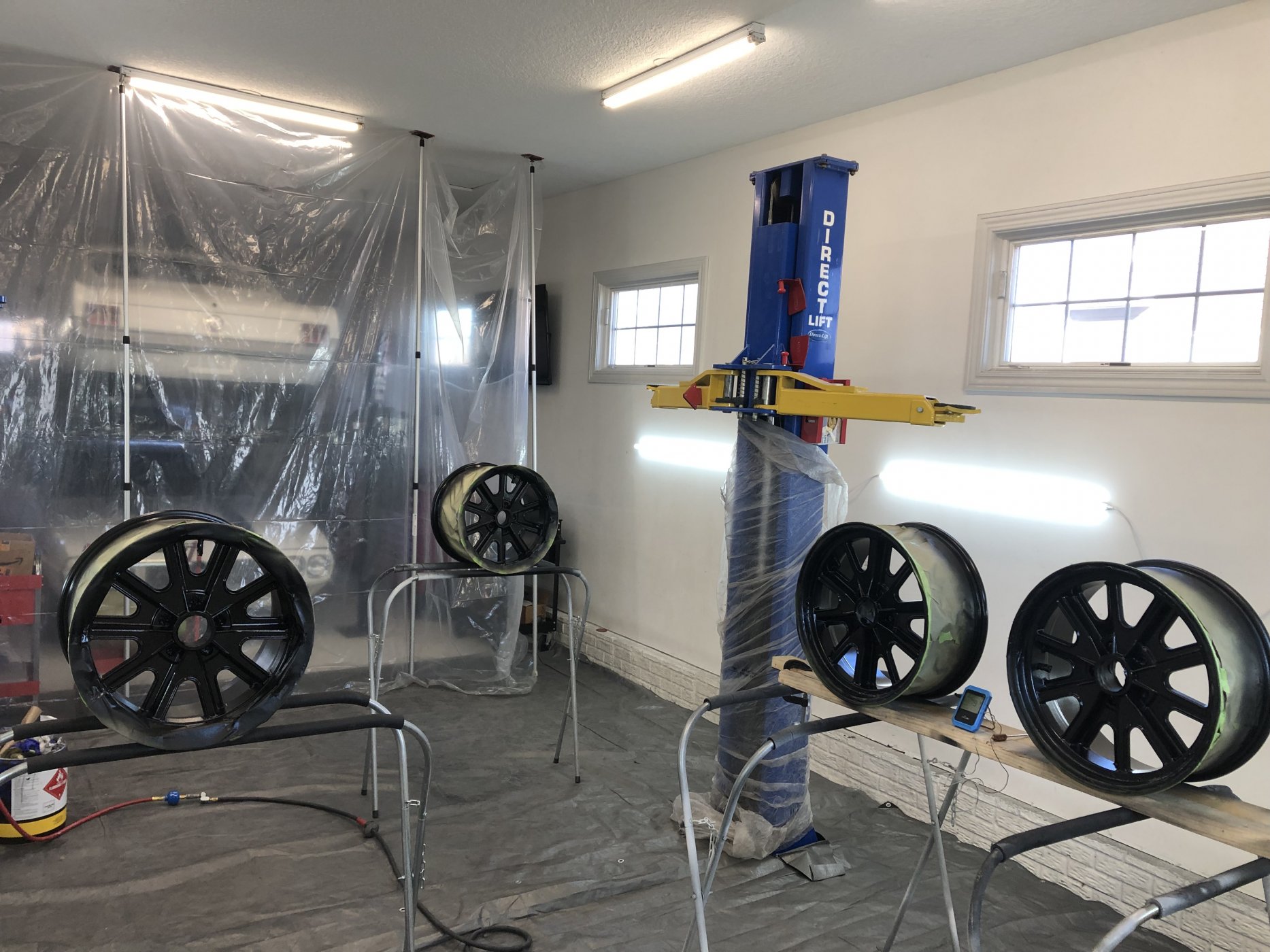

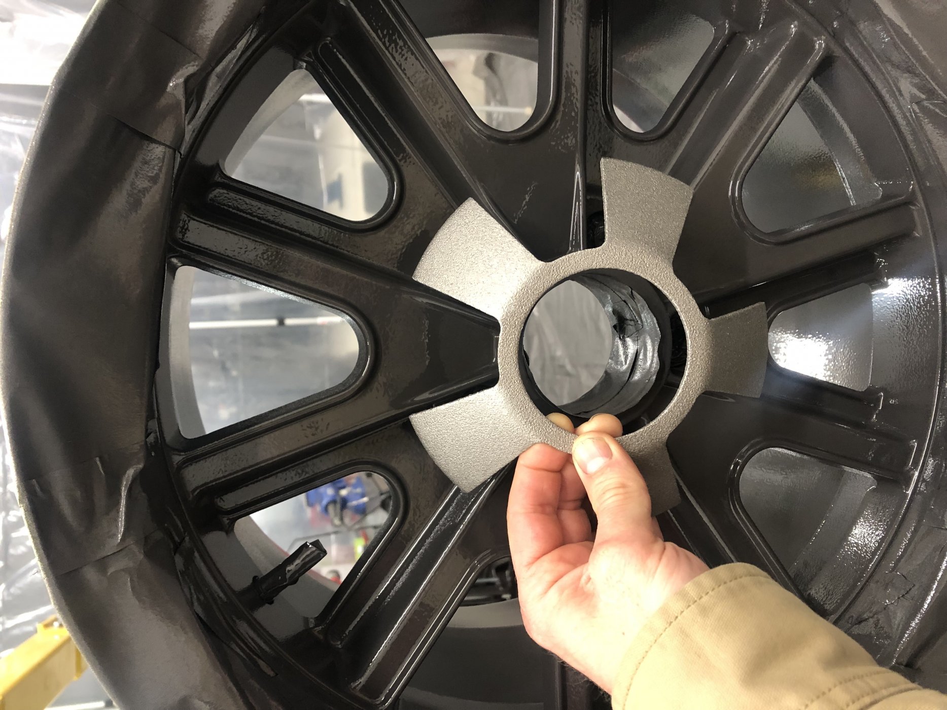

I hit the wheel lips with a red Scotch Brite pad during cleaning and liked the way it looked. Black SPI primer was used under a dark gray single stage paint. You can see how much darker the new gray is compared to the finish on the lug cover. I'll be unmasking tonight.

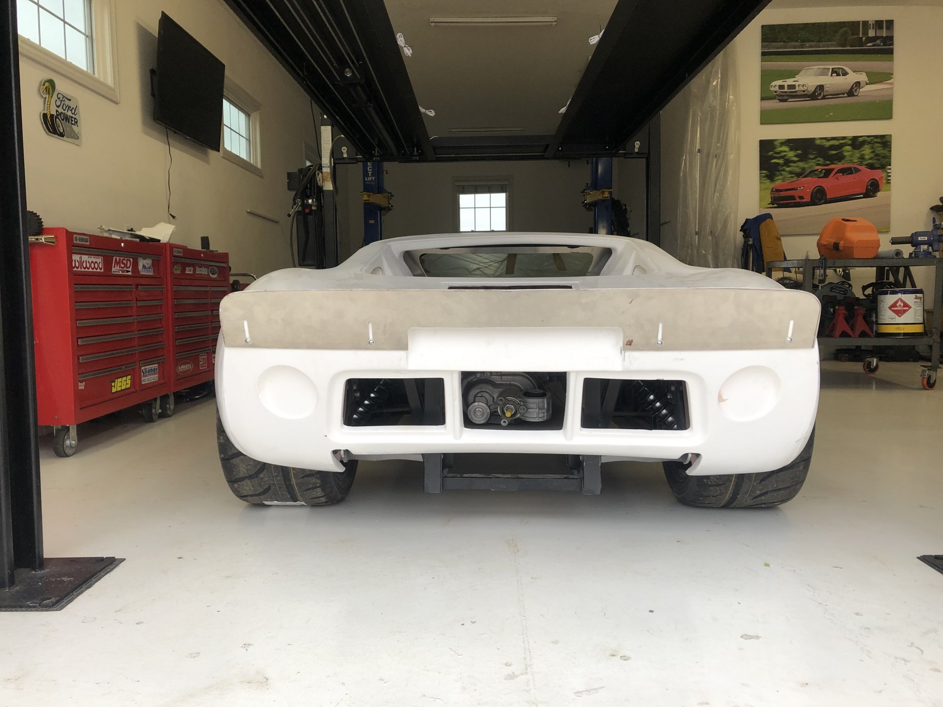

I'm pretty sure I got the last set of Toyo R888r 18x335 in the country from Discount Tire! I had them shipped directly to Chris.

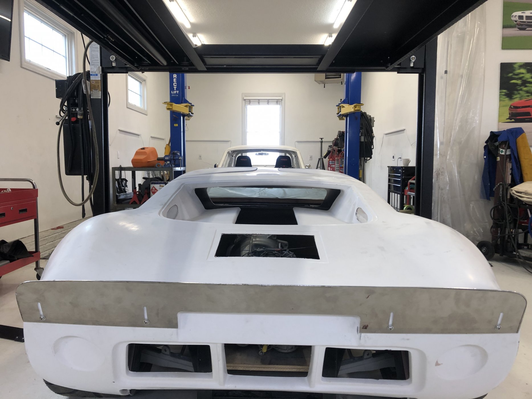

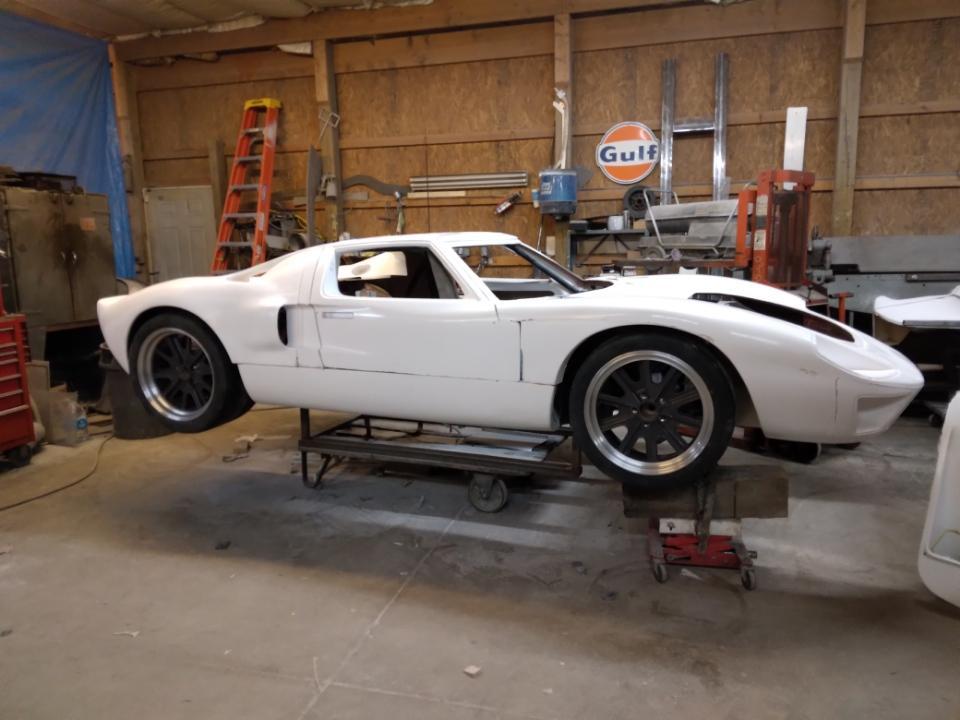

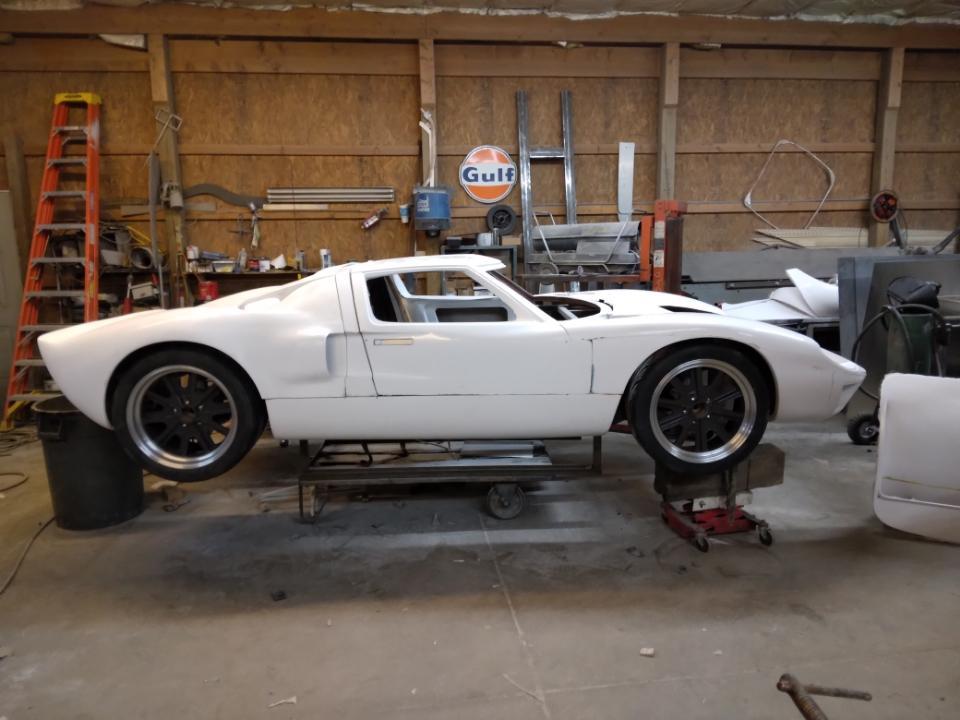

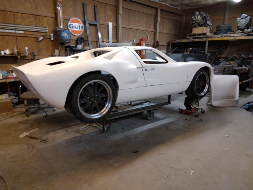

Wheels are mounted and the car should be on the ground in a couple of days. I’m not sure if I’ll keep the satin wheel lips or even the shade of gray…depends on how the car looks.

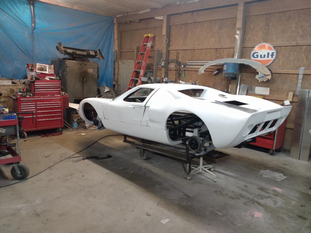

We’ll be finalizing the build and arranging shipping this week!

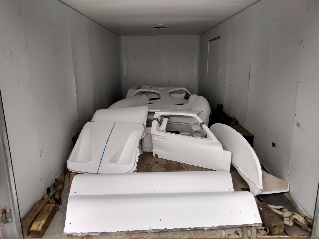

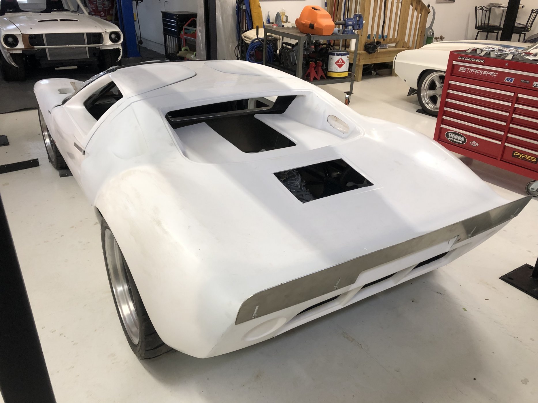

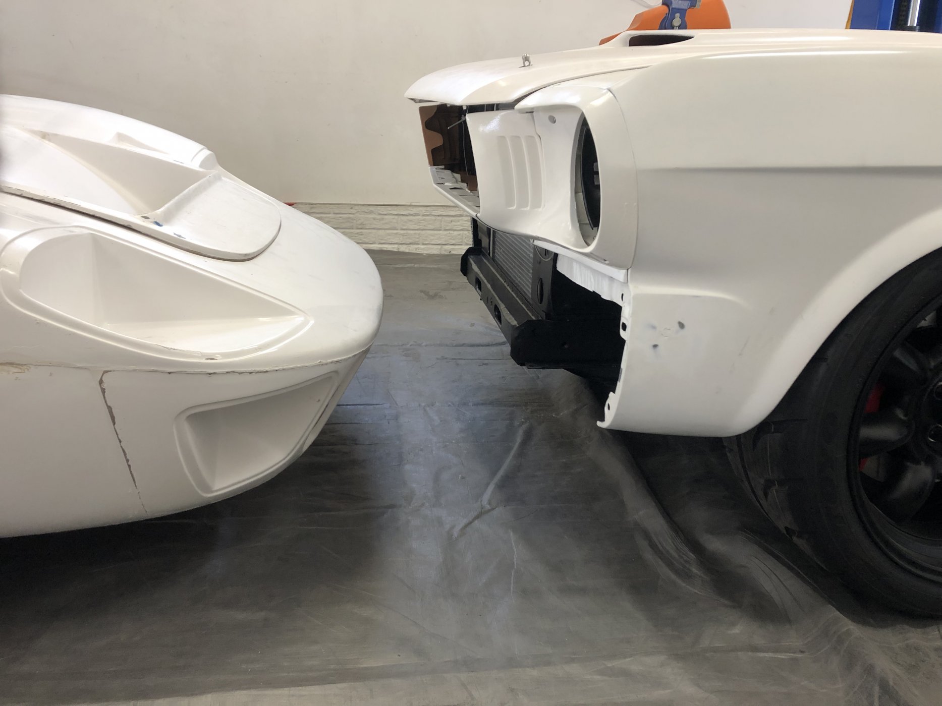

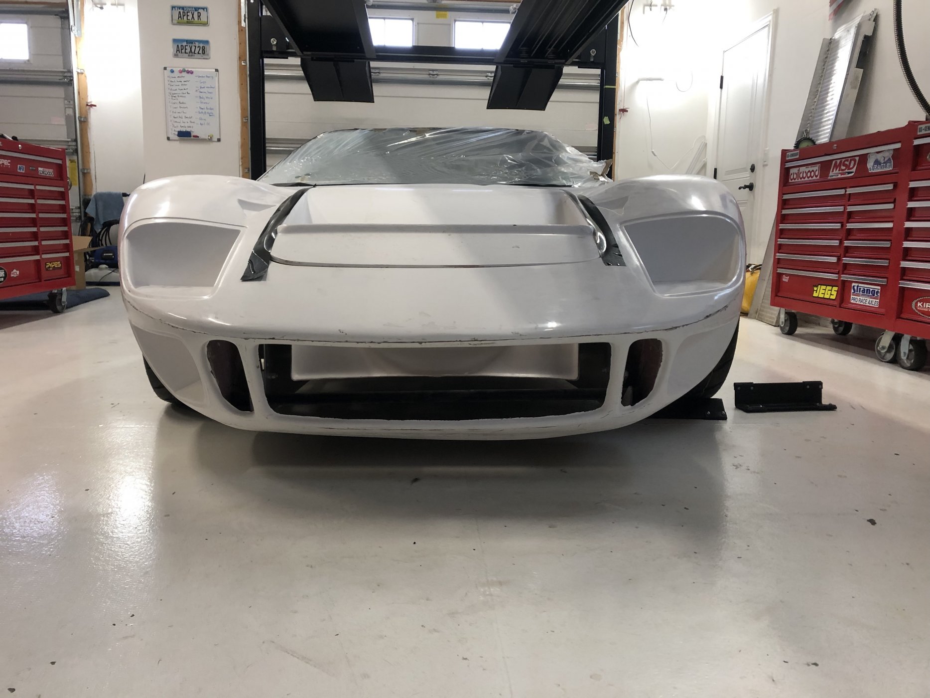

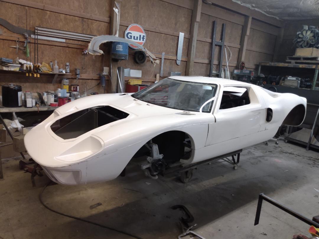

Chris is finishing things up today and the transporter will be picking up tomorrow for a Sunday delivery. It will be interesting to see how its size compares to the other cars in the garage. I haven't seen a Mk1/2 GT40 since I was at the Miller Motorsports Museum while at Track Attack for my Boss 302. If I remember right, the Ken Miles LeMans car was there!

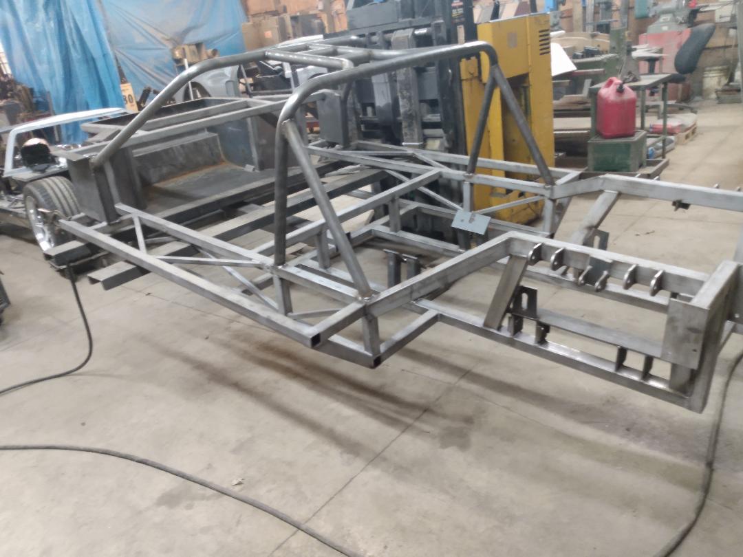

I haven't had the time to unpack it yet. As far as I can tell so far, his project isn't for the faint of heart. I've done 2 frame-off restomods so far on my own (from metal work to final body work). This thing is in better shape than what I'm used to!
