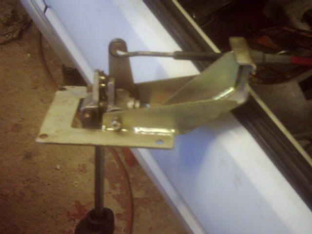

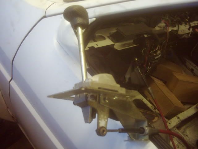

anyone recognise this shifter ?
one the right way up , one upside down, i need parts for it for my car ( not a GT btw) iveno idea what its come from or who and i could do to find out if anyone has any ideas ?

Looks identical to a Renault UN1 based Lotus Esprit to me.
Hope it helps. These generally only suffer wear from the reverse lockout bushing/plate and the little bushings in the sides. Those little bushings do require a preload that can be a bit fussy to set up.

Lotus Esprit using the Renault UN1 transaxles, I really don’t know of this was designed and built by Lotus or just lifted from one of the Renault models.
