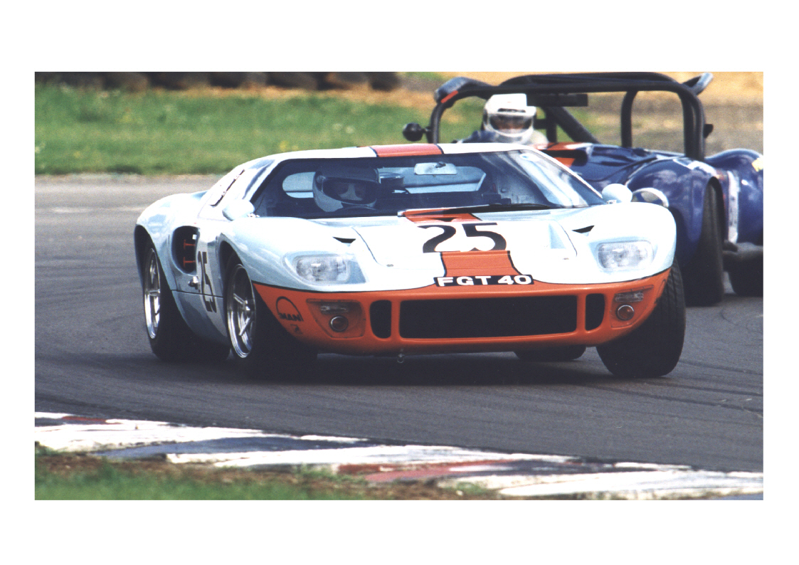

No problems at all on a 10inch rim, but I do run lower tyre pressures before a race or qualifying which allow for increase to my desired pressure.
You should have no issues whatsoever for road use, but if I was using my car for just road use I would always go for 295s purely for "softer ride" and looks !!!

The car is going to be doing a lot sprint events. I need to order wheels and trying to get the best look....
Brian your wheels look perfect.....tyre fitment is e actlyhow i would like them to look.

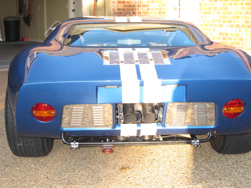

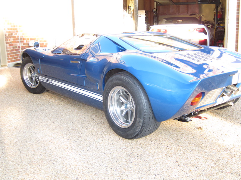

275/55-15 on the rear and 225/60-15 on the front. Rims are 10" and 8". The suspension is set a bit too high on purpose right now. My driveway is too steep for this car, so I am using wood planks to bridge the driveway to the street.

Did the lettering myself Dave. Just got a couple of sheets of sticky paper, printed the letters on, cut them out using a craft knife to make the stencil, clean the tyre, stick the stenciled letters on, mask any tyre still showing, then a couple of coats of rattle-can off white and peel the masking and stencil off. Pretty happy with the result. Note that rear tyre stencil letters have to be larger than front to fill the higher sidewall. Send me your email address and I can send you my original rough stencil if you wish.

Man nice pic. Also look how low the car is the car behind you the guys head is way over your roof line.
I drive a Cobra replica....when I get into that car I am always mindful that the bumpers on most cars are at shoulder height... or (even worse, as in the case of a Ford 350 Super-Duty with a pipe bumper) ear height as I sit in the driver's seat. It's a scary thought and certainly increases my caution in how I drive.
Most of us have little idea how low a 40 is...until a picture like this one comes along. GOOD GRIEF....it must be almost like laying down to drive one.
How can a normal person look at that photo and not lust after a 40???
