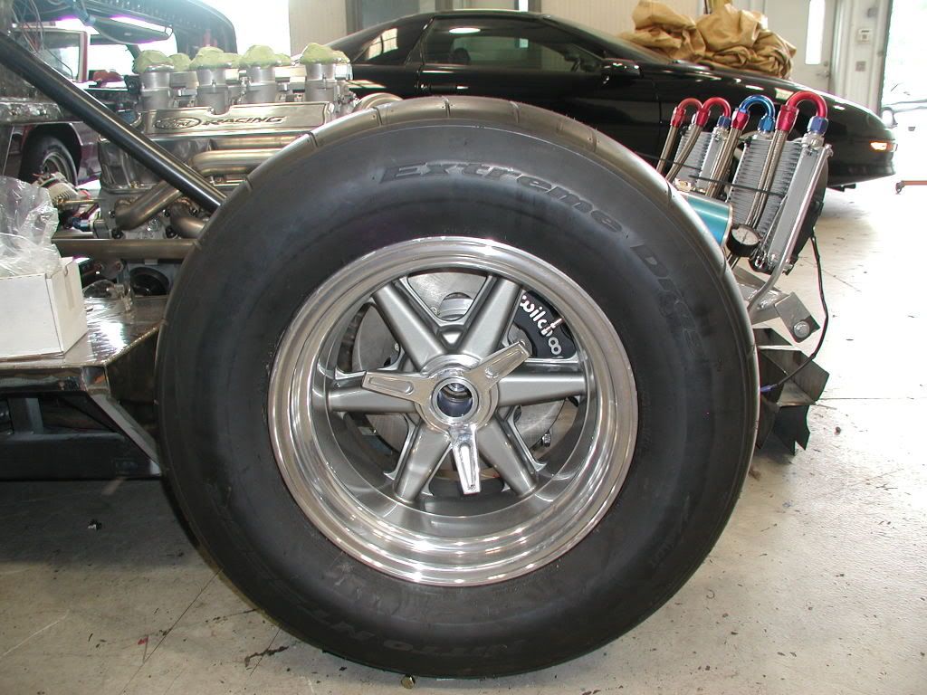

Take a look at the Nitto 555s The rears are 325/50/15s(27" tall if I remember) and the fronts are 225(I think 24"). I have these on my 40 and the widths are 13 for the rears and 10(I think) on the fronts. There are no scrub problems with my car. I have the C-4 corvette front arms. The rears are their drag radial and the tread pattern is different from the rears(directional). They have been used on road courses and hold up very well. Will send some pics and measurements of them mounted on my pin drives when I get home.
Checked the tires and wheels. The rears are 13" on 10-10.5" wheels and stand 27". The fronts are 23" tall and on 8" rims. Speed rating is 149.
http://www.discounttirezone.com/NITTO-NT555R-DRAG-RADIAL-32550R15-114V_p_3282.html
Now the offsets are another matter. As I remember they were the standard offsets for that size wheel. Maybe you can tell from the photos.
This is how the car sits. The wide fenders were grafted on to match the tires. With the regular fenders the tires stuck out about 2" and the rear clip would not close.
