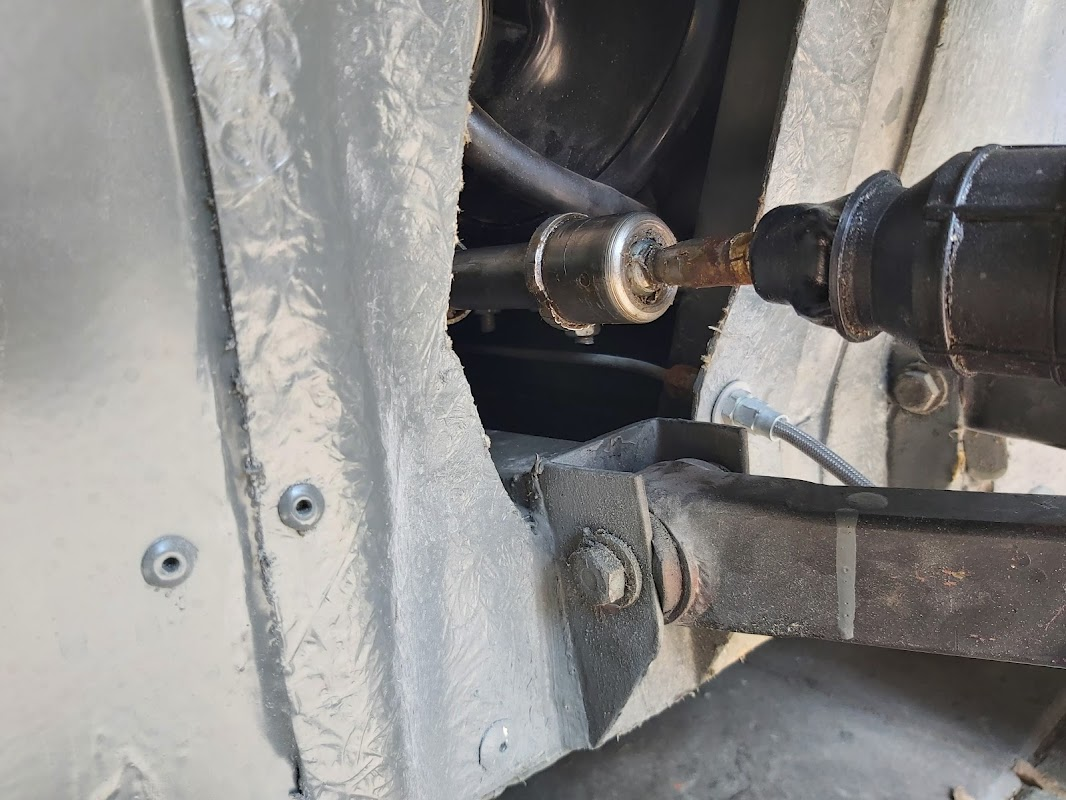

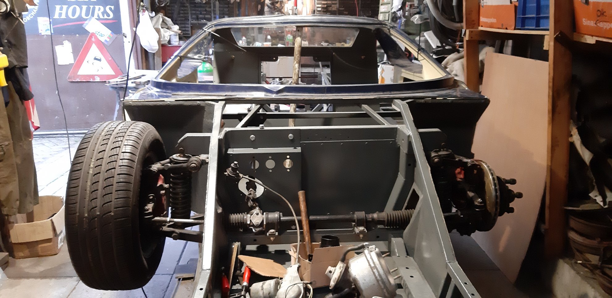

Old pic from before the car was finished,
Pic with a 6mm spacer plate to raise the rack. (not sure why the pic is tilted)

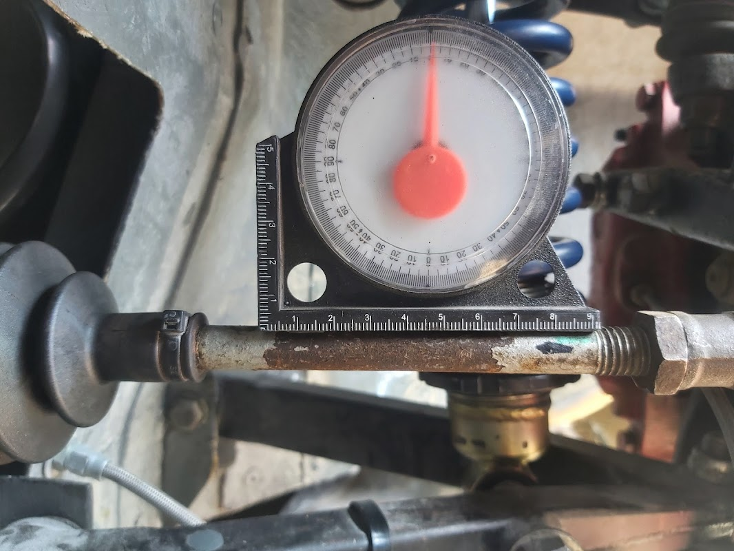

If you draw a line between your inner pivot points, the inner balljoint (on the steeringrack) should be as close as possible to that axis.
Second your trackrod should be parallell to your lower controlarm.
Is it possible that you have swapped sides on the bolted steeringarm on your uprights?
With the two above incorporated you should get a minimum og bumpsteer.

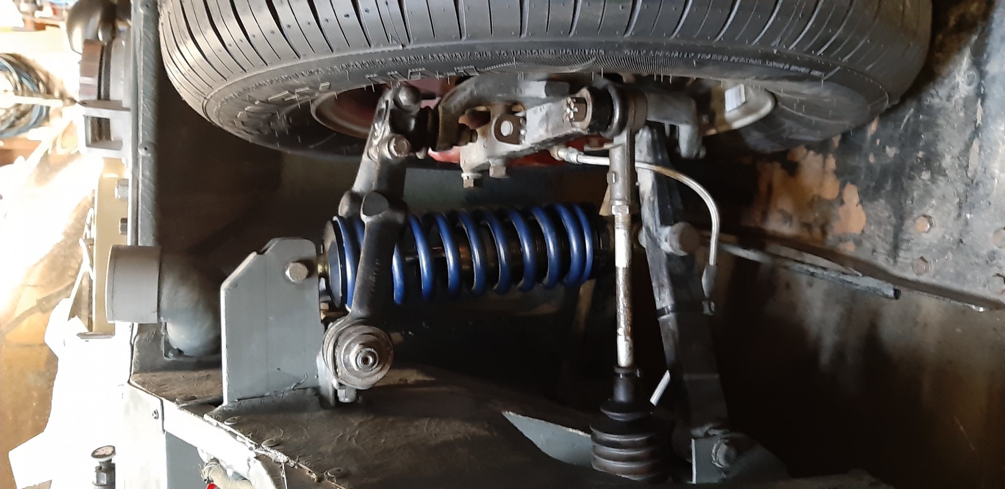

Ah, I remember. I forget as I see so many cars and the ancient grey cells are on the wane. Looking at the pic showing the front suspension from the front I can see why you are having problems. As Ole says the simple way to get the bumpsteer somewhere near is to ensure that the track rod inner pivot point at the rack end sits on the same plane as the 4 wishbone inner pivots. On your suspension the steering arm inner pivot is well inside the plane of the 4 wishbone pivots. Therefore the arc followed by the outer track rod end is quite different to the arc followed by the upright. So the amount moved in or out of the track rod end is different to the amount moved in or out by the upright and hence bumpsteer. As it will be difficult to change the wishbone mounts the best route forward is to change the rack to one which is longer between the steering arm inner pivot points. The steering column does not need to be changed but the connecting links from the steering column to the rack may need to be changed depending on the rack chosen.
It may be possible to get a custom Ford rack made up with the correct length for your needs.
A bit of careful measuring will be needed to get the correct length between the ends of the rack to get the outer pivots in the plane of the inner wishbone ends. I will look up the place that does custom Ford racks so you can ask them if they can make a rack of the correct length for your setup.
Looking at your suspension pic the angle of the wishbones looks a little odd, Usually the upper wishbone is angled upwards at about 10 degrees and the lower wishbone angled down at about 5 degrees. This is done so that in bump/cornering the outer end of the upper wishbone moves inwards and the outer end of the lower wishbone moves outward. The effect of this is to increase the amount of negative camber in bump to counteract the roll of the car. The opposite happens at the other wheel in cornering. To me it looks like the inner mounting of the top wishbone is too high and needs to be lowered to achieve an upward angle. Note that by the wishbone I mean the line between the actual pivots - not the metal bars as the distance between the pivots is the actual effective wishbone.

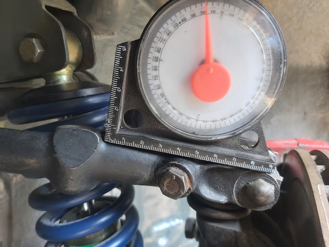

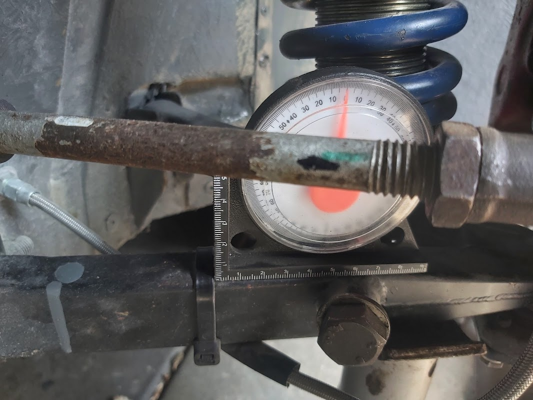

As close as (steering rack in neutral position)
Lower wishbone angle
Trackrod angle, just about 1½ degree out
Upper wishbone angle

Seems to be a lot going on here in the geometry (rack being forward, camber inducing arm geometry, etc). Assuming no change in the inner pivot location of the upper arms, and no change in rack length, It would appear the next change to get one closer to some reductions of bump steer is to raise the rack further upward due to the "abnormal" geometry of the arms. If the lower arm in the photos is perfectly horizontal (0º), and the upper arm is at a downward slope (16º) toward the wheel, then the track rod rod should be also include a downward slope that is in a ratio of it's location vertically between the upper and lower arms (an example would be if the track rod is exactly located vertically between the upper and lower arms, then the angle is a split between the upper and lower arm's angles, or 8º of downward angle of the upper arm being the lower are is horizontal). If it is closer to the lower arm, that downward slope would be less by the ratio of between the upper and lower arm's vertical dimensions. Given the imperfect geometry here, at least that should help. Another way to look at the above explanation, is to draw a line to where the upper and lower arm axis planes intersect (in this case it is outside the wheels instead of the normal inside), and then make the track rod centerline intersect at the same point as the arms do. You will still have other issues, but at least the bump steer will be about as good as you can get given the other issues with this end's geometry.
Terry, your comment is very welcome. It made a lot clear.
I allready thought about reversing the upper wishbone to an upwards slope.
If I understand it correct, what youre telling, If I reverse the upper wishbone so its pointing 16º upwards, the track rod should be at an 8º angle upwards so lowering it back to its original position.
And with the upper wishbone pointing upwards, both wishbones geometric should be as it should.

As the suspension geometry as is will gain positive camber in bump I would suggest that you lower the inner pivot of the top arm to a point which gives an upward slope of about 10 degrees ( currently about 16 degrees down). This will help the camber geometry and will make the angle of the track rod more in line with the wishbone angles. The coilover mount can stay where it is. From your other pics it looks like there is a suitable frame member inside the wheel arch panel to mount the inner wishbone mount firmly in the new lower location. If you make the bracket adjustable or so you can use shims this will allow you to adjust the static camber to about 0.5 degree negative as a starting point.
Once this is done (1) follow Terry's suggestion of making the track rod angle a proportion of the wishbone angles. And (2) change the rack length so that the track rod swivel is on the same plane as the inner wishbone pivots.
1651666427173-png.122515
Is the suspension loaded in this photo? Looking outward from the chassis pivot, the top arm should point upward (at least slightly) at nominal ride height. Lowering the inner pivots would be a good place to start. You could probably benefit significantly from a bit of reworking.
The other consideration is that you can't just lay an angle finder on the wishbone unless the ball joints and pivot points are all co-planar with (or parallel to the plane of) the axis of the suspension arms. The true angle is found by using the pivot points themselves, which can be displaced significantly from where the actual A-arm hardware is located. Your actual measurements may be close, but different.
