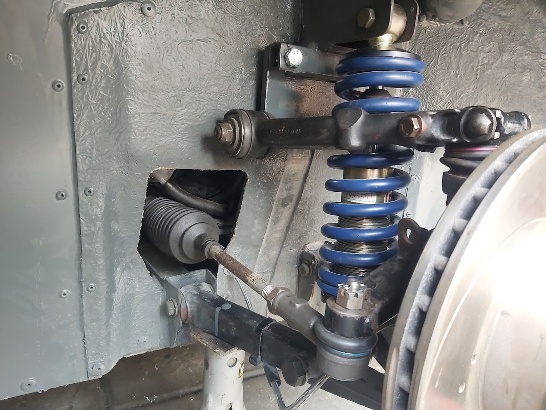

Some more measuring today using a digital angle finder, to find out what effect raising the steering rack has. Raised it another 7mm, to find out that the trackrod angle just changed 0.5º. The get the required 8º track rod angle Ill need to raise the rack another 4cm or extend the ball joints with 4cm.
I don't fancy. going the uniball route. So repositioning the upper wishbone is the route to go.

Please don't take the 8º noted in my previous post as a solid number. It was more an example from using the photos in this string, plus assuming the rack's joints were positioned exactly midway vertically between the upper and lower arm pivot points. You'll need to determine exactly what that value should be through careful measurements. And once you change the mounting locations for the upper arms, that will all have to be remeasured and calculated all over again. Just a word of caution. You can't change one thing without considering all the other things that will be changed as well.
Terry, don't worry. 8º is just a guideline. Ill measure things twice and check every change in settings with laser to make it insightfull. Small steps are easyer to go back.
Just purchased a couple of uniball's to make an expirimental adjustable tie rod drop kit. Just to make a test setting to see how much degree drop of the trackrod is actualy needed to eliminate bumpsteer. To make it insightfull.
Problem solved.
I made a bolt on thick steel adapter bracket to lower the upper wishbone to correct the suspension geometrics which also made it possible to set camber settings to GT40 specs. Bumpsteer gone, fabulous to drive now.

Getting closer!! But...I'd like to offer one more suggestion on this (unless this is solely a temporary mock-up). The (what I would call) cantilevered mounting off the 1" square tubing (which is unfortunately already distorted or compressed by the bolts, from what I can tell in the photo) concerns me...a lot. Lateral and braking forces, I feel, will eventually result in an unsafe or failed upper suspension component because of this. May I suggest at minimum some gusseting between the new thick vertical mounting plate, and the vertically oriented steel upper shock mount material. Yeah, the 3/8" (?) plate is robust, but high lateral forces could play havoc on the way it is mounted.
Davidmgbv8
I agree with Terry, that is great for mock up and testing and confirming the theory around the block once or twice but you really should have someone fab up a better mount with gussets to the top shock mount and tie in behind the plate to the chassis somewhere to stabilize the back of the plate where the new mount point is.
Chris Kouba
Why bother with the bolts at all? If the geometry is satisfactory as-is, use them to hold in place and weld in a properly triangulated/reinforced mount. The plate you have there will wreak havoc as predicted, specifically those bolts without crush tubes will see the "square" tube looking less and less square as you start to enjoy your vehicle's new-found capabilities.
See if you can tie it into the lower A-arm inboard mounts too.
Neil
In Costin & Phipps book, they point out that the loads on the upper a-arm are much lower than on the lower one. A sleeve through a tube will allow you to tighten a through bolt without squeezing the tube flat. It's just good practice.
