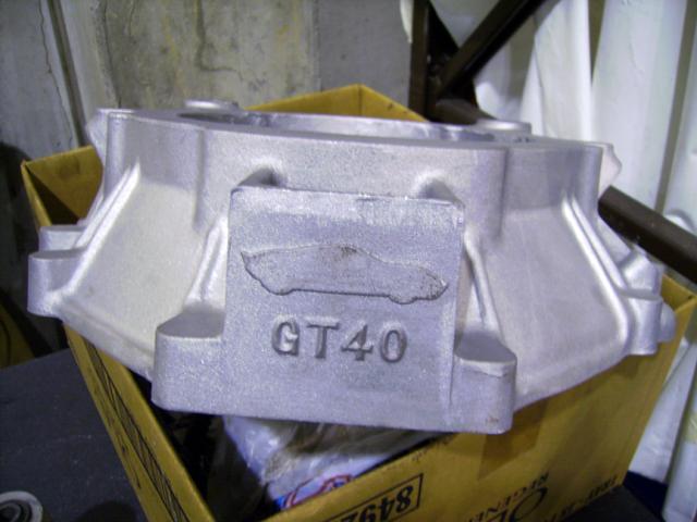

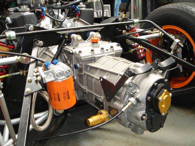

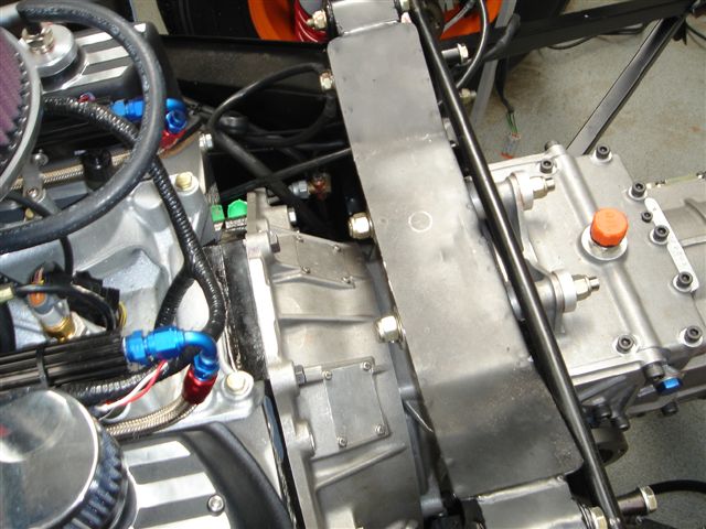

Don't have Bob Woods contact, but I think it's on a post up in the transaxle forum. I believe Olthof uses Quick Time's steel bellhousing. Quick Time is U.S. made and have their own website. I've got one on my SPF. It may be slightly heavier than an aluminum one, but is smaller in diameter. It has the nice advantage of being able to unbolt the transaxle without removing the bellhousing from the engine.
Everything you need to know can be found in this thread:
http://www.gt40s.com/forum/superfor...-mki-bellhousings-all-other-little-stuff.html
Including photos, and all of Bob's contact info. IMHO his setup is the only way to go. :thumbsup:

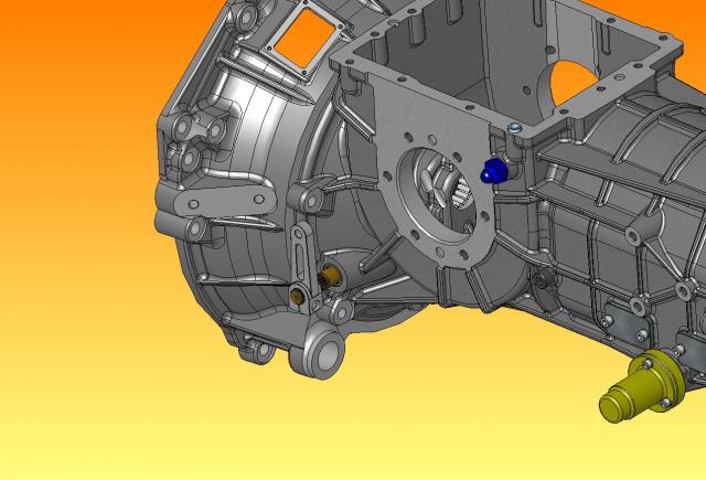

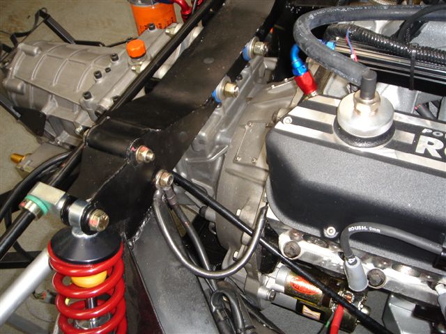

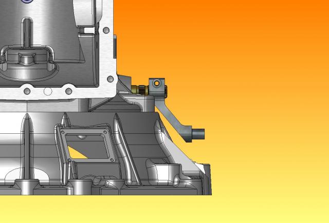

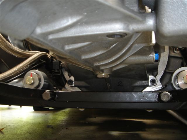

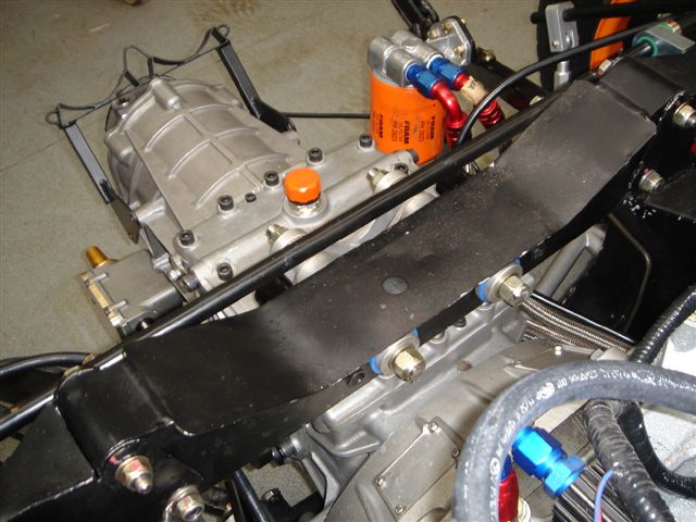

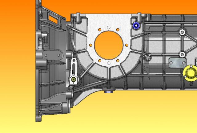

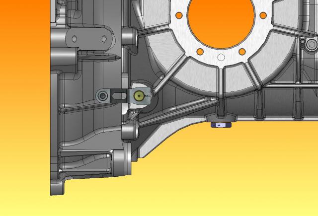

Hi Mike
The ZFQ bellhousing does not protrude below the chassis and takes the full 157 tooth flywheel and original GT40 slave cylinder.
Regards
Chris.
Hi Mike
Regards
Chris.
