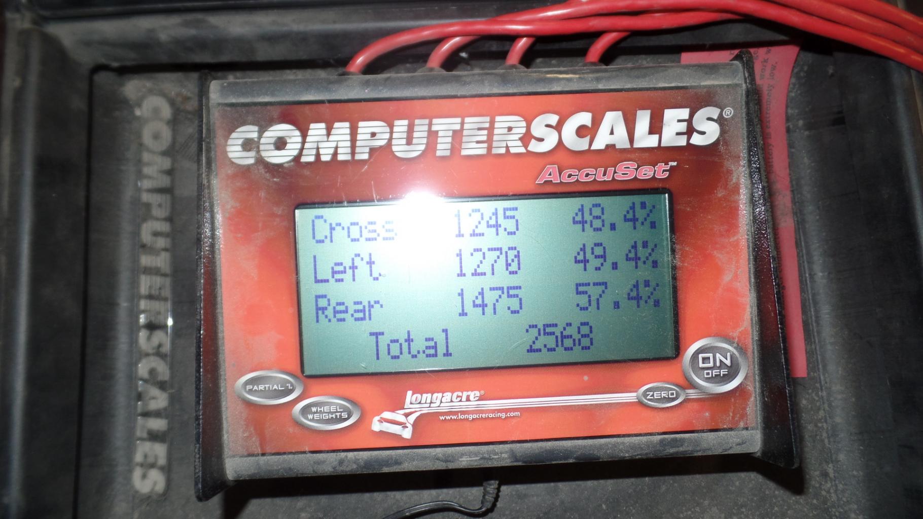

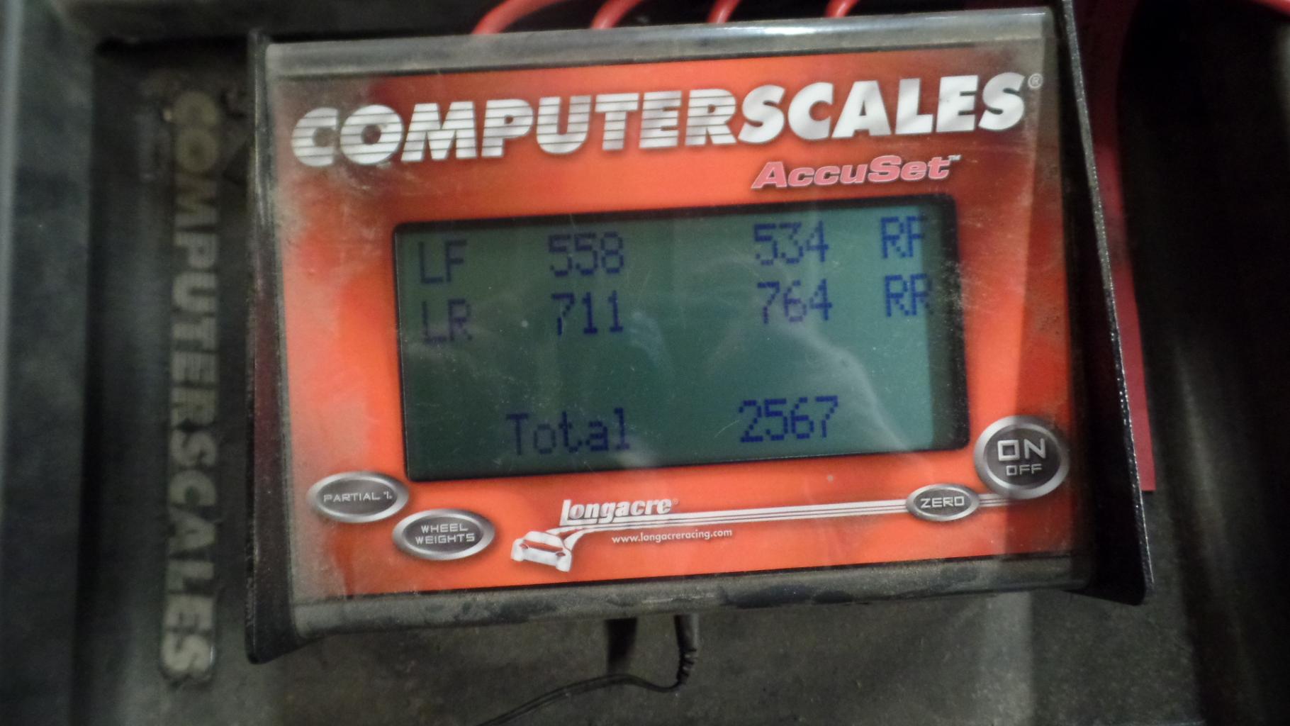

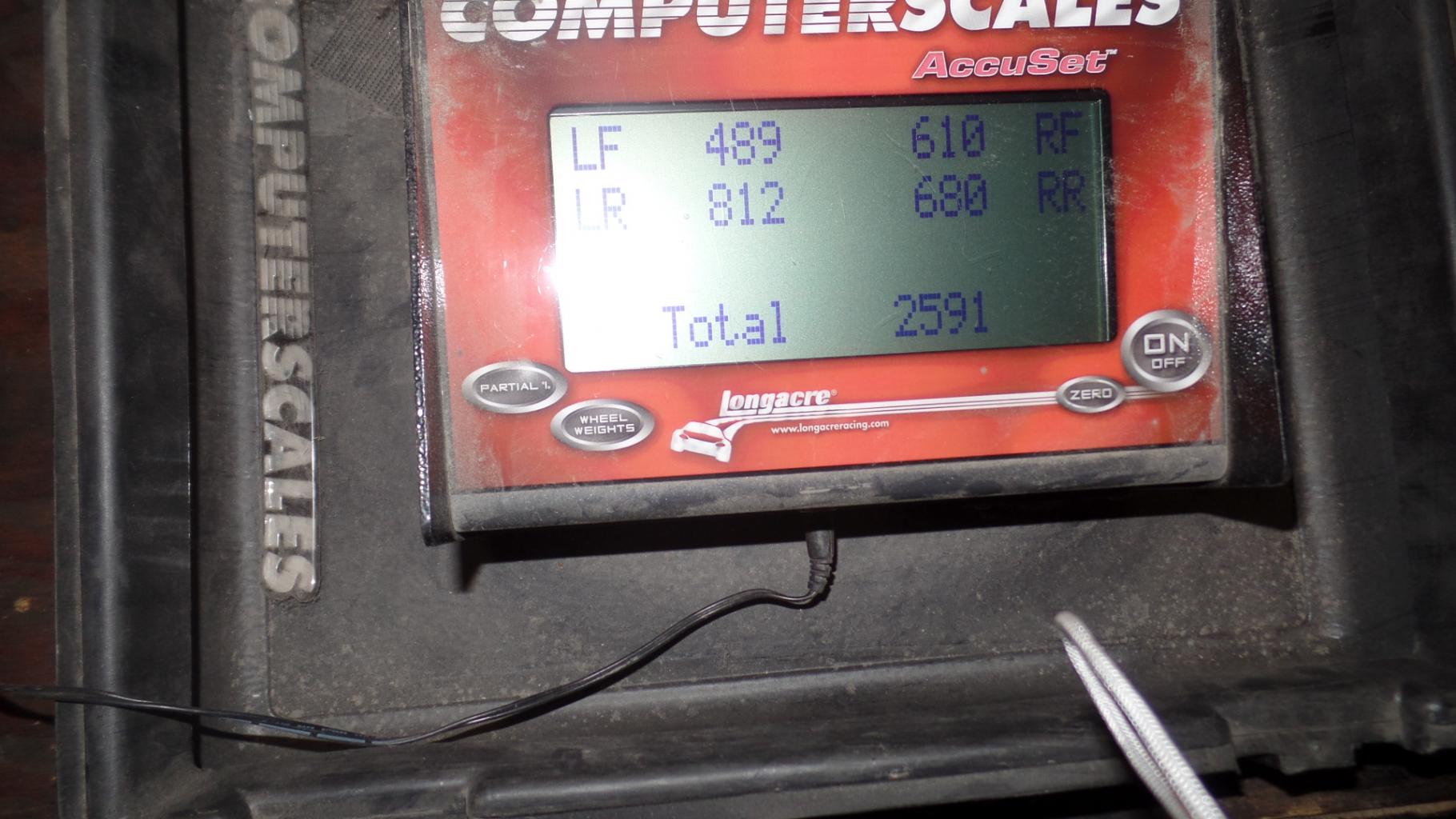

Here are the weights of my rotary engine SLC.

Garry that weight is funny as close to my MR2V6 track car. Was that without driver? What did you get with driver, just curious? I spend 3 hours doing the alignment and corner balancing my race car to get it just right, but feels good when done.
FR 551 FL 543
LR 699 RR 691
2483 total
When I sit in the car its within 15 lbs from LR to RR same on the front.
But when I first weighed it, one side to the other was a couple hundred pounds before I adjusted the coils.
I can't stress this enough for any FIRST time builders out there! As Gary has just pointed out, with a full adjustable suspension be it a race car or street car a CORNER BALANCING is nearly imperative to good results.
My first tube chassis car measured straight and square. But whenever I got on the throttle it would pull. To the point as an inexperienced driver at the time, I thought something was broke. Someone asked about corner balance.....I bought scales to see just how crazy things were. In the end, I ended up putting a little pre-load in her across the opposite diagonal to counter the 820hp and she drives straight as an arrow.
Pre-load can not always be easily seen with the naked eye.
No not a typo. I had to questions their scales and they showed me a hunter calibration. I think you put the nail on the head, drivertrain/transaxle. Ive got the ls376 with the heavy ricardo. I've heard the ricardo is designed to move weight forward of the rear axle helping balance the car. So fewer GT40's went off the road due to lift throttle oversteer. I did see a big differnce in control when they helped me corner balance the shocks.
Tires did make a differnce in recorded g-force on track days. The best i got was on pirelli p-zero corsa's at 1.46g. But nitto nt05's hit 1.44g for half the $. plus they wear better IMHO. I've not had slicks on it yet and i'm no "Ryan Ellis". hehe
