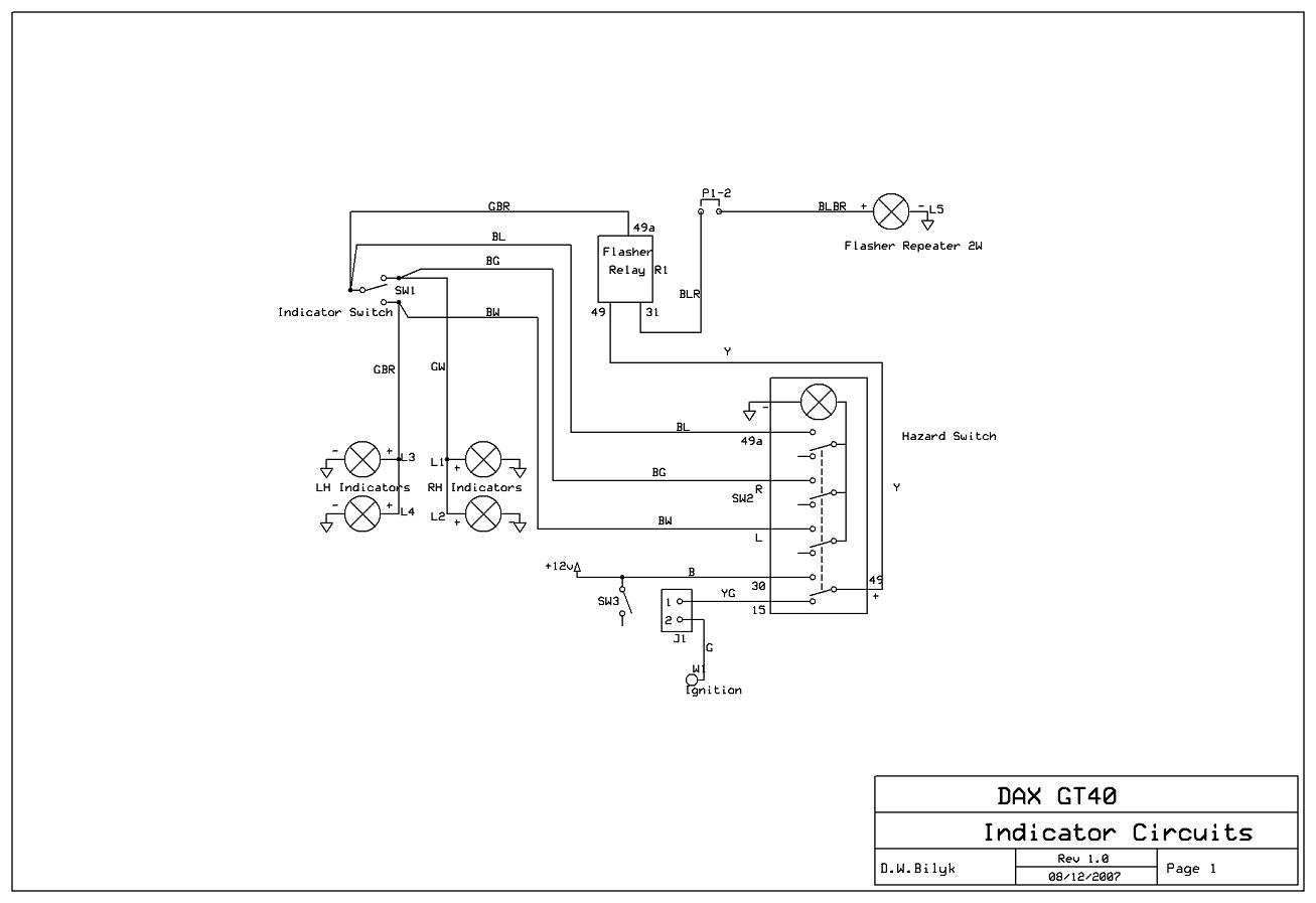

Dave Bilyk
Dave Bilyk
I used the Express SCH software from a company that does pcb's. Not fancy, monochrome but purpose designed so it worked for me, you can also construct your own symbols and save them within it's database.
Express SCH
Attached pic gives example (had to reduce it so quality is not as good as the actual).
Dave

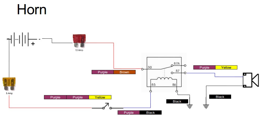

Hi Renato
I'm planning to use LibreOffice / OpenOffice Draw, which is a bit like Visio. It's not a dedicated wiring programme, but can be used to show what you need it to...

Hi Renato
I've never used that software, but have used Visio and OrCad..
BTW, let me know how that horn works.. :lipsrsealed:
