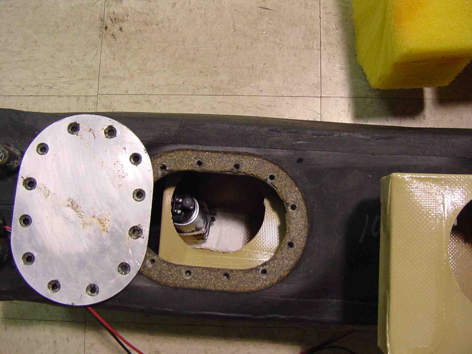

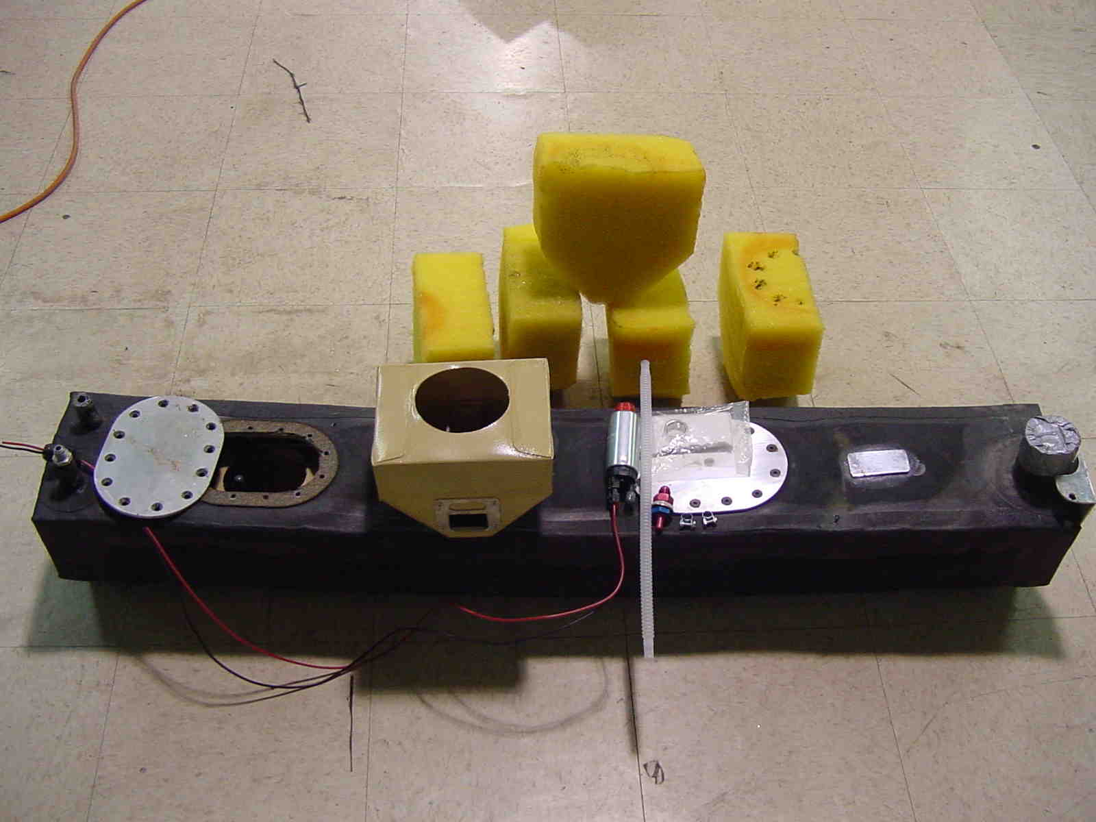

With the recent posts by Veek and others about the CAV fuel cells, I thought some members might be interested in the submerged swirlpot/surge tanks with fuel pumps and filters that I fitted into my CAV cells.
The flexible swirlpot with a one way gate is made out of cell material and colapses into the fuelcell. The submersible fuel pump with filter mounts into the swirl pot. The plastic fuel line makes the conection inside the cell from the top of the submerged pump to the underside of the hard line going through the cell to feed the injection.
The electrical lines go through a special fitting that is machined into one of the access plates in a location that will not foul with cross members.
