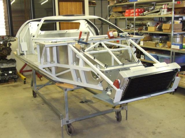

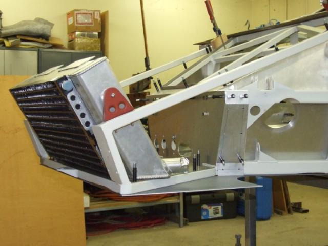

The 12" will fit with a slight mod.
As I'm in Darwin, I wanted the biggest condenser possible........
Clayton
