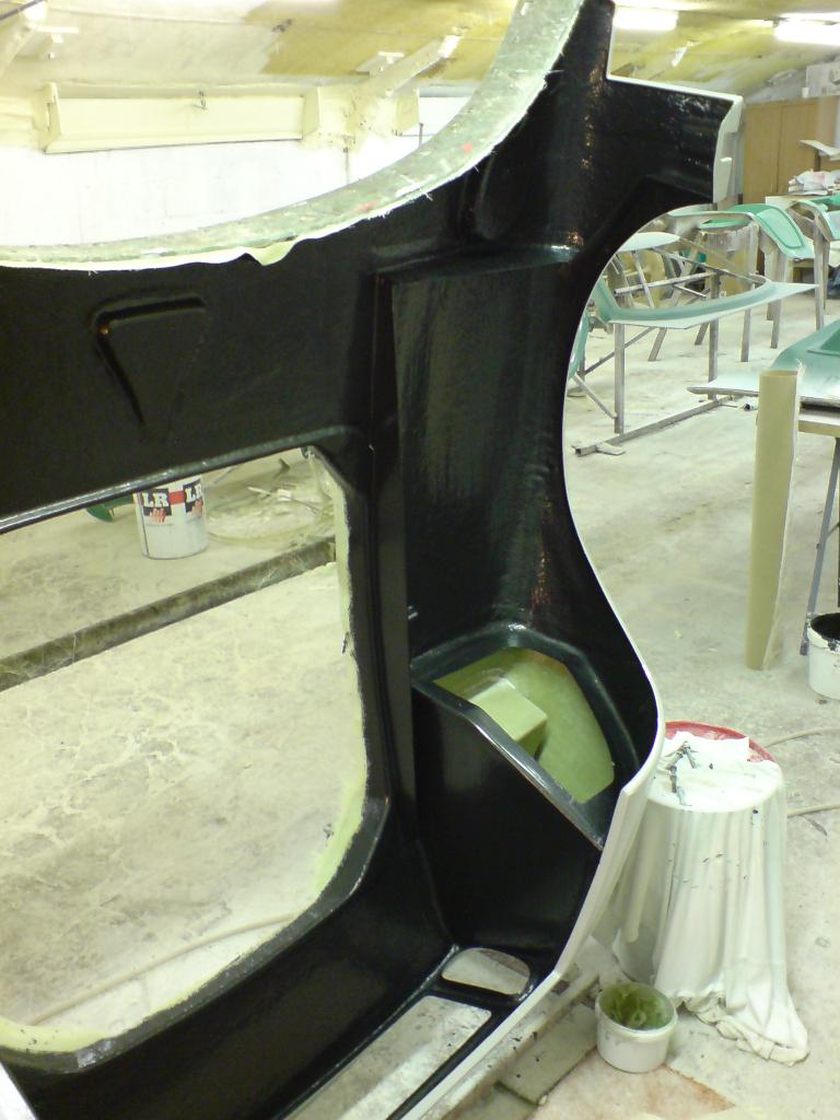

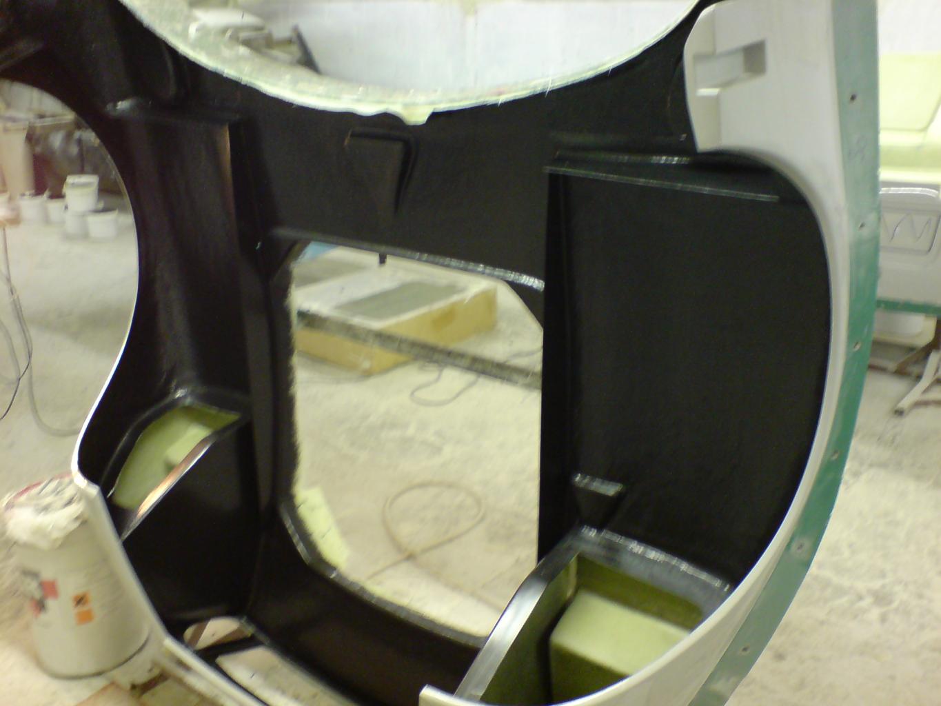

How difficult is the adjustment and fitting of the body on these cars - the SGT40 in particular? Are all body parts "rough cut" and need final trimming from the builder?
How is the clips attached to hinges and latches? Anyone have any good photos?
I would really appreciate some photos showing how the inside of the clips are made/finished, arches, double panels, vents etc or just a single layer of "open" matting?

hello Jostein. i manufacture the body panels for Southern GT, and answering your questions, the body panels are supplied trimmed and finished and if not double skinned, finished with a black gelwash. the rear clip has an internal fit out panel which acts as closures for the wheel arches and a double skin lining of the rear deck. Lee
