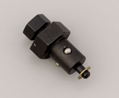

Summit has earls beaders for 1 1/4" pipe for about 65 bucks.
