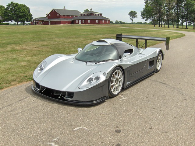

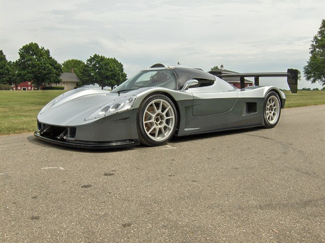

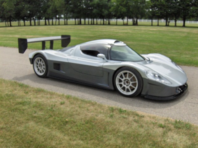

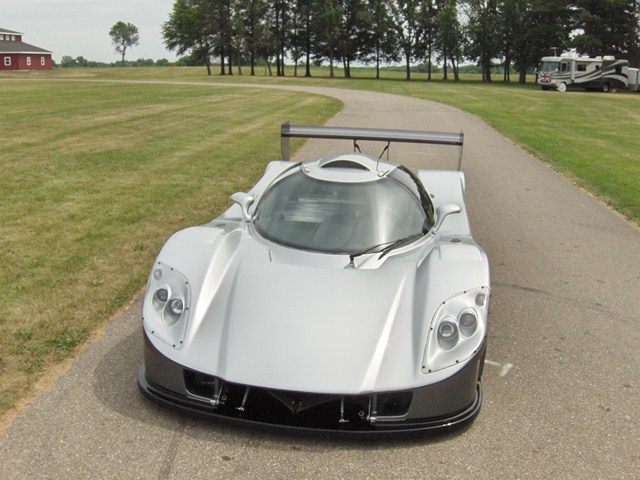

Just received some pictures from another happy SLC owner.

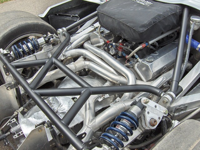

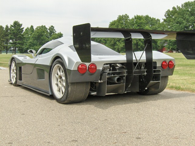

This car has a Chevrolet race engine with 8 stack injection and a Porsche G50/52 transaxle...and a cross over exhaust
We made the rear window from a mesh screen so the intake can breathe directly through it..with our Carbon race rear wing and front splitter too.
Its primarily been a trackday car so far.....and a nice looking one at that....I dont know if its going to see much street use, now its all shiny and painted...:thumbsup:

was this a customer build or was alot of the work done by professional car builder? what was the approx build time? car looks absolutley amazing, nice work!
Damn, that two-tone looks better than I imagined it would and I already thought the cars line were a natural fit for it.
Wherabouts is this one located?
Is this the formerly Black Gel Coat 410 sprint car engined car?
Looks nice Fran - I'm sure it helps many visualize what a Silver car will look like. Since many are contemplating Silver as part of their color choice.

I dig the tri-Y crossover exhaust....does it have the same tone as an equal length "bundle-of-snakes" exhaust?

Fran, I noticed the more angled pinion in the rocker for the rear shock.
Is that standard now and is it just for a more parallel load path for the pushrod or is there something else to it?
The angle is exactly the same...
the upper chassis tube on all of the cars after chassis #5 was rotated to remove the angled mount...ease of manufacture dictated this...

Doug, this is a set of true 180 degree headers, so the tone is unique.
Howard, sorry, but there are an amazing number of different silver colors available. This is painted in Reflex silver and Platinum grey with black accents on the splitter and sides. I used carbon fiber for the wing supports as well.
I have to say the car is just amazing on the track.

Dan, nice to "meet" you. I saw your car when I was at RCR the first time. It was sort of the inspiration for my SBC/G50 SLC. So how loud is it? Do you think the cross over has reduced the noise level any? Have you ever had a DB meter at the track give you a reading. I would love to run my car at Laguna Seca some day but they are the very tight on noise level there.
Anyway, if I can get it down to 100 DB that would be a good start. Didn't your car have a 4 into 1- H pipe style exaust on it at the beginning? If so how did that work out for you? Buy the way do you still have that old exaust system? I might be worng on this, I have looked at a lot of exaust systems.
Thanks for the clarification Fran, I didn't know this was an earlier chassis. I was a little confused because I couldn't see any advantage in rotating the pivot axis on the rocker as it is already very close to perpindicular with the pushrod.
