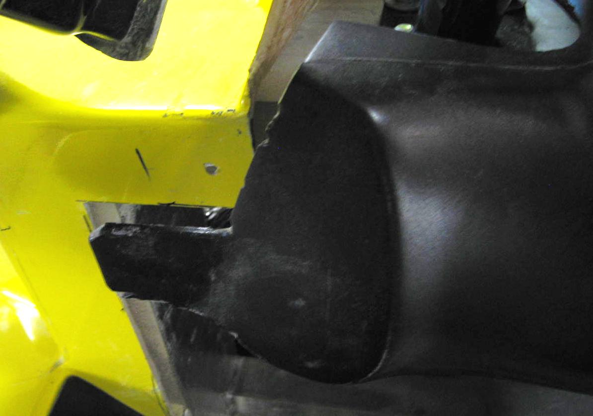

I simply bolted it to the body. I glued a 1/4-20 click-bond fastener to the back of each ear on the dash, and drilled a hole in the body to match.
Its plenty solid.
