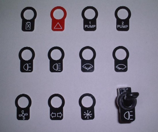

I had a company called Aircraft Engravers make me some adhesive backed panels for my RCR GT40. Here is what they made for me:
Bill D
Bill,
Looks nice! Are these plates made of plastic or aluminum? Either way, I think I could adapt them to my set up.
Thanks!
Tom
Bill,
It looks like you made up the plate (drilled holes for the switches ect), then sprayed the surface we see, then sent it off to AE......???? That way, they knew where to scribe the marks.....????
Actually, I made a dimensional drawing with where the holes go and what markings I wanted. They then made the labels just as you see them. They come adhesive backed. I glued them to the aluminum panels made for the dash. They are .060 plastic (2 layers - under is white, top is matte black)
I sell these labels.
They fit under the top ring.
This is an old pic and I have made some changes but it gives you the idea.
13 in a set.
Comes with labels for lamps as well.
Jim

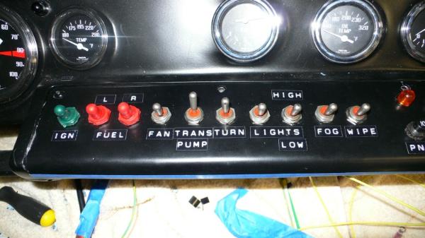

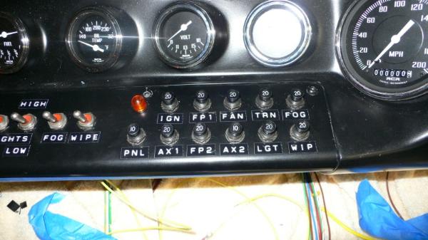

Sandy
Gulf GT40
Tom if lazy you can go the Dymo lable route. You can find the machines and tape on ebay. Sorta' looks cool. BillD's plates are really nice too, just too lazy to do the drawings to make them. The Dymo lables look very vintage too.

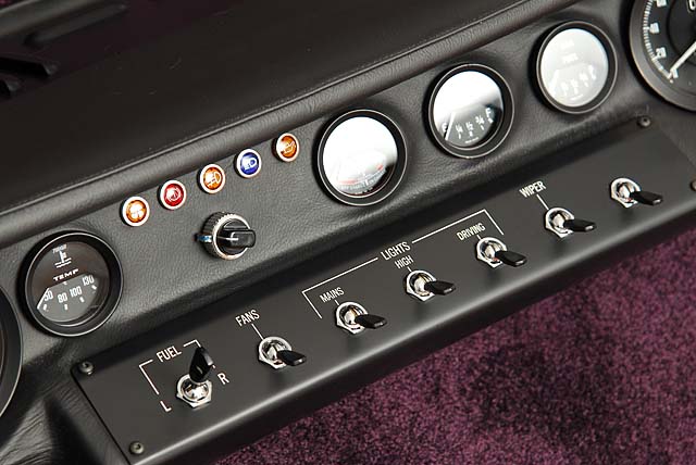

Tom, you may find the crinkle paint gets hard to keep clean as although glue won't stick, dust and dirt will, and will be a bugger to get off.

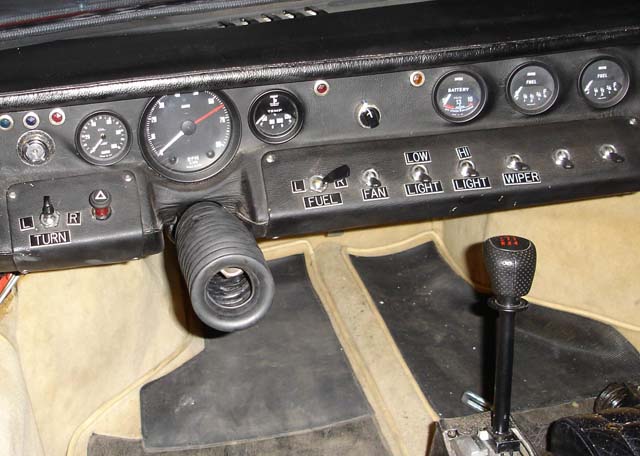

If you are set on that route, what WILL work is to screen-print the label graphics onto the panel. It will require a decent quality screen-printer and this will not be your cheapest route, but it does produce what I think is a fairly "factory" result. And, no, my car does not have purple carpet. That's my basement floor.
Mark

Mark:
Impressive dash! The before and after are rather dramatic. How difficult was the application of the leather?
Chuck

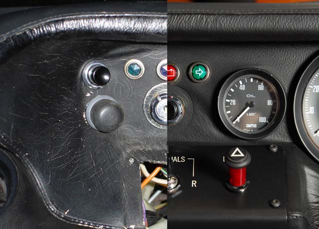

Mark Charlton
Thanks Chuck,
The leather was applied by GTD back in 1987. All I did was a strip and re-dye. I am very pleased with the results, as the original dash was dyed tan by GTD and later was over-coated with black. The original dye was lacquer-based, was cracking badly and had been poorly touched-up over the years. The leather itself was in quite good condition and still supple.
I had the refinisher really matte down the dye before applying it and it looks almost identical the the sheen of my seats after I had them re-covered with new leather.

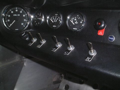

Here is what I did on mine. A guy from the ffcobra forum had them made to my spec (size, center hole, and lable):
