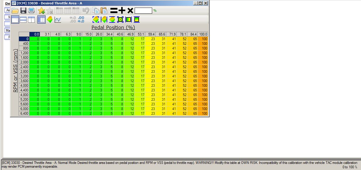

FWIW, if you have hp tuners your throttle area A map (engine->air flow -> electronic throttle -> Map A) should look liek the below - all the gmpp tunes i've seen are always the same .... note the warning at the bottom of the screen - i.e., if you adjust this you can brick the PCM
The area rate limit opening rate can be changed w/o any issues though

This is great. The first or even second tuner I had did not keep the stock tune. Can I then presume that the LS3 480 or the 525 all use this table?
Alex
Yes, that's the stock throttle map table. If you want you can send me your tune - I don't have the stock tune either but I remember enough to know what tables have been changed

I compared the table you sent above #7 to the actual table in my tune and they are not the same. So once I get a new ECU I will take a look at the GM tables. Now I am suspicious that one of the tuners did make some changes. IAW the HP tuner blog, folks are changing this table all the time with no issues...….now am I that unlucky.
