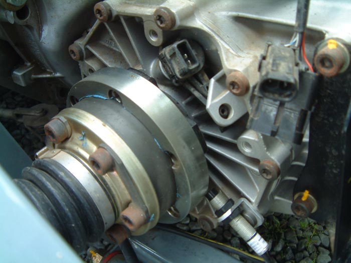

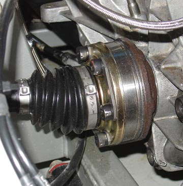

Do these help? I assume you have the Audi gearbox? The inner bolts and the outer bolts are different - one is fine thread and one is coarse. You can see I drilled them for safety wire but have not yet installed them. Do you need lengths on the bolts?

thanks.
I have the audi A 8 box and the fitting is similar .The only difference is an adaptor plate which doesnt appear in your photos. The adaptor plate fits between the box and cv joint .The bolts that hold this on are the ones that are giving me grief.
the photos are good and helpful

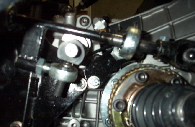

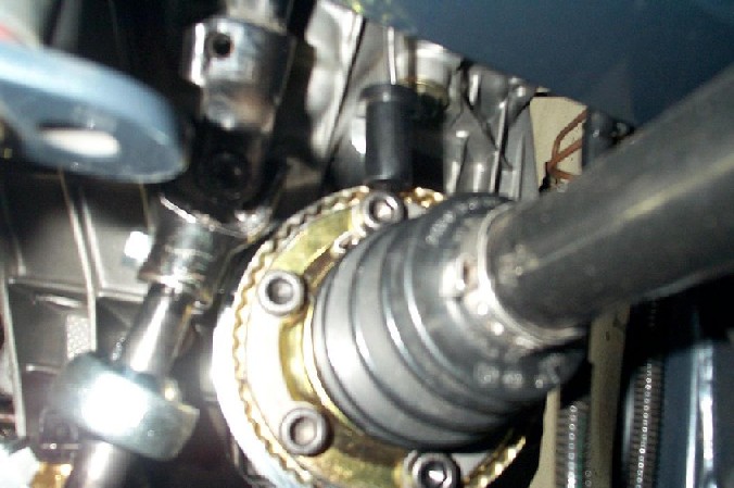

Here is a shot that I think you need.
Regards

1 more

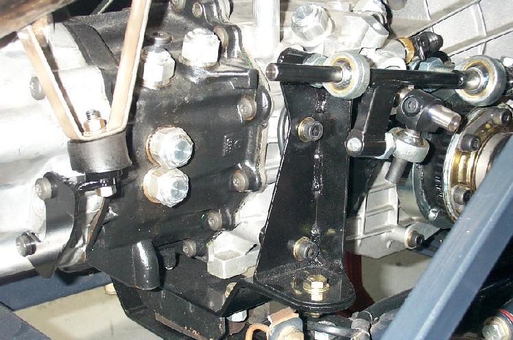

Here is another shot of an RF 6 speed

spot on!
my bolts are off to the lathe.
have just got to sort a gearbox clearance issue with the left chasis rail ,looking at you photo its a matter of 3-4mm,currently mine makes contact.
thank you for the photo.

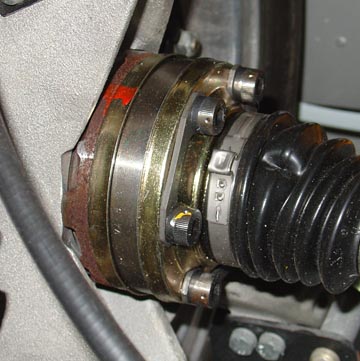

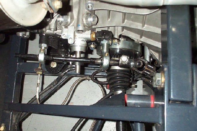

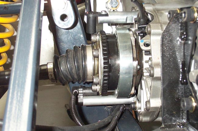

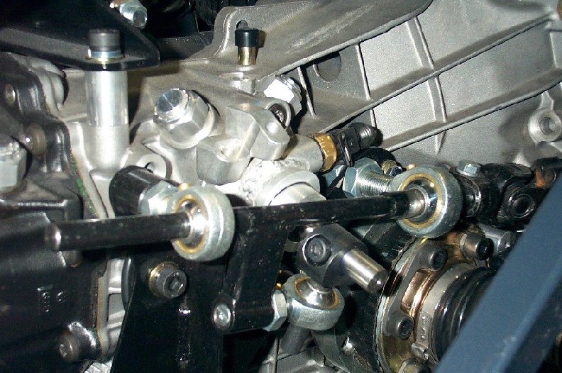

a few more for you
How are these Huw?
