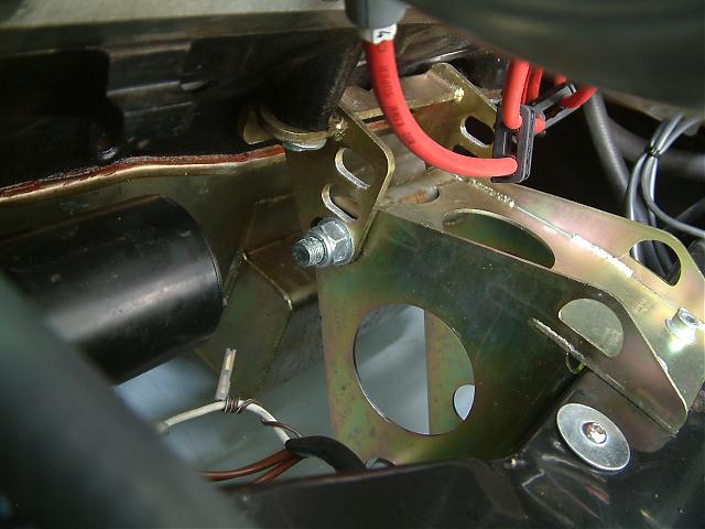

Here's how my mounts turned out after using Casey's suggested fix. The upper RH is a bit chewed up as the poly is really hard to chop without cutting off one of your fingers. My reinforcements to the platform look rough in the pics but they're OK in person boomsmile
Quite frankly, I didn't see that much of a difference from when I reinforced the platform. Welding in square inserts showed a major improvement after the platform had broken from all the torque and shuddering. Granted, I really haven't driven the car any distance; maybe a mile or so to gas up. The weather's just been too dreary for me.:)

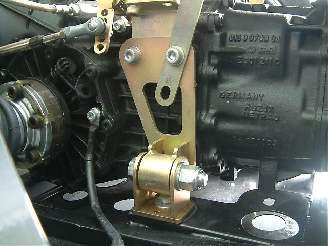

Hi Guys
I have tried many times to post these, so here goes..( again)
Thanks for the pics, Jean.
Those motor and tranny mounts certainly look the bit. Just to make sure before I place my order, do the motor mounts bolt on directly to existing holes in the chassis (pre-100 car)?
Race day pic looks awesome!
Hi Ray
Yes they do, but you would need to drill the top two holes into the pre-100 chassis. A threaded plate is supplied, which fits inside the chassis from underneath.
MUCH stronger than 'old' CAV mount.
Jean
