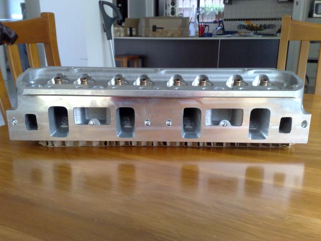

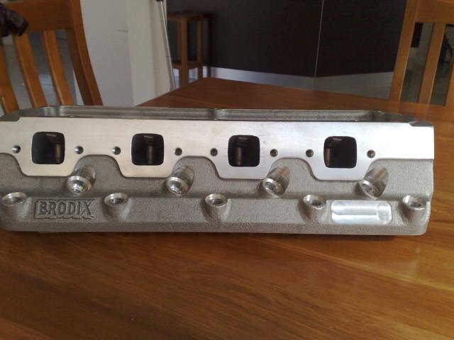

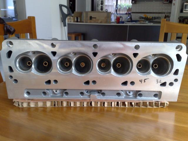

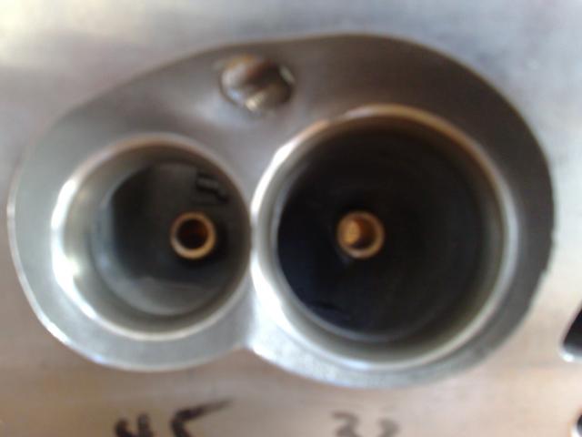

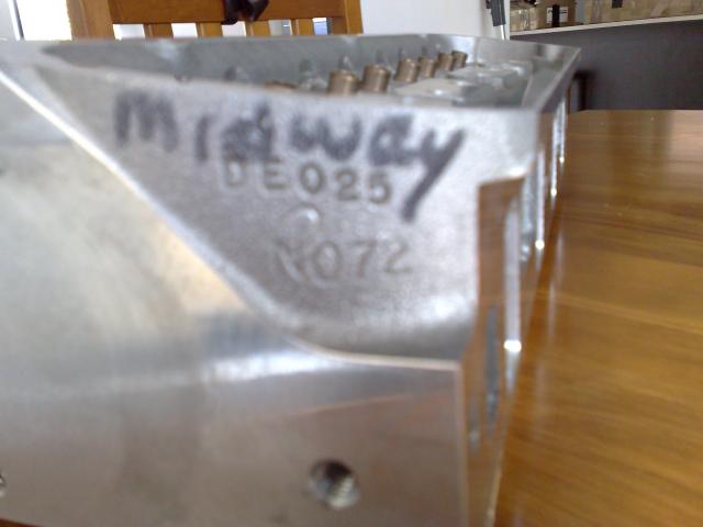

Heads are Brodix T1F -X as far as I know. They came as part of some other stuff I bought on Trademe in NZ. Pics attached. I am intrigued by the word DIRT cast into all of the ports ???
As yet they are uncut
I was planning on port aligning / cleanup without too much increase in size. Polish chambers and then set Compression ratio.

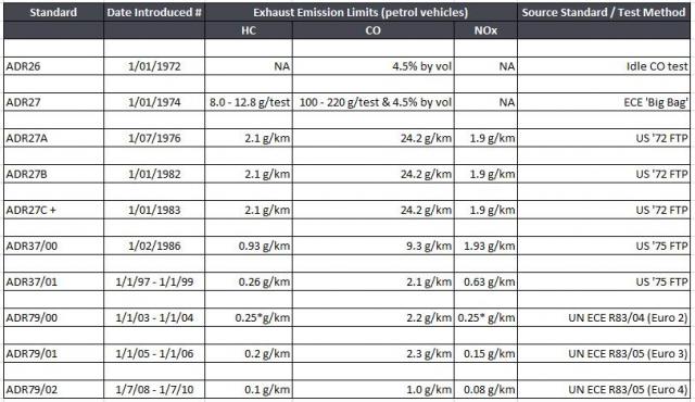

Kevin,
I am in a similar position, intending to fit a 351W. Locally we are required to comply with IM240, a set of measurements for the various output gases. The test is performed in NSW, for free!!!
Normally a 351 would not have an icicles hope in hell of coming close to complying, but I am advised that by using a Zero overlap cam, and modern programable computing systems, with state of the art catalytic converter, and very accurate exhaust gas sensors, a pass is probable. It was only on this advice that I restarted work on my car.

Your heads are Brodix "Spec" heads, built for a particular oval track sanctioning body, the word "SPEC" would have been cast into the head but has been machined off in the bottom right corner.
Worth pointing out that you have the "N" style exhaust ports and a conventional style header flange will not fit, you need something with a wider bolt spread.

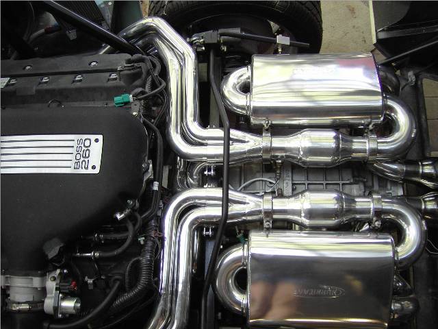

Hi Kevin
Cats on the exhaust of a 40 don't necessarily have to look bad if done correctly.
In NSW they are a required evil and as such you have to make them look as good as possible.
IMHO the way I did mine doesn't look too bad.
Dimi

no state mandates that a vehicle must have catalytic convertors. What is mandated is an emission standard. Using Cats is one method to achieve that emission standard. There are engines around that dont need cats.
In NSW an ICV is required to meet the IM 240 test 37/01 limits.

Hi Dimi,
It is difficult without Cats, however they are not compuslory. Using Cats is currently the cost effective method adopted by the majority.

Dimi
Yes your cats look OK What brand are they and who is the agent ??
