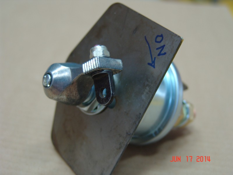

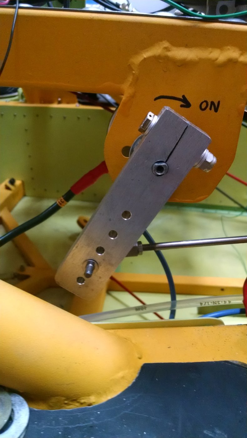

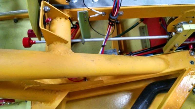

It is a good idea to have your battery switch also accessible from the outside of the car and have its location clearly marked. This way rescue workers or even spectators will know where the switch is located. A cockpit switch is handy for the driver or passenger but others may not know there is a battery cut- switch inside the car.
I used a Moroso high current switch but I finally removed and discarded the original switch knob and fabricated an aluminum arm that fits on the switch shaft. There is a push rod that extends to the nose of the car and one that extends into the cockpit. This way the battery can be switched on or off from either place.
