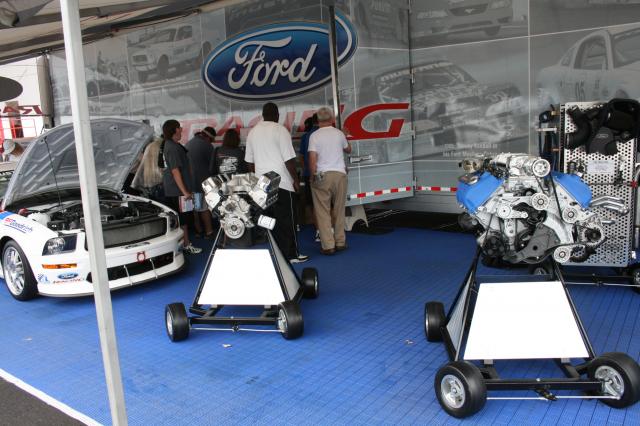

That would have been my choice for engines but it would not fit without really hacking the SPF tub to make it fit. I gave up on that engine combo idea and went with Dart aluminum 351 block bored to 427. But I have heard that you can order your SPF tub for the modular ford motor. If I had it to do all over again that would be what I would do. I really like the modular motor.
Here is a picture of the two, till you see them side by side its hard to imagine the difference.
