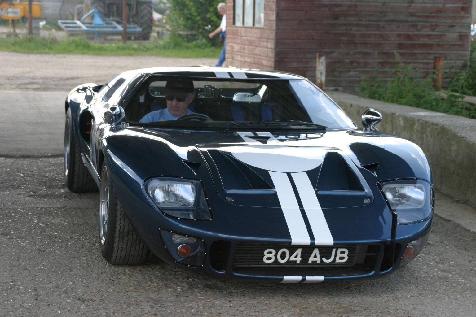

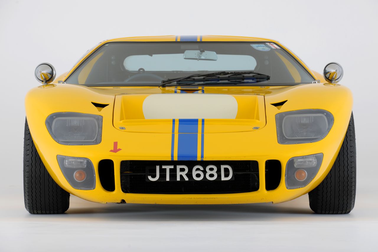

Graham, Frank's photos are correct. Photos of the original P1013 press car as well as other Mk I's of the era show that style of open letters in the intake grill.
Hi Frank,
thanks for posting, it's much neater than having a stick-on front plate

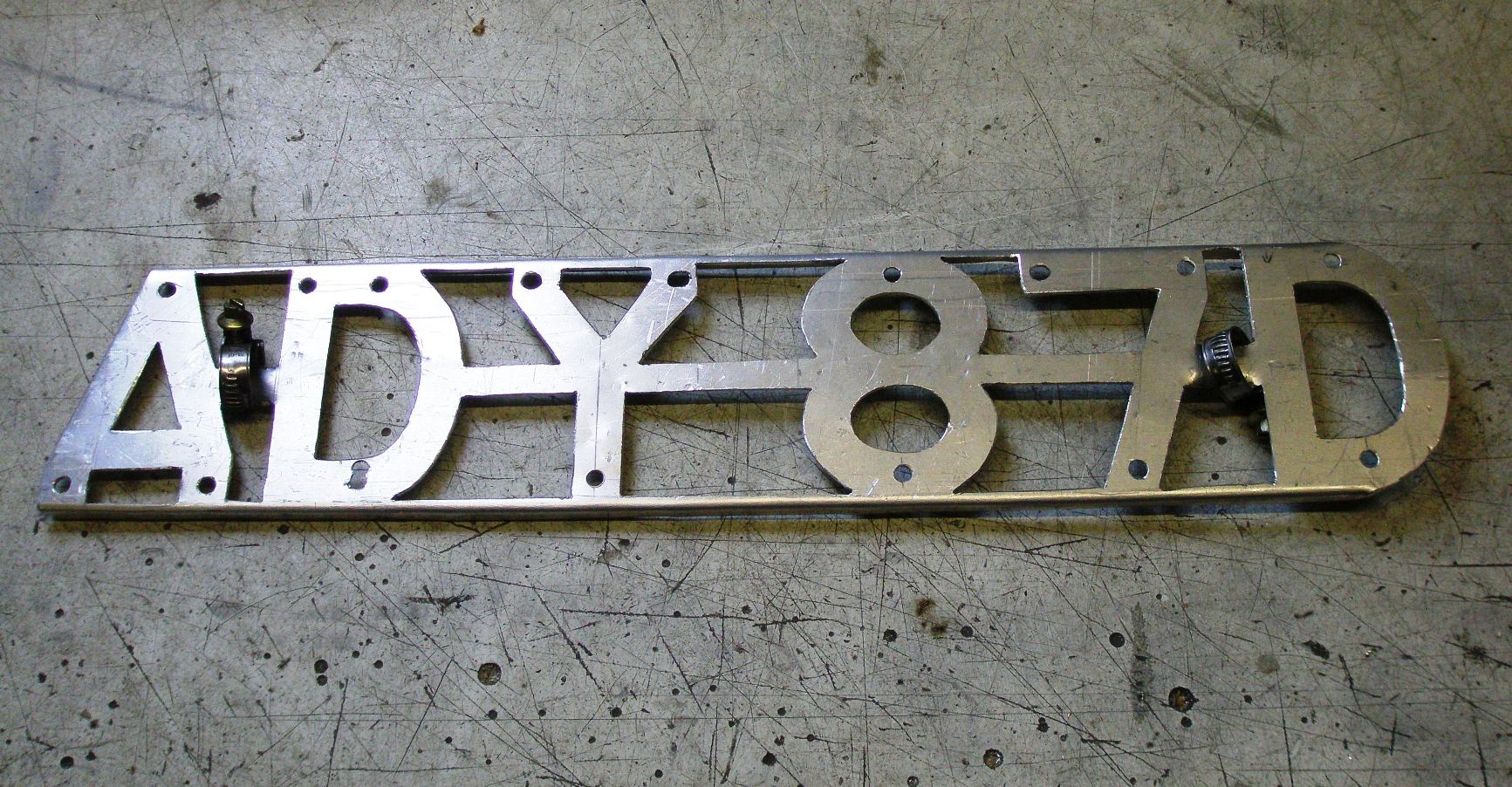

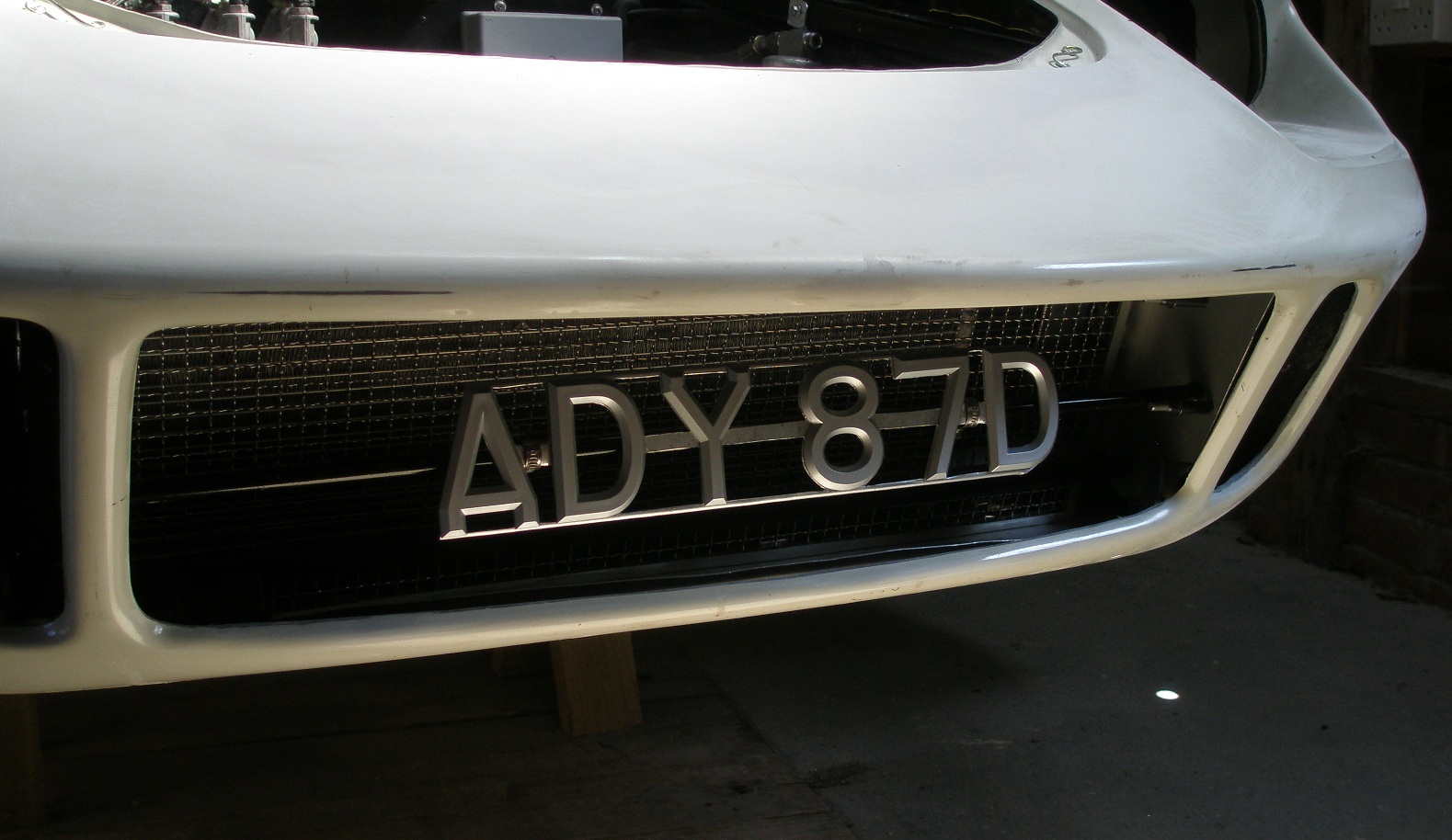

Graham,
attached is how I've mounted my letters - the frame & clips have yet to be painted black. Get your jigsaw out!
Andy

Hi Graham,
I purchased the individual period cast aluminium digits from Tippers Plates and mounted them with star washers on to the fine mesh radiator grill. They've remained there since 2003 and do the job simply and neatly!
Chris
