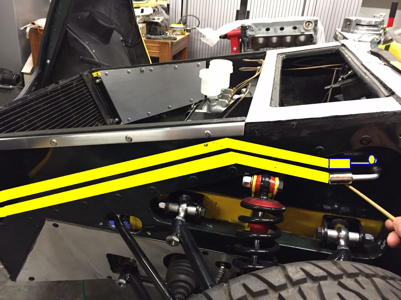

After lot of head scratching, I was first considering to route the hoses through the sidewall just behind the radiator. This was a possible solution but the area of the steering rack together with brake pipe and coolant pipe made me think of another solution.
Attached you can see my current plan.
I will now go direct to the wheel arch area and route the pipes along the nose. Downside is the pipes are now more exposed to stonechips and the elements but it is much easier with routing and passing walls.
Has anyone also done this before, passing the outside ?
Planning to make a kind of covering over the hose to protect them.

Only thing I can think of is it may foul on the front tyre when it is on full lock
You could always cover them in an aluminium cover to protect from stone chips
Hi Ian,
No issue with wheels, they can turn left and right and still plenty of room.
The hose separators and cover plate will be a bit customizing.
