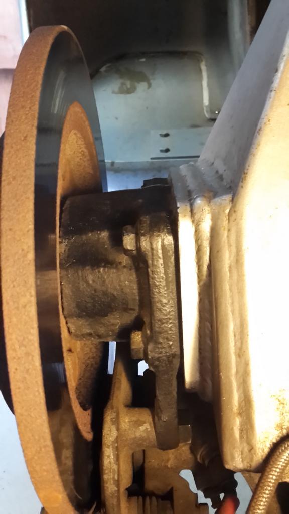

First step is identification of the brakes:
Front is clear = Ford Granada MK2
Rear not so clear to me should be MK3. Disc = 252mm and solid.
Can someone confirm these are Granada MK3? see picture + hub carrier dimensions:

Curt, you have an early GTD car with under slung rear brakes, these were changed by GTD quite early in its evolution to a different rear upright and bearing carriers with the cal operas mounted on the side. If the car is standard GTD, there are several good options of upgrade, but in my opinion this should commence by changing the pedal assembly to get a greater pedal ratio , this will be a much greater immediate benefit than just changing the brakes themselves. You will then need to consider changing the rear uprights ( and the fronts to do the job properly ) as the rear uprights you have will not carry the brakes you need. I use Tilton pedals , but others are available, with a pedal ratio of 6 to 1 ( standard GTD ratio is 3 to 1

A cheap and easy upgrade for the rear brakes on an older GTD are the use of the cosworth hub carriers, 273mm vented discs and calipers. The only machine work is the redrilling of the disc rotor to 5 stud.
http://www.ebay.co.uk/itm/2WD-BILLE...621659?hash=item1c583f351b:g:qOAAAOxyUfFTkYGb
http://www.ebay.co.uk/itm/Ford-Sier...557600?hash=item3f5296da20:g:mA4AAOSwMmBV3eBc
EBC Grooved Rear Vented Brake Discs Ford Sierra 2.0 Turbo Cosworth 4 x 4 (GD558) | eBay
These are two old rusty carriers just to demonstrate the extended lugs on the lower cosworth hub carrier.

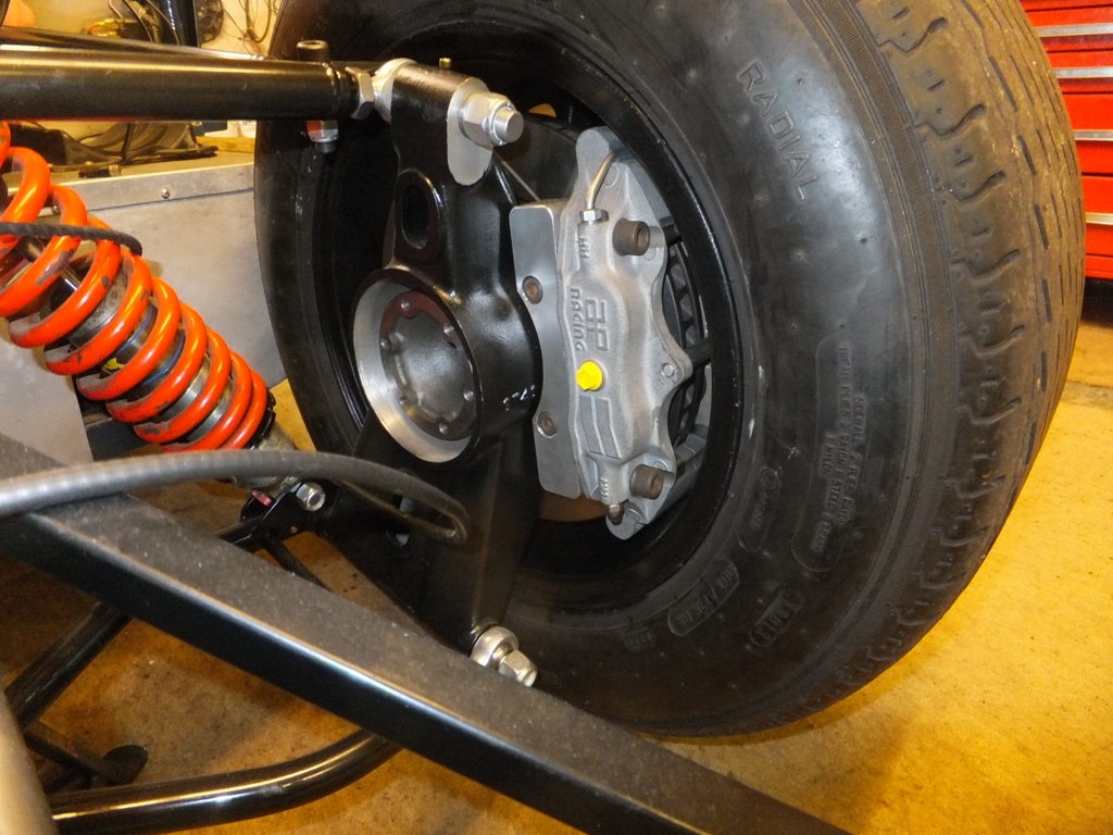

Curt, my car is a DAX but used same brakes as GTD. I upgraded fronts with Wilwood 4 pot and rear with HiSpec 4 pot. The rear was tricky to get right due to the space saving of the original 1 pot caliper, but I managed to squeeze in 310mm discs with Billet 4 caliper.
see threadRear solution

Your rear brakes are your weak point so at least change to the cosworth caliper scorpio disc at the rear then a 4 pot system up front will work with servos. It was a standard GTD supplied upgrade although used Alcon calipers up front. If you want 4 pots all round then you need to change your uprights.

The other upside of the cosworth setup is the hub itself, if you use the drive flange off the cosworth and the wheel hub plate of the granada you can upgrade the CV`s to 108mm cosworth units which are a fair bit tougher than the 100mm granada ones , you can then keep the wheel offsets and PCD. If you dont want to change bearing carriers you can get the granada scorpio vented disc which is the same smaller diameter but you will still need the Cosworth wider caliper. I am surprised no ones mentioned overbraking of the rears and brake biasing, its all about balance or the upgrades will get you nowhere.

@Dave, 310mm in the rear...woow, Hi-Spec proposed a 288mm disc and this this left me 4mm play. The 6 pot is the only kit R&R design supports at the moment, that’s meanly why I wanted to go that way. But indeed 4 pot is possible if you have the brackets...
My wheels are the old spun alloy 3 piece, so the rims are only 3/32" thick, I think that is where I have the advantage on rotor size. When I did this, there didn't seem to be any complete kits, so I took the measurements, and arrived at a solution using the Hispec caliper with handbrake, along with a 310mm Wilwood disc 160-5845/6 (I couldn't find a Hispec disc to fit), and a self designed caliper bracket I got a local machine shop to make for me. Lateral space is very tight so to get the correct offset, I used universal mounting bells machined to suit. The front discs were the Wilwood 160-7705/6 with Wilwood SL radial caliper 120-8070/1.
As Bob said front/rear balance is important, and as I was ditching my so far unreliable servos, the 6 pot piston area was too small and 4 pots gave much better balance / effort.
This all works well, and the only issue I have is trusting the hydraulic handbrake, I believe they do a mechanical version now, but I always leave the car in gear with a wheel chock if on a hill, so I'm happy with that.
