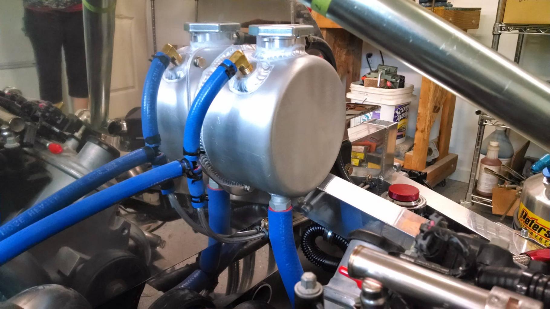

For clarity, for those that have the custom aluminum coolant tanks from the GB with Dave, the tanks were designed to run the 3/4" heater outlet on the engine to the 3/4" nipple on the tank. The 5/8" nipple on the tank could then be run back to the valve, or back to the 5/8" barb if you are not using a heater core.
With this design, no adapters are needed- in fact, that was the original intent of designing the tank that way. Doing the conversion at the tank is simple, and requires no adapters. But if you aren't doing the 3/4" to 5/8" conversion at the tank, you will need adaptation somewhere, as the rest of the heater circuit is 5/8".
But again, if you do have the tank, you don't need to, assuming you plumb the heater circuit as it was originally intended.

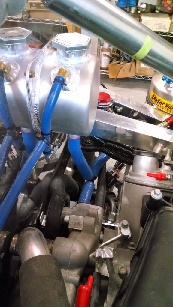

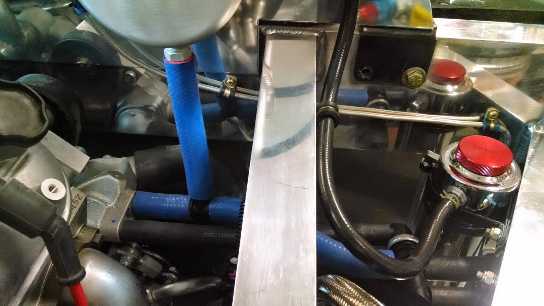

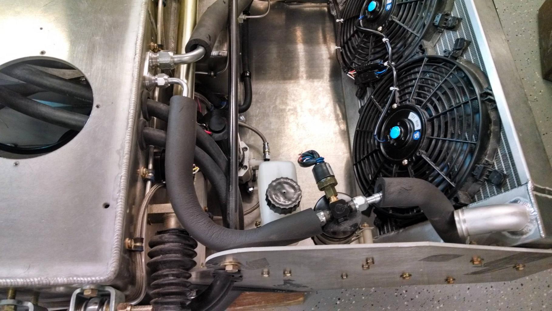

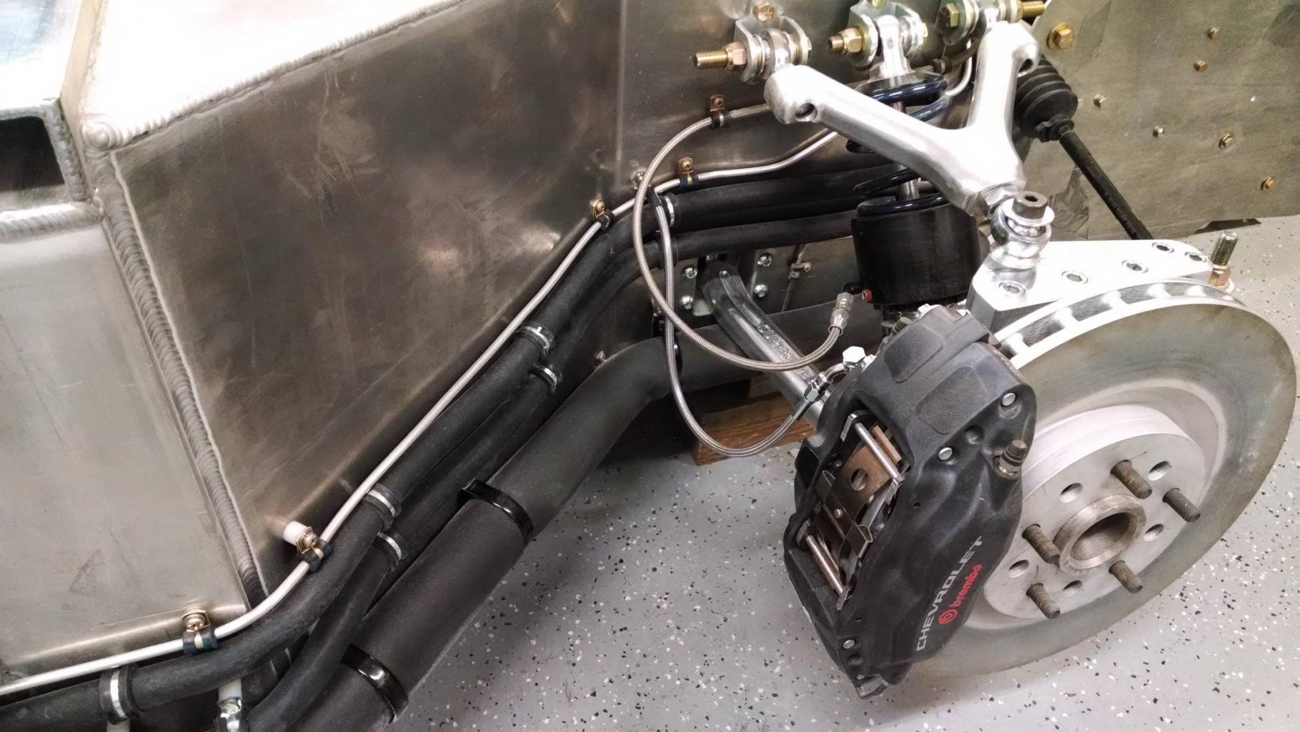

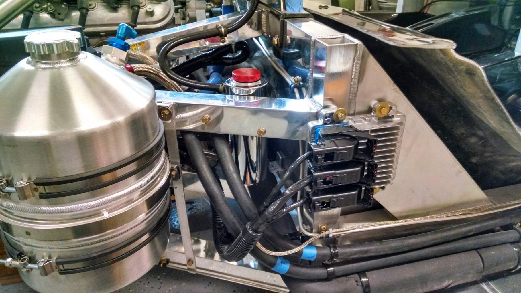

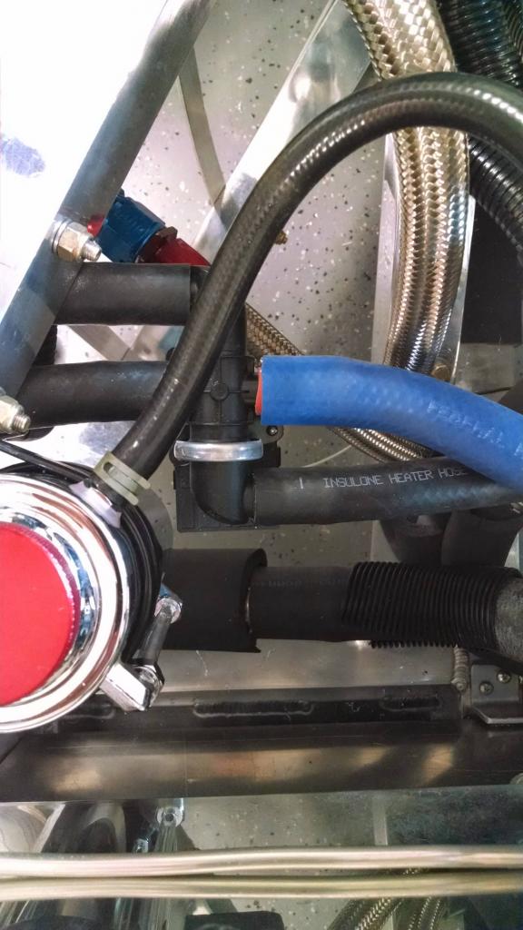

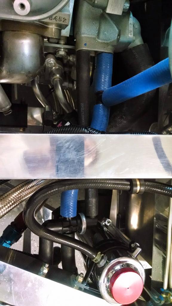

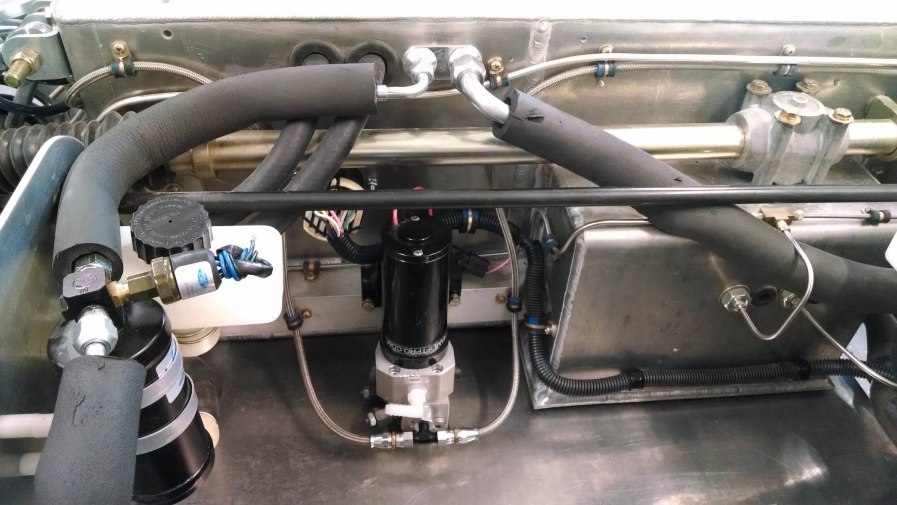

My 4-port valve came with what looks like a short length of thin wall rubber hose. It is designed to slip over one of the ports of the valve as an adapter so that the 3/4" ID hose will push over it and provide a snug fit.
For reference, here are some pictures of what my hose routing looks like with the adapter and LS engine. Many of the hoses don't have clamps on them yet.
