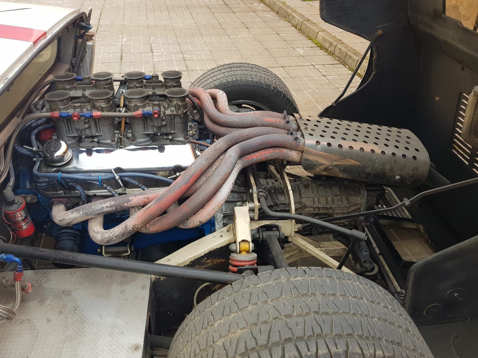

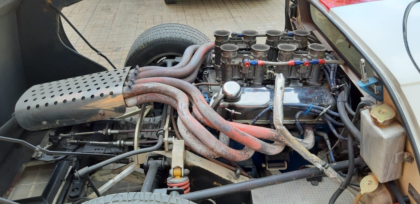

…and this is a Car offered to me as „1968 GT40 original from Ford“. What do you think?
Ian Anderson
GTD immediately came to mind.
Their original exhausts we’re as in those photos, not cross over, rear suspension and framework and the prominent ridge at the top of the door /roof section.
Mike Pass
Yes. GTD. The non crossover exhaust manifold is clearly GTD. The ridge at the rear of the top of the side window is also GTD. The BF Goodridge tyres were often fitted to GTDs back in the day (and are poor). The cable gearchange is also GTD.
The chassis number is stamped into the thick square tube above the steering rackon the right hand but side but it may well be covered by the aluminium panellling. GTDs sometimes have the chassis number stamped into the metal angle which carries the gearbox mounts at the very rear of the car ( mine does)
129.000€ for a „1968 GT40 original from Ford“ is extremly cheap and you should buy immediately ;)
However, 129K€ for a GTD in questionable condition.....:eek:
Anyway, I think sometimes it is a little more complicated - especially in countries where a registration is hard to obtain.
Some of the early cars are now 40 year old and changed owners several times. Sometimes the original owner dies and whoever is the the new owner very often has no f... glue what they are selling....
Don't get me wrong, I don't support people which advertise with false information and scumbags which do this on purpose is a different breed anyway.
Bottomline, for such cars the buyer needs to know, do his homework (thanks to GT40s.com :)) or bring somebody who knows.
I know the owner of the original GT40 p1083. Although this one really looks like the original, it is definitely not. I think GTD is probably correct. I have numerous photos of the original.

would be great of you can post photos of the back with engin and exhaust to Company! Thanks a lot!
