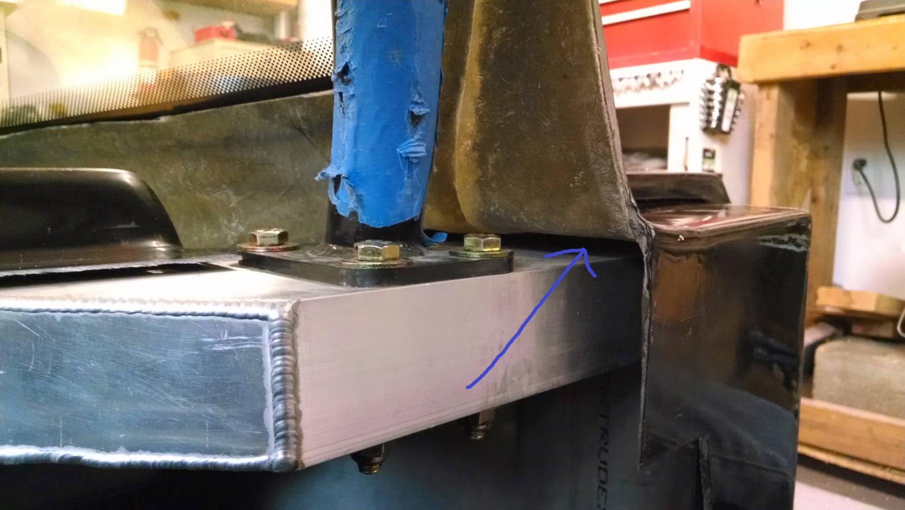

I would love to see some pictures of the "shims" under the a and b pillars. I think this is what I did but I'd still like to see pictures.

I'm not sure, but I think the position referenced in the prior posts is here (marked with arrow).
The picture is taken from the front passenger seat, looking at the front right rollbar (A pillar).

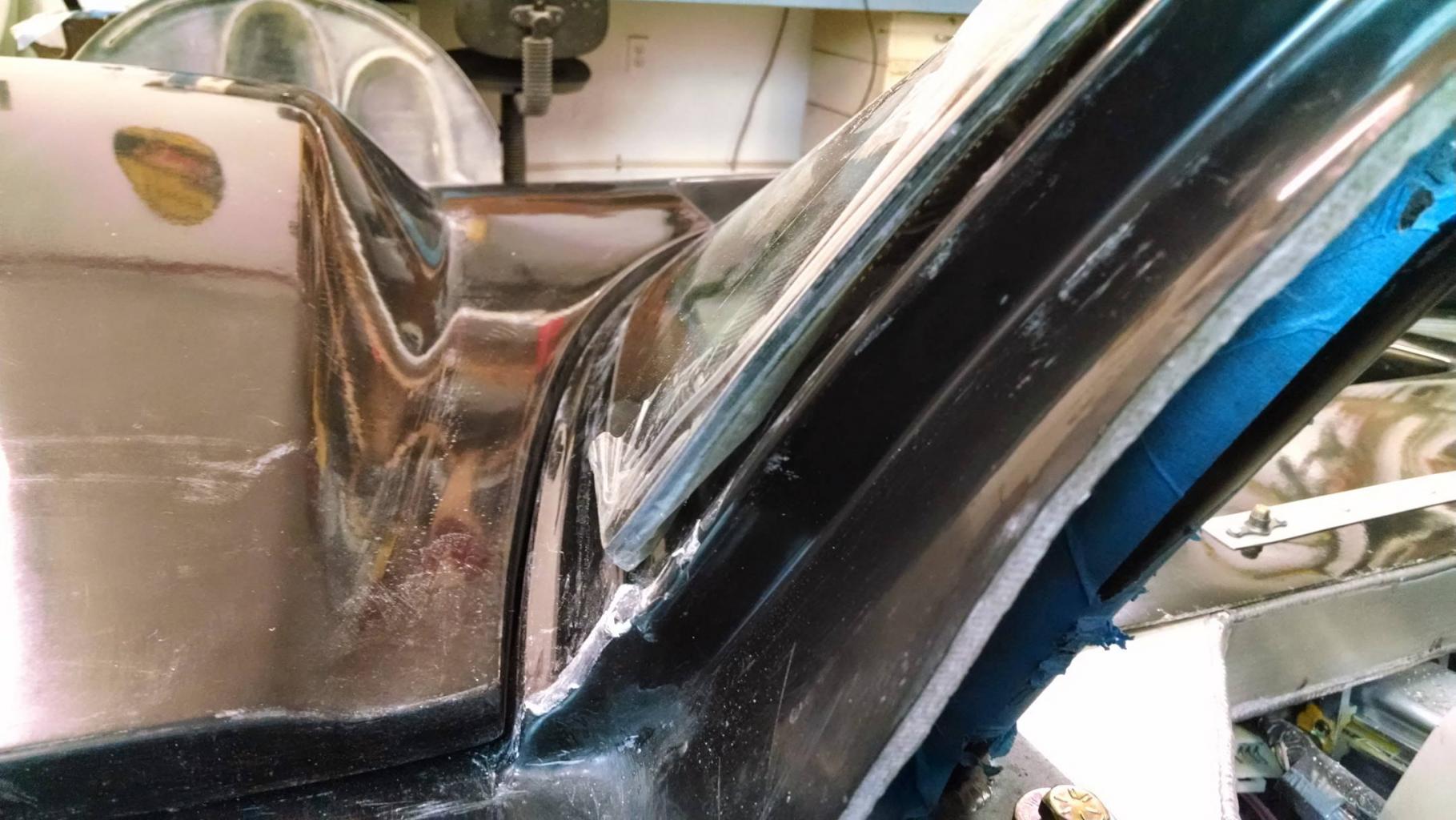

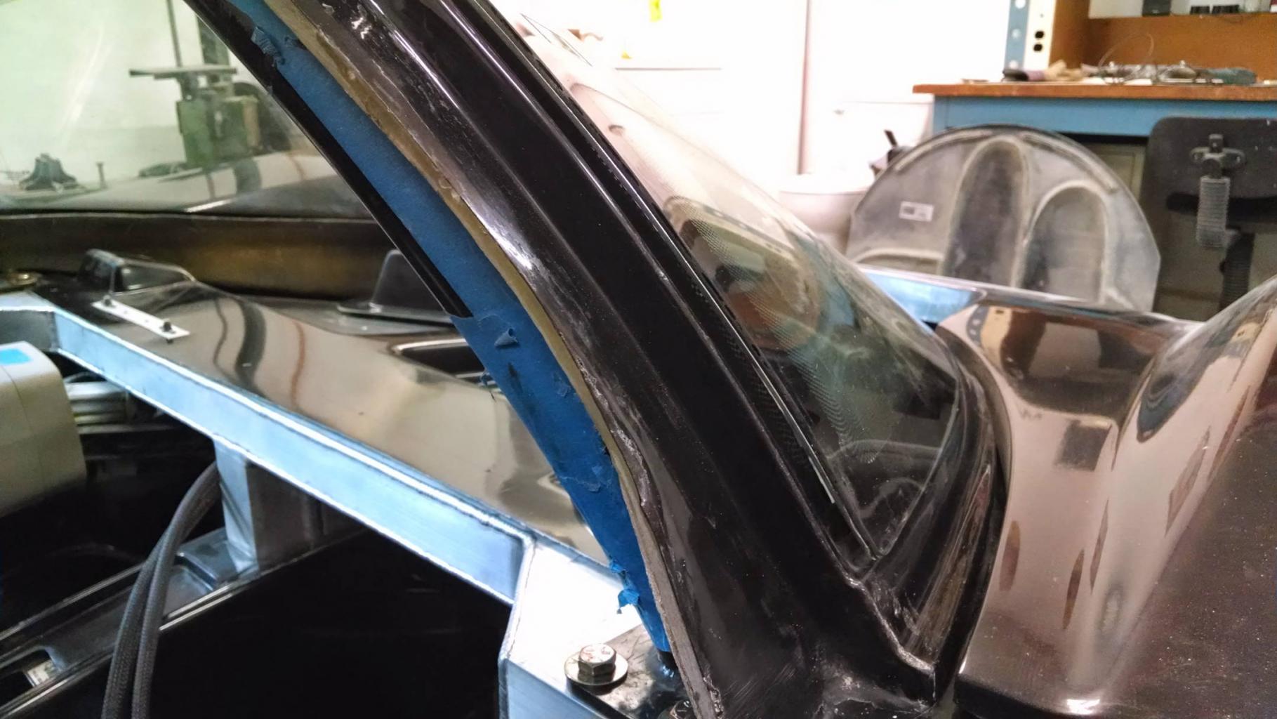

I am about to lock down the spider.
Before doing this, all the body panels and doors and windshield were set in place. In general, the fit of all the parts is really impressive.

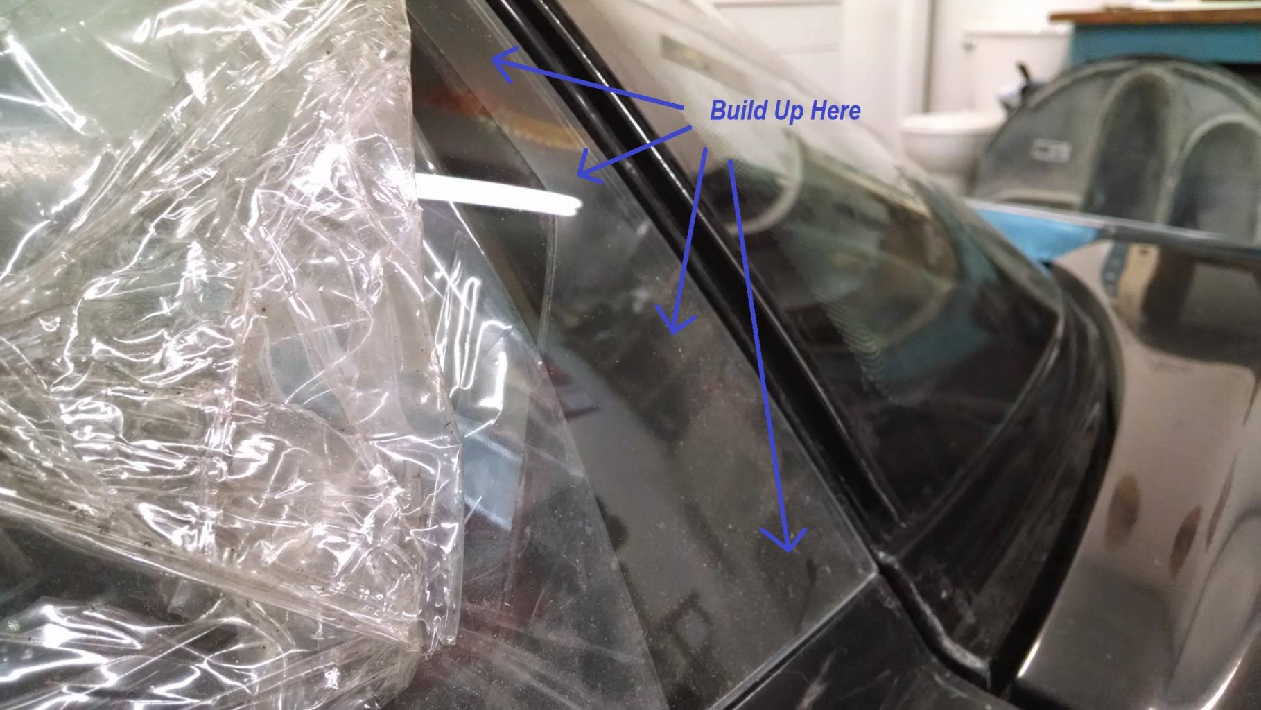

However, it looks like the lower corners of the windshield have a gap of slightly over 1/4". I have tried shimming between the roll bar and the body as well as between the body and the chassis in this area, but the window frame is very stiff (as you might expect, with such thick fiberglass in this area). While the windshield can be pressed down almost flush, I don't want to install it already stressed. I'm thinking that perhaps the best way to deal with it is just to install it as is allowing the windshield adhesive to take up the gap and then build up the front of the door frame so that visually it will appear to be in line with the curve of the windshield. The rest of the windshield rests pretty uniformly on the frame.
Any thoughts?

Dave:
Your windshield fit is spot on. Mine doesn't fit nearly as good and I spent a ton of time supporting the body as needed. You want a gap between the windshield and body for the adhesive. If you ever want to cut the windshield out your gonna want a gap.
Aaron

I have 1/4" spacers between the body and chassis near each A-pillar (the location in the above picture). I also have a 5/8" spacer under the bolt through the cupholder (behind the rear edge of the door) on the right side and a 3/4" spacer on the left.
Smaller spacers could probably be used at the rear with some more shaving of the body against the tub and interior firewall, but everything seems to fit well, and I need all the headroom I can get.
