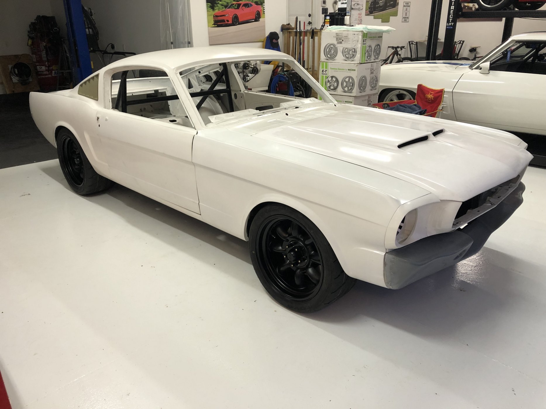

Gonna revisit this thread. My 66 GT350Rish build will hopefully be moving under its own power in a week or 2. After shaking it down and working out the bugs...body work this winter and paint next summer. I was shot down by Ford when my local dealer and I tried to get an allocation for a carbon fiber track pack GT500 (we had an allocation, but couldn't order the carbon pack). I'm on another list to order a C8 at MSRP this fall, but having second thoughts. I will be ready for another project by this time next summer (hopefully). I'm still looking at a Mrk1 GT build. Any more thoughts out there? RCR or AP would be the source for the build...unless I find an unfinished project out there.

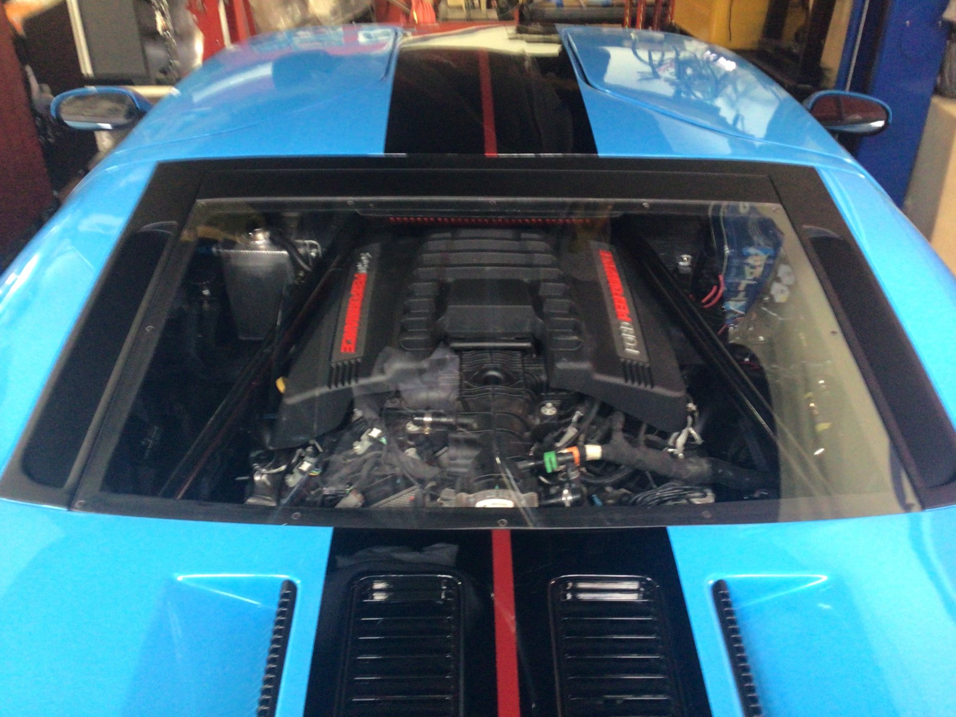

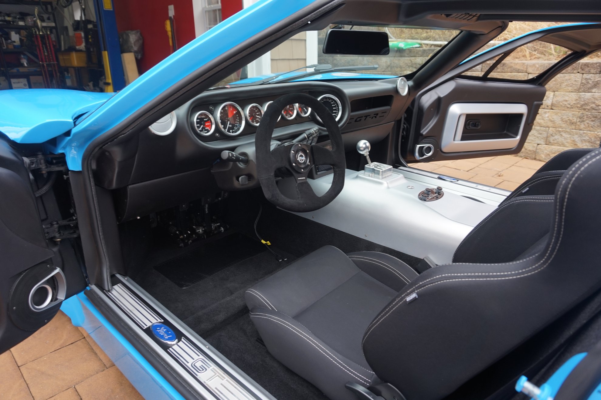

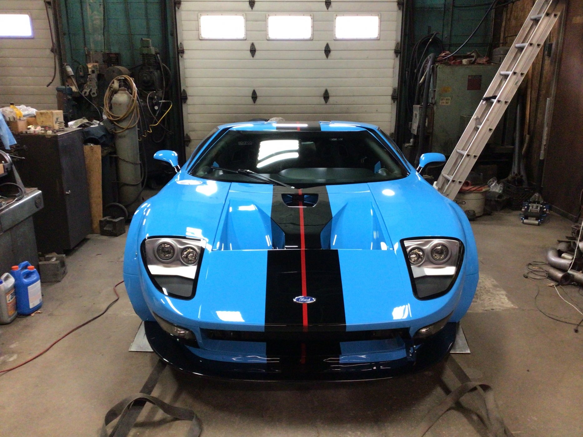

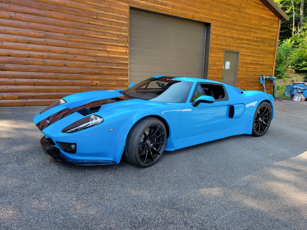

Joe I am like you I do everything but paint it just matters to your personal choice I just completed a GTR with the first Ecoboost motor very challenging build because no one has done the Ecoboost Gen 2 yet so noone to lean on by the looks of it you should be just fine with the RCR GT 40 the GTR has a lot more interior room
