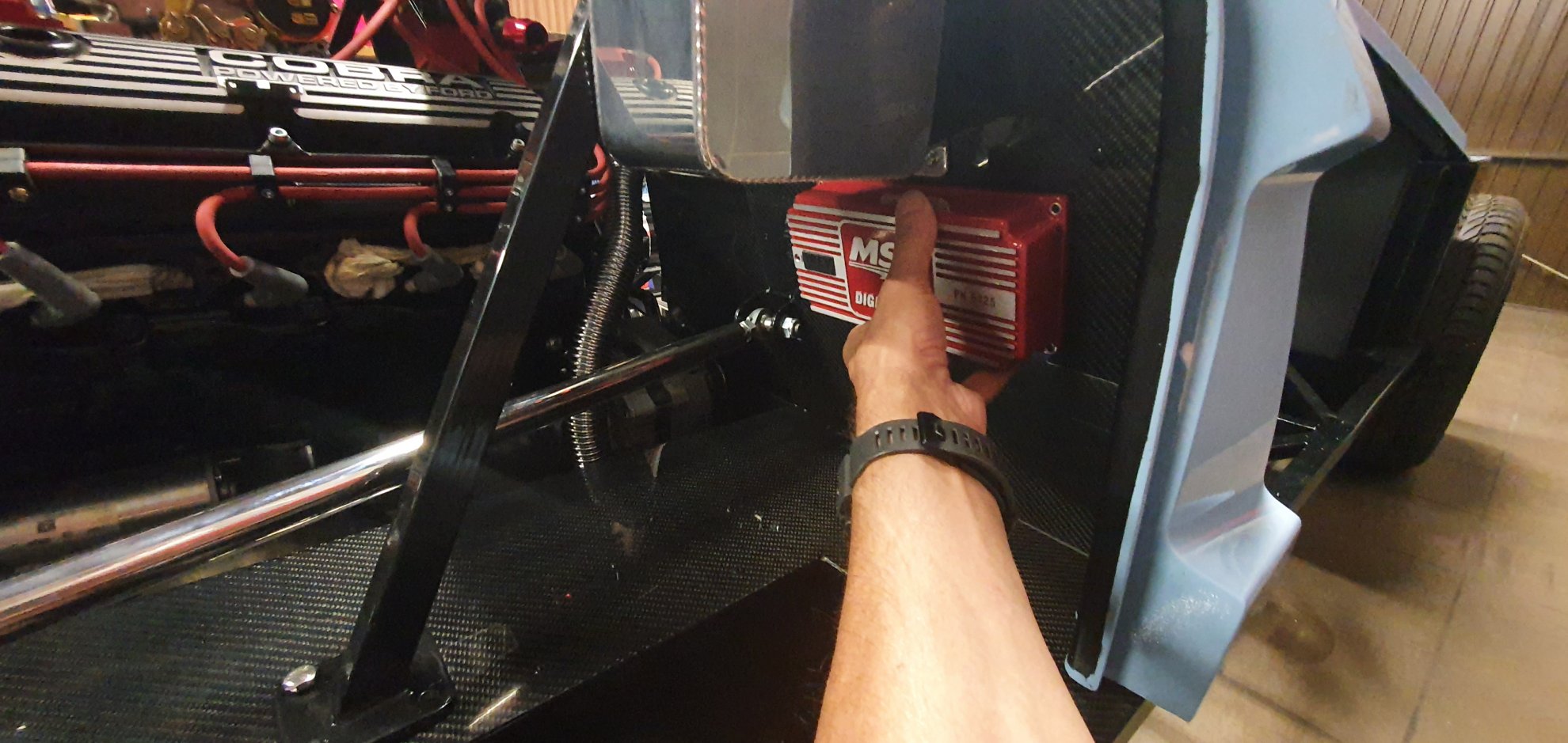

Hello. Where is the best place to install the ignition module so that water does not damage it?

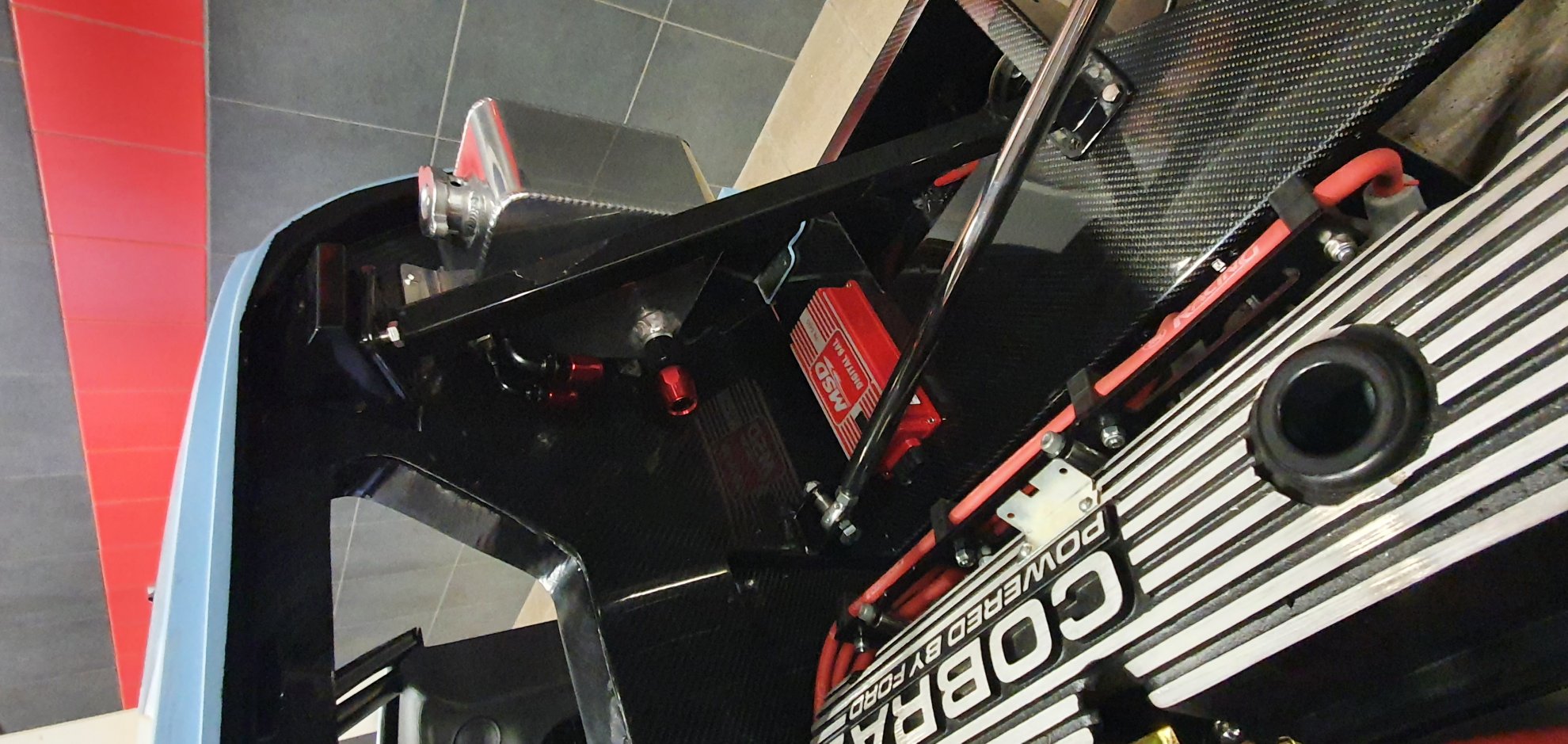

I think it can install on the bulkhead wall. Where is the driest place near the engine?
A dry spot in a GT40, did nobody told you you'll need a wetsuit when it rains..
Behind the front seat if you want to put it to the bulkhead.
Its also condensation that doesn't have to get trapped but needs an exit to get out. That MSD bottom plate is not sealed at all. Just rivited on four corners.
