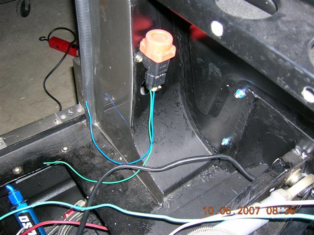

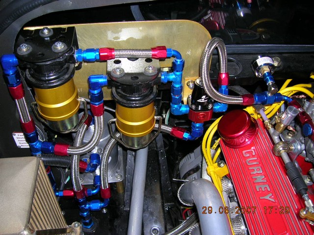

There are a number of possible locations to mount the switch. I chose to mount it on the driver’s side of the rear bulkhead just in front of where the fuel pumps mount. This location provides easy access and service. In this location, I have yet to have a false trip due to bumps etc with 1200 miles logged to date. What ever location you select, the switch MUST be located vertically on a solid panel as shown.

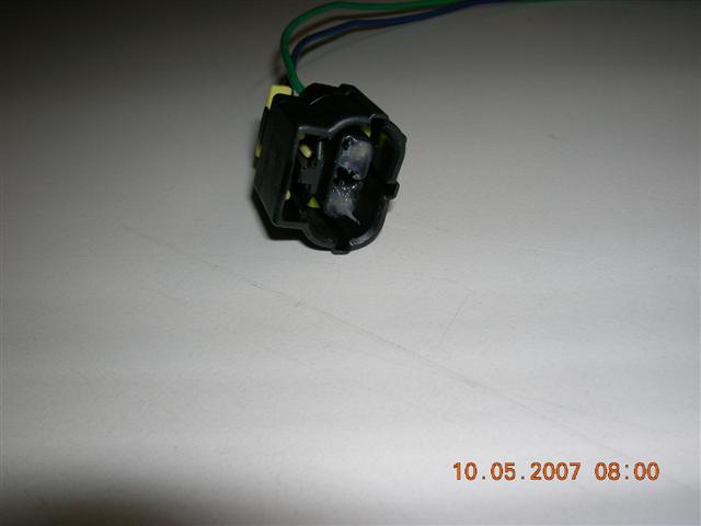

In the photos shown below, one can see that dielectric grease has been applied to the connector. This prevents corrosion of the contacts from water. Further details are found elsewhere on this site discussing techniques associated with electrical wiring and preventative measures.

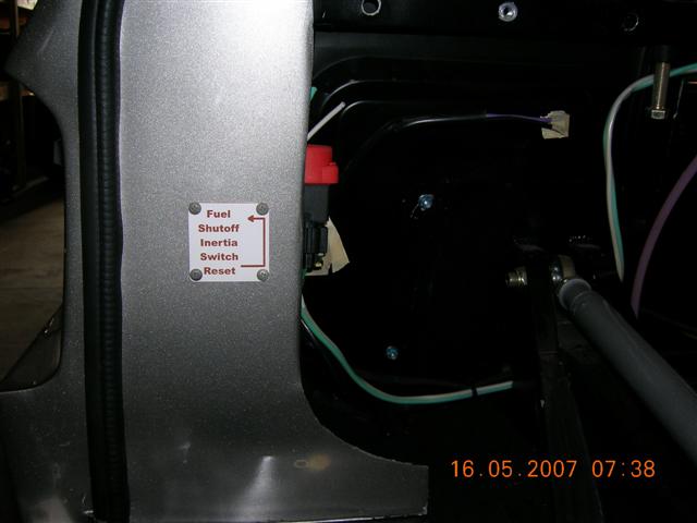

I made a label to indicate the location because the switch is not obvious when the pumps are installed.

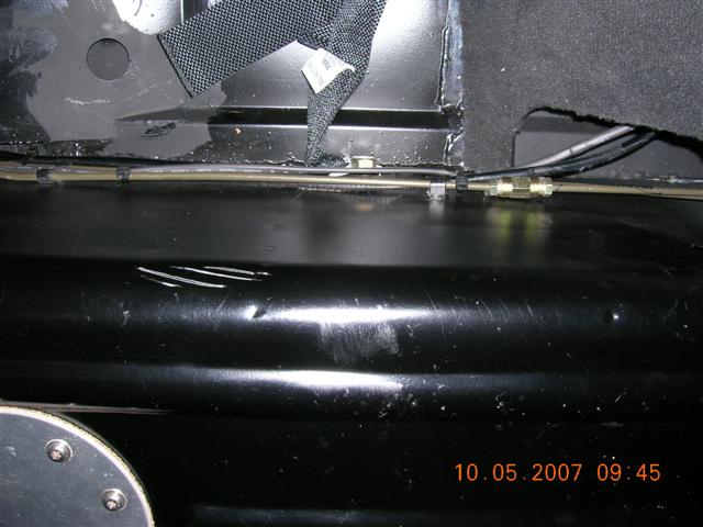

The wires could be connected to the pumps at this location but I prefer to run the wires to the source. This complicates things a bit but it is a technique I prefer from an engineering standpoint. Do as you feel appropriate. The wires were shrink tubed and run along the floor pan and wire tied to the brake line.

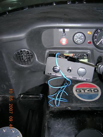

The wires are then run up under the dash and connected to the fuel pump switch.

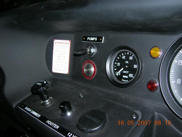

The supplied label is then placed to the left of the fuel pump switch as below. Make sure you reset the switch.
