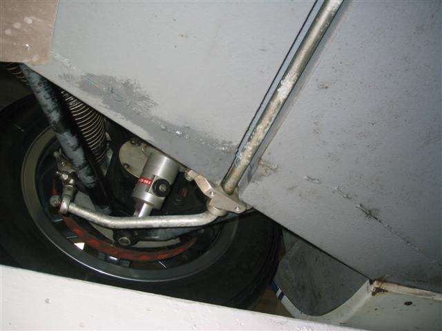

Ron McCall
Here you go.From the underside of GT40 # 1137
Ross Nicol
Do you reckon they might have been hiding it from the competition? very neat job checking it into the chassis like that.
Ross
Ross
Three other reasons that I can think of.
* Keeping weight low
* With a high steering rack, there might have been limited solid chassis area to bolt against
* Maximise the air-flow/clearance
It does look good though. :)

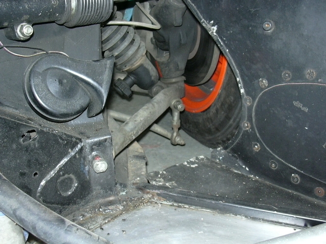

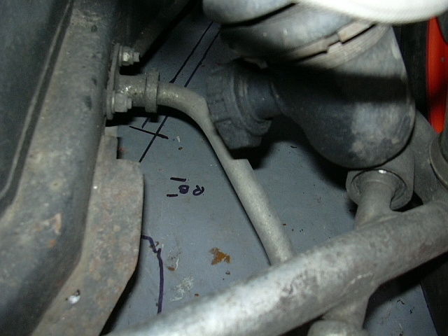

JimmyMac
Here's another original swaybar
