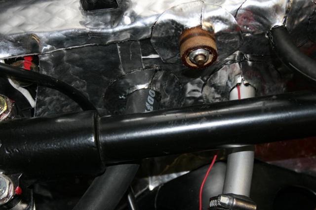

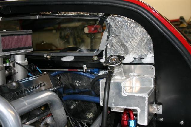

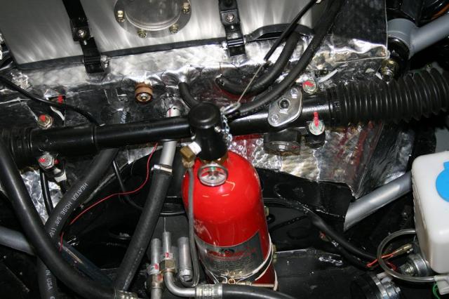

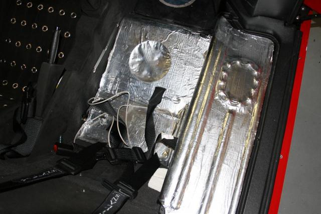

I wish I would have taken the temperature and DB before I did all this but still think it has helped a lot. These cars where never meant to be an NSX or Lexus but when your over 50 every little bit of comfort helps. In these pictures you will see a diamond looking aluminum (the insulation) which came from Summit Racing its very sharp and will cut like a razor so just heed my warning. The tin foil looking stuff is Dynamat and I really like it, it goes on pretty easy and does a great job, I even put it inside the doors and now when you shut the doors it even sounds some what like a normal door. I put the insulation on the front of the tub and plugged all the holes (all this was told to me by Mike T. long before) where the hoses and other items went through, this helped a GREAT deal and on the back of the cab and plugged all those holes, if you do anything at all this will make you happy. The Dynamat is sort of like a sticky tar and when you put it on I am not sure if you will get it off so be sure you can live with it, I have put it on the tub of the left front tire and plan on the right soon as time will allow.
Mike showed up this afternoon and we went for a spin, 90 outside and we were comfortable and didn't have to use to many hand signs.

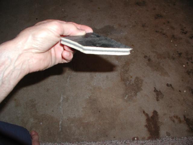

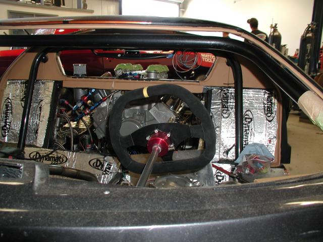

Dynamat has a sister product that works very well. Called Dynapad. It is about 1/2" thick with two foam layeers sandwiching a hard thick layer and is applied with a fabric adhesive. When used on top of the Dynamat, it kills noise and heat transfer even better. I have used it on my car and I am sure it will keep everything quiet. Particularly in the backing of the front wheel wells and the wall mounting the pedals. Road noise is very distracting. The trick is to make sure you cover all the holes. It will give the doors that solid sound when closing. Put it all over the inside of the door openings. Very important for those of you who want a decent sounding stereo. I know... I know.... The purr of the engine should be enough. But if you want to talk to the passenger, you got to quieten it down a notch. So cover everything on the inside with it. Even the surfaces you don't think will contribute much noise like the sill plates. The disadvantage is that these products are not light and add some weight to the car.
The ideal place for this stuff is in the engine bay. That is not an option for me, as I have a lot of stainless there and this stuff is not great to look at with all the advertising stamps on it. Put these products on the cabin side of "everything". It all will be hidden with the upholstery, not to mention it will give the guy a great surface to apply the fabric or leather. It is easy to cut and apply. All the pieces of the dynamat can be used to fill in. Be a little more careful with the Dynapad. Your upholsterer wants everything flat, smooth and to the edge. I only have one pic of the dynamat and have included it. Will get some more when I visit the car later today.
